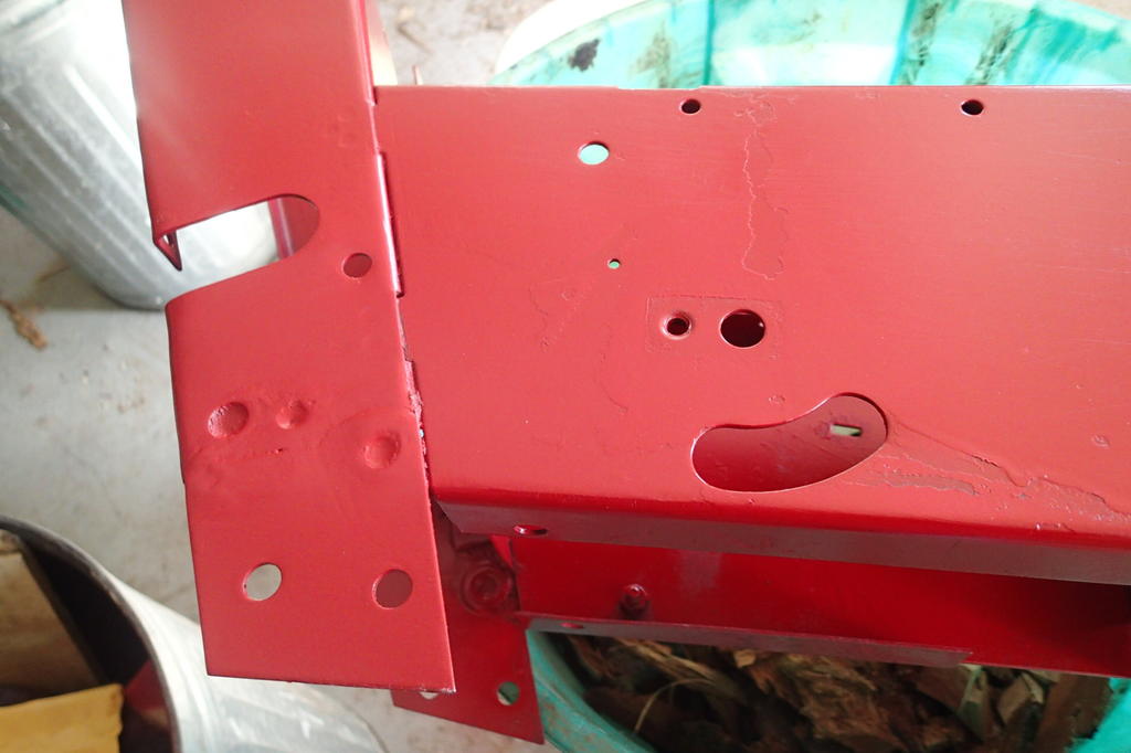

Racinbob 13,111 #26 Posted October 8, 2019 I bought this 1976 new and used it with a blower and tiller a lot. The tower developed a crack I'm guessing in the 80's. I attributed it to not using the spring assist which put more stress on it. Not having a welder and wanting to try to keep it from getting worse you can see the plate I added. I only primed it and never got around to throwing some red paint on it. That was one of the first things that caught my eye when I was reunited with the tractor after 17 years apart. Exactly as I did it 30+ years ago, still doing it's job and no, it's not getting red paint now. 2 2 Share this post Link to post Share on other sites

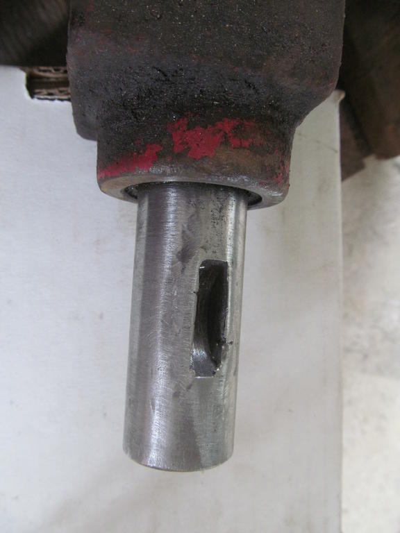

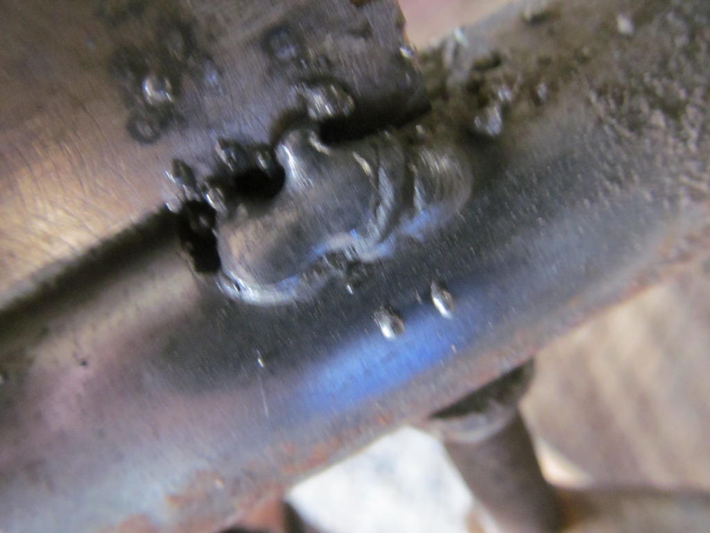

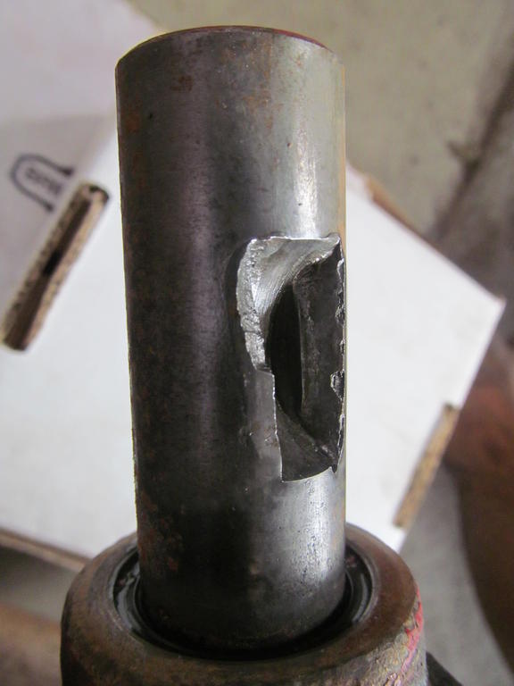

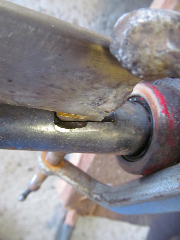

Ed Kennell 46,996 #30 Posted October 8, 2019 9 hours ago, OILUJ52 said: You may want to look at ED's keyway repair thread, it's pretty good. I couldn't locate the keyway fix post Joe. Maybe one of the Geeks can find it. I do still have a few photos. Before The dummy brass key Welding around the key After clean up and fitting to the hub. The seal and bearing were kept cool with wet rags during the welding. 1 Share this post Link to post Share on other sites
WHX?? 57,810 #31 Posted October 8, 2019 I can't find it either Ed, thought maybe it got moved to instructionals? ... where did you score the brass key? Share this post Link to post Share on other sites
Ed Kennell 46,996 #32 Posted October 8, 2019 Dunno where the thread went Jim. The brass key was made from a brass model hydro turbine wicket gate. Next question...what's a wicket gate? Share this post Link to post Share on other sites
DeD 20 #33 Posted October 9, 2019 I've decided to mill the key out to accept a regular 1/4 key that I'll make about 2 1/4 inches long. I'll make a new pocket on the opposite side of the woodruff key and make it so that it can't slide out front or back. Like I said, I'm more skilled with a mill than a welder plus I have a mill but no welder. 4 1 Share this post Link to post Share on other sites

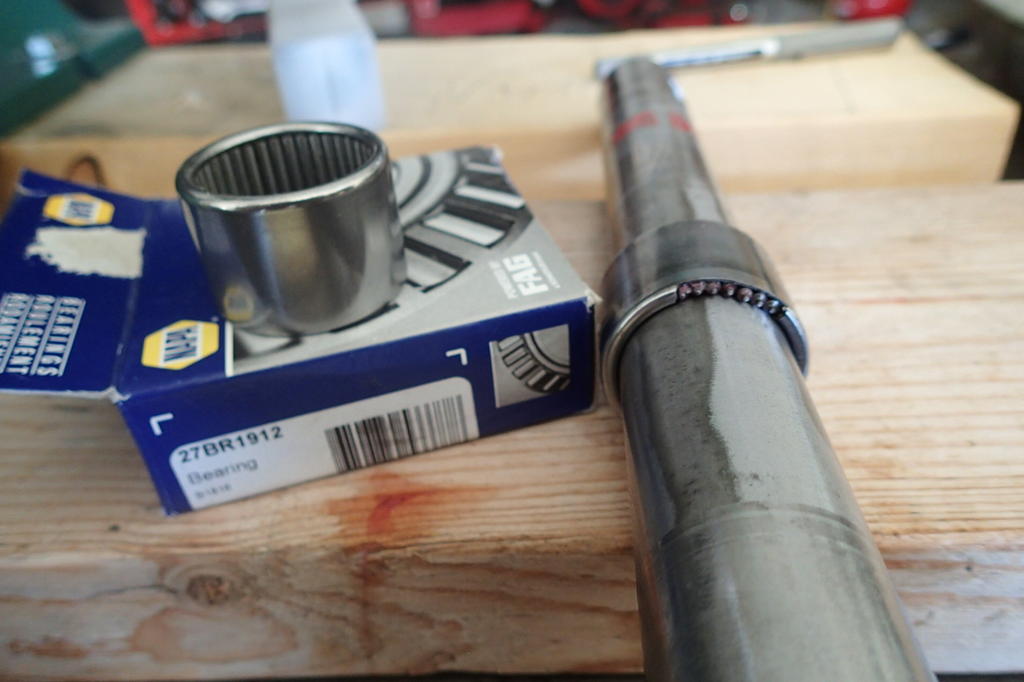

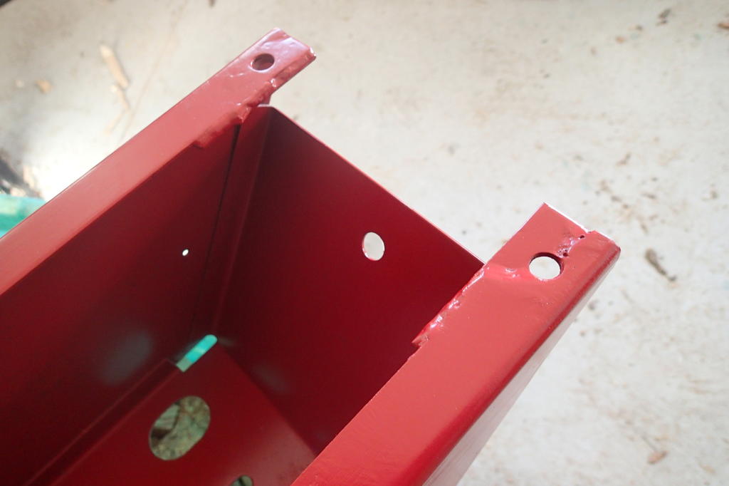

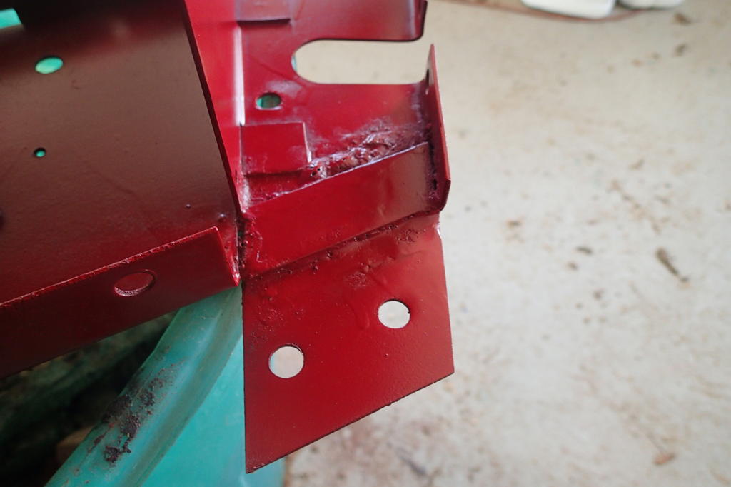

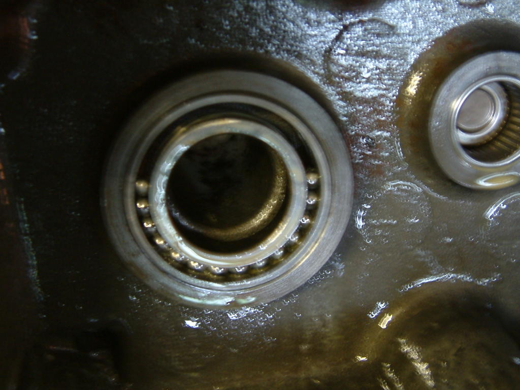

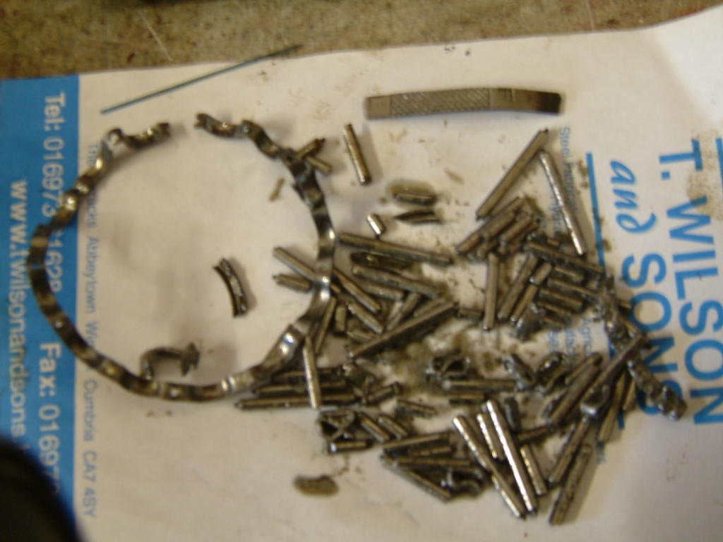

DeD 20 #34 Posted October 23, 2019 I took the entire hood stand off and repaired it. I silver soldered some reinforcement plates ii where needed. I also found the right side of the hood stand had a crack starting in it so I patched that too. I surprisingly had some red paint around so I slapped some on it just for rust prevention. I also found that one of the roller bearings for the axle had a broken shell. The needles could of escaped out of the side and into the differential. I got it from NAPA, you can see the part number. I'm waiting on some other stuff then I'll finish milling up the axles and start ass'y. 3 Share this post Link to post Share on other sites
Stormin 9,988 #35 Posted October 24, 2019 (edited) 16 hours ago, DeD said: I also found that one of the roller bearings for the axle had a broken shell. The needles could of escaped out of the side and into the differential. Hopefully all the needles are still there. That had happened with my C-121 (The Black Horse) when I got it. The needles had gone through the case ball bearing and wrecked that. Drain the trans and see what comes out. There was even the end off the dipstick in there. Edited October 24, 2019 by Stormin 1 Share this post Link to post Share on other sites
