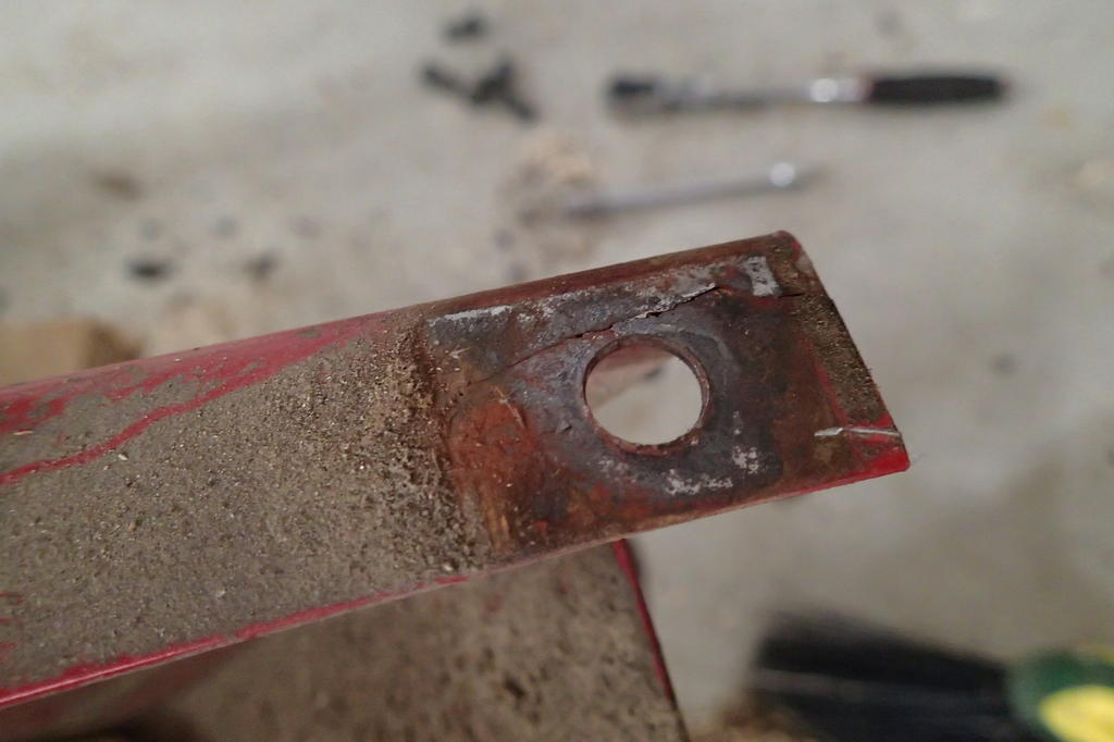

DeD 20 #10 Posted October 7, 2019 Thanks all. I guess mine is a '75 its got a hood ornament, if you call this a hood ornament. Here is a close up of the model and serial numbers, hard to see but the last digit really looks like a "T". Of course the workers could of lost the "1" and used a "T" instead, not the first time that's sort of thing has happened. I also have some sheet metal work to repair the frame is cracked thru and the rear mounts for the seat are bad. one is completely cracked off and the other one has a crack that maybe hard to see but its on its way. Lucky I caught these cracks otherwise the seat would of broken off and I'd land on my back somewhere with the tractor racing off in the woods. 1 Share this post Link to post Share on other sites

WHX?? 57,470 #20 Posted October 8, 2019 (edited) DeD That split in the hood stand is very common with us. Truth be told I've never see one separated tho but I've always caught them and repaired long before it came to that. When I rub down my horses I always look for an issue in that area. We always supected if was from a deck hanging off that side but???? I guess is what I am saying is you should be looking for troubles before they start and it sounds like this one got away on you abit so your own fault. In as much as our horses are pretty tough tractors they still need maintenance. I think you may have an @$$ chewing coming guy for riding her hard and putting her away wet guy! As far as parts yes EB is right for once in his life.. if you can't find parts you ain't lookin. I found RS here a couple of years ago in a search for tractor parts for a very homely and needing 1067 way older than yours and ended up up with with more models than I can even show love for. Thanks to RS and perseverance I hit more than a few home balls. Sorry no 118 hubs on hand..... looking for a few my self ... a few 1 inches on hand tho. I can also do custom hub reworking if needed and they are saveable. Edited October 8, 2019 by WHX24 2 Share this post Link to post Share on other sites

JCM 11,260 #23 Posted October 8, 2019 I also had the split on my 77 C-120-8 at the same location on the bottom of the hoodstand and had a friend of mine weld it, this tractor was used with a tiller for many years and I was thinking this may have been the cause of that issue ? 1 Share this post Link to post Share on other sites
