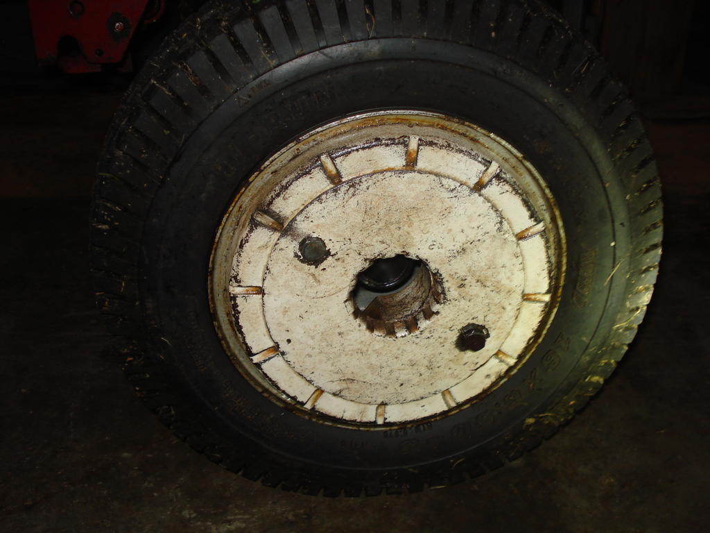

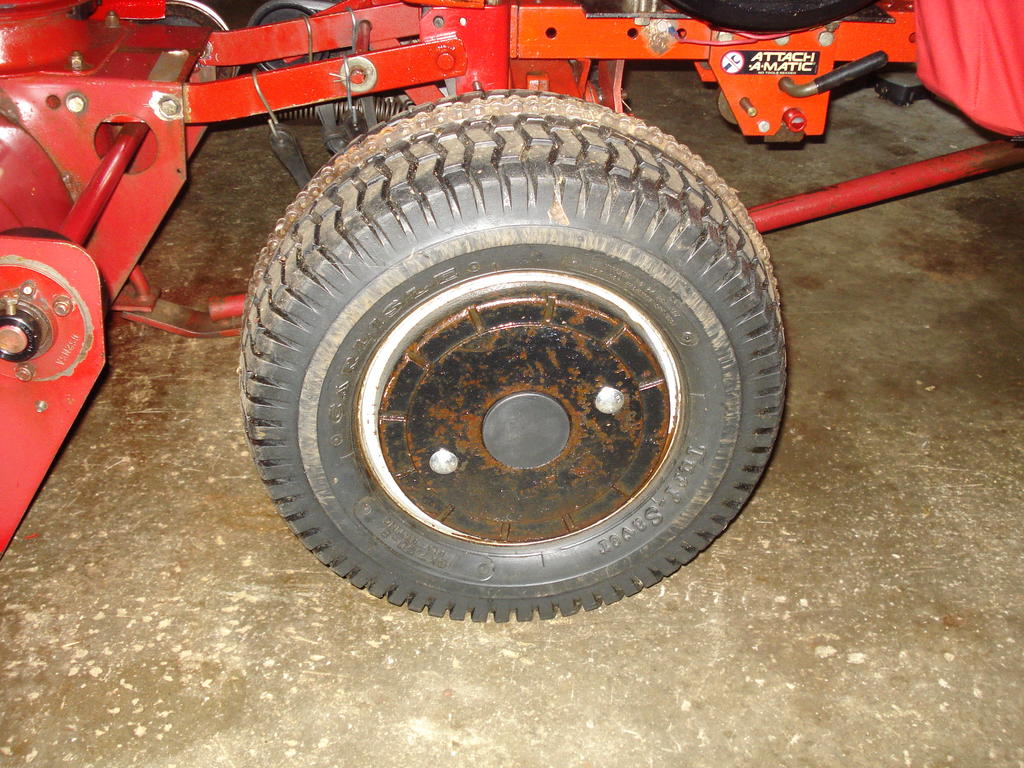

76c12091520h 4,292 #1 Posted October 7, 2019 (edited) Still going thru our extensive stash, I'm 99% sure but can anyone confirm - are these genuine Wheel Horse ? Edited October 7, 2019 by 76c12091520h 3 1 Share this post Link to post Share on other sites
Sparky-(Admin) 26,693 #2 Posted October 7, 2019 Yep, those are the real deal. 2 Share this post Link to post Share on other sites
squonk 48,337 #3 Posted October 7, 2019 Weights made by outside source but yes it's what WH spec'd and sold 1 Share this post Link to post Share on other sites

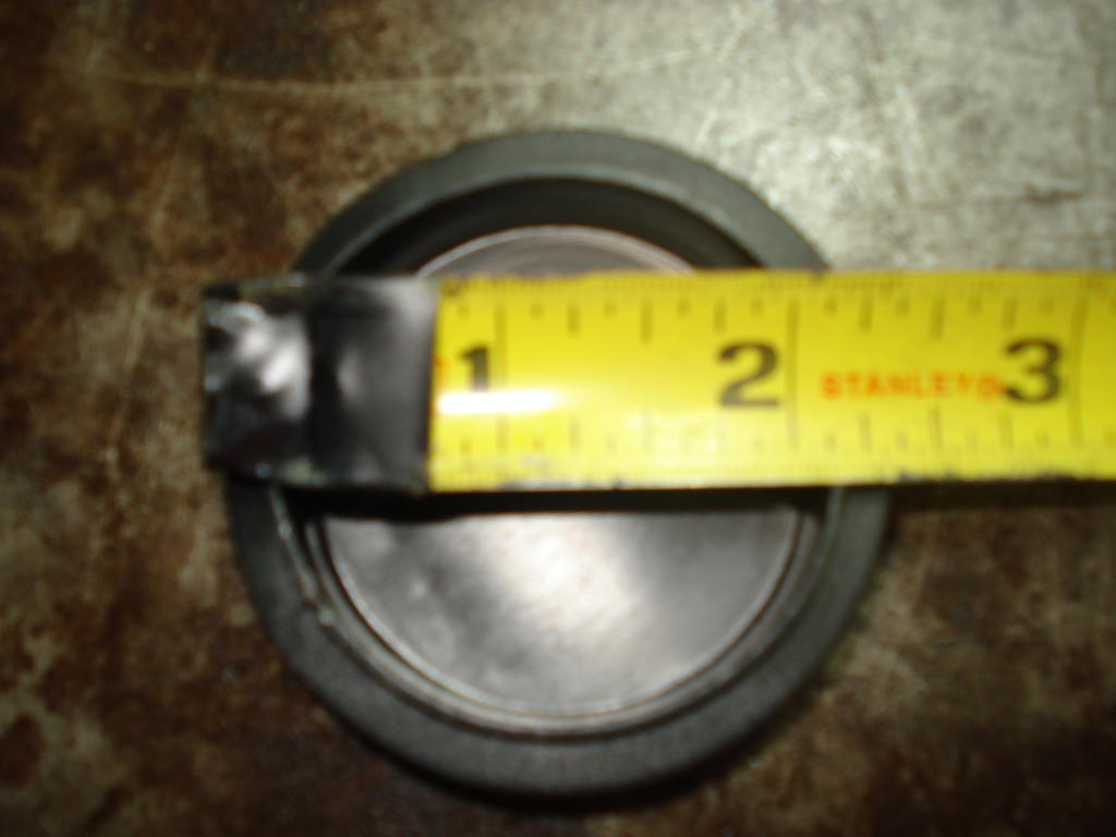

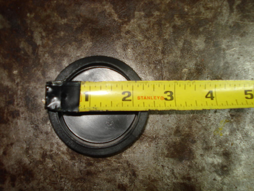

AMC RULES 37,260 #4 Posted October 7, 2019 Can we talk about the center hub hole in them? If I remember correctly, some of them are sized differently. Share this post Link to post Share on other sites

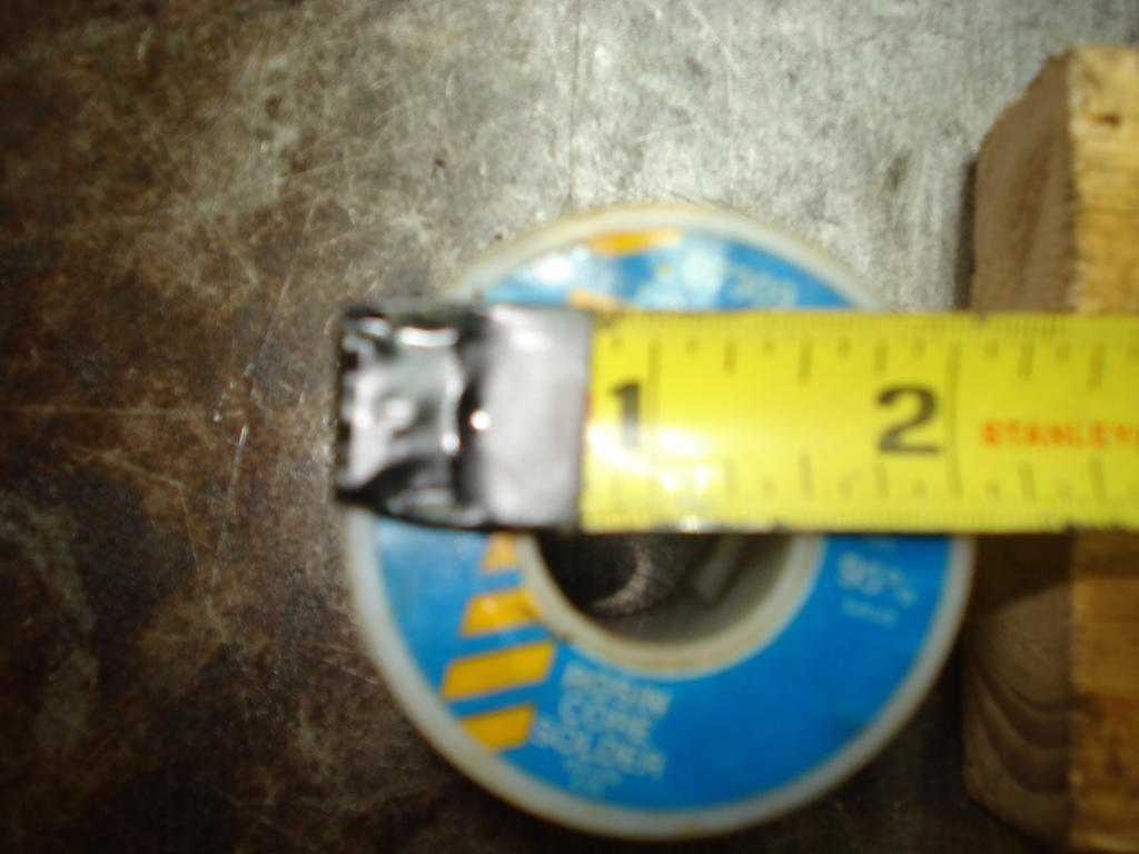

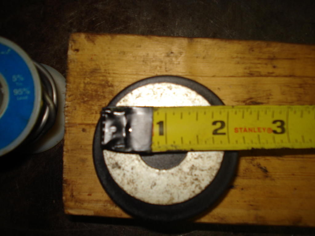

1995 520H+96+97 939 #5 Posted October 7, 2019 Black wheel weight,1996 520H , swept front axle(1" wheel bearings). Black plastic plug fits. White wheel weight, 1988 520H, straight front axle(bushings in wheels). Soldering spool is tight in hole, flat washer is loose. 1 Share this post Link to post Share on other sites
