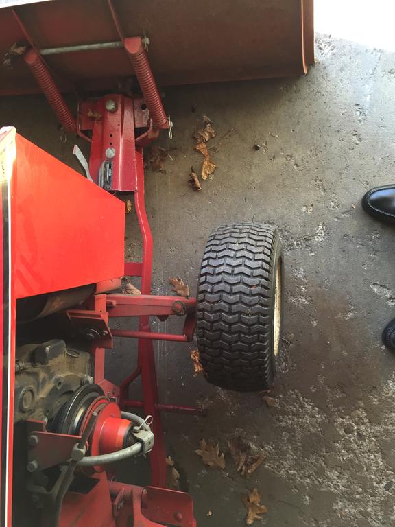

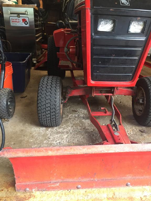

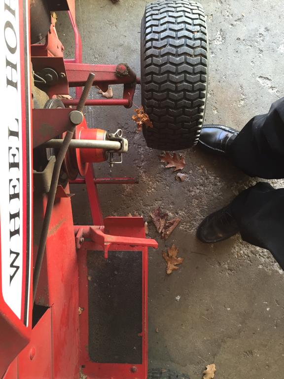

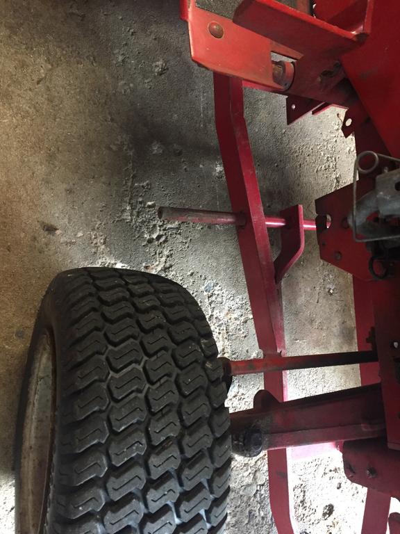

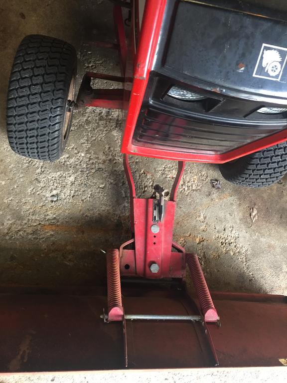

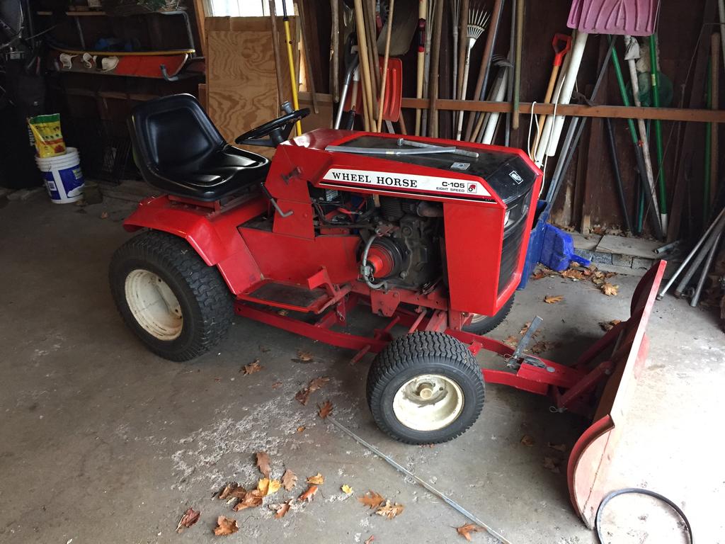

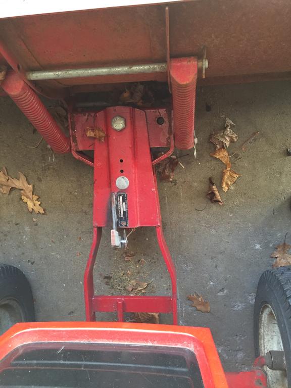

SylvanLakeWH 32,703 #1 Posted October 6, 2019 Good Morning! I have a previous owner modified front blade on my C-105. I need to get off the tractor each time to adjust angle. Not a big deal as I have a route that I follow so I adjust minimally each time I plow snow, but I would like to fix so I can adjust from the seat. Any pics of the handle, adjustment rod and cable controls would be most appreciated, as I wish to fabricate a solution. As this appears to not be the “correct” plow for this tractor based on modifications, the PTO and brake pedal will be space obstacles... Thanks in advance for your thoughts and input. Share this post Link to post Share on other sites

953 nut 69,827 #3 Posted October 6, 2019 Jim, you could probably get the whole shebang from Lincoln at A-Z Tractor, https://a-ztractor.com/. The arm has a cable (or small rod) and pivot point on it that pulls a second cable that pulls the pin for you. The arm also has a heavier rod (3/8") that pushes or pulls the blade in the direction you need it to go. I grabbed this photo from our classifieds. 1 Share this post Link to post Share on other sites
