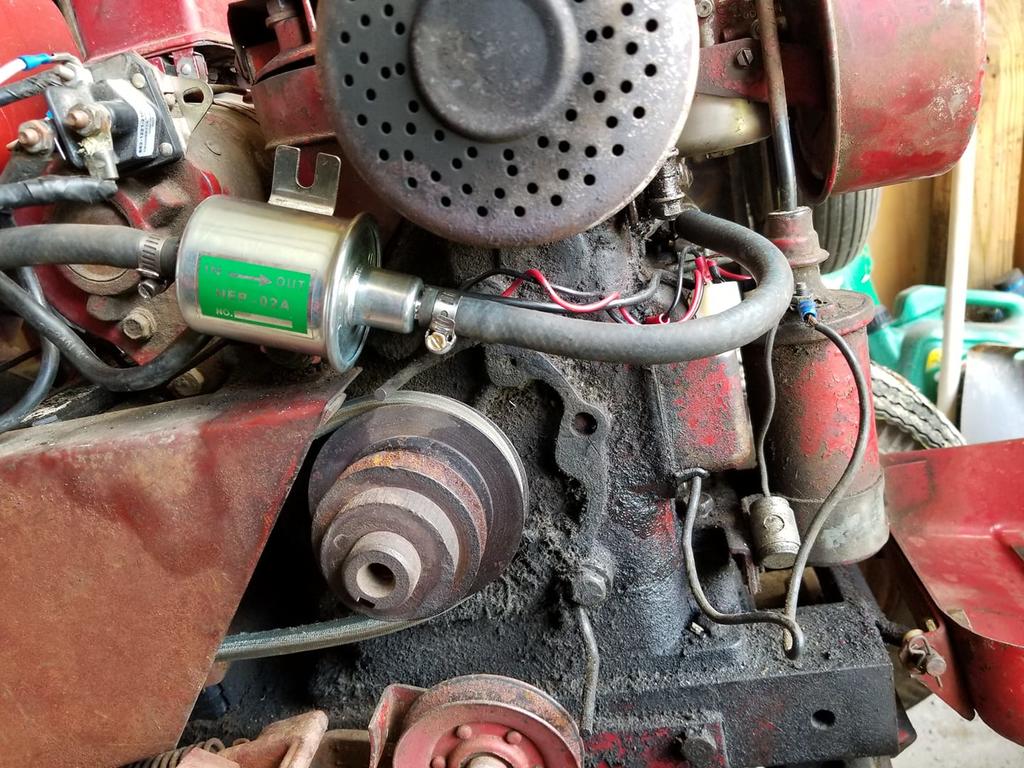

cafoose 3,863 #1 Posted October 6, 2019 My 876 would not start after I installed the new fuel tank last weekend. I replaced the fuel lines and disassembled, cleaned, and reassembled the fuel pump. I was surprised to see it had a vacuum operated fuel pump Still no start. Took the fuel line off the carburetor and hardly any fuel was pumping out. I got a new electric fuel pump off and installed that and now it runs better than ever! 2 1 Share this post Link to post Share on other sites

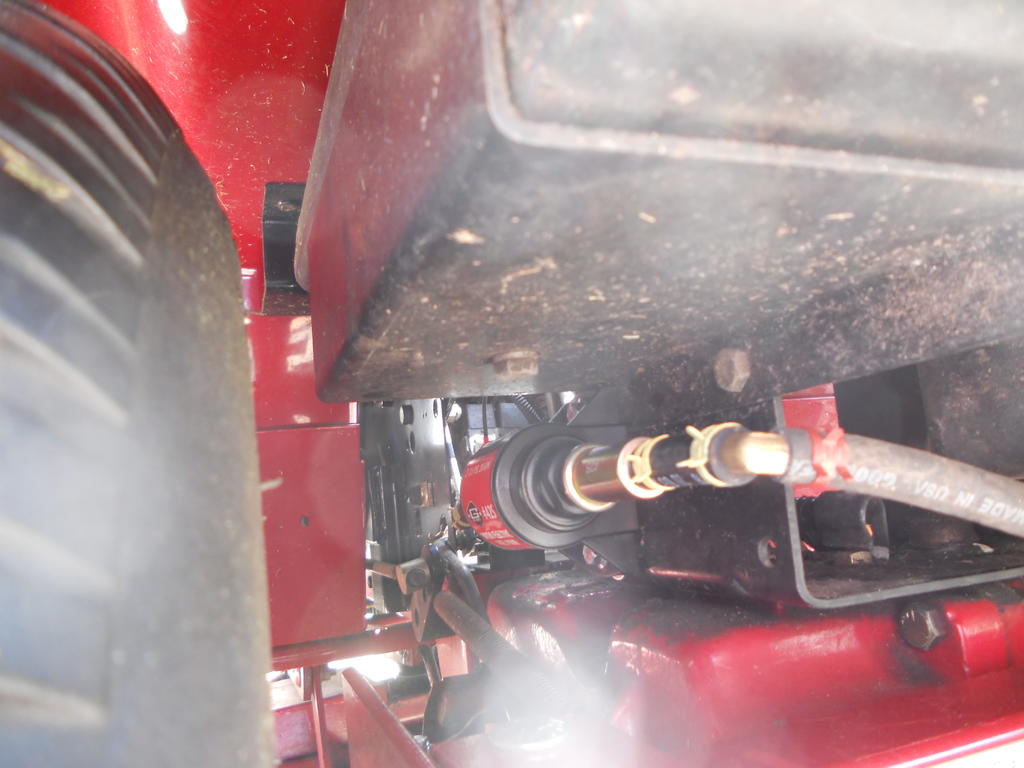

Racinbob 13,200 #5 Posted October 6, 2019 Here's where I mounted mine. Low, out of the way and switched power was already back there. No more excessive cranking. 1 Share this post Link to post Share on other sites
