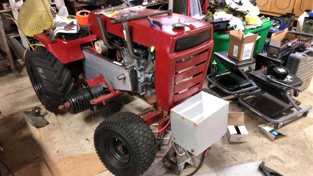

Sarthurs01 1,089 #18 Posted January 29, 2020 Here’s my progress so far. Have the tank mounted fuel line ran, belt on and just about to run wires from the battery back to the motor. Hoping to fire it up this weekend! 2 1 Share this post Link to post Share on other sites

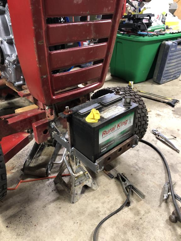

fast88pu 3,402 #21 Posted February 2, 2020 On January 29, 2020 at 8:26 AM, Sarthurs01 said: Here’s my progress so far. Have the tank mounted fuel line ran, belt on and just about to run wires from the battery back to the motor. Hoping to fire it up this weekend! If you are pulling with it most clubs will want the battery mounted in a box. You could use a tank under the fender and put battery under hood is an idea. 1 Share this post Link to post Share on other sites
Sarthurs01 1,089 #22 Posted February 2, 2020 5 minutes ago, fast88pu said: If you are pulling with it most clubs will want the battery mounted in a box. You could use a tank under the fender and put battery under hood is an idea. There’s nothing in our clubs rules but I thought about other places so I’m placing on making a cover to go over it for that purpose and look cleaner too. Share this post Link to post Share on other sites
fast88pu 3,402 #23 Posted February 2, 2020 28 minutes ago, Sarthurs01 said: There’s nothing in our clubs rules but I thought about other places so I’m placing on making a cover to go over it for that purpose and look cleaner too. Could use a boat battery box 3 Share this post Link to post Share on other sites

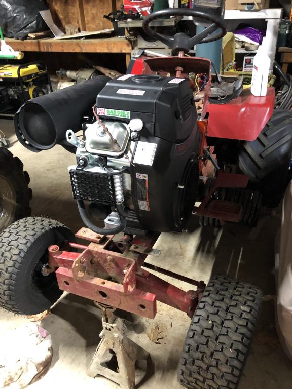

Sarthurs01 1,089 #24 Posted February 16, 2020 Little bit more done this weekend 1 2 Share this post Link to post Share on other sites
