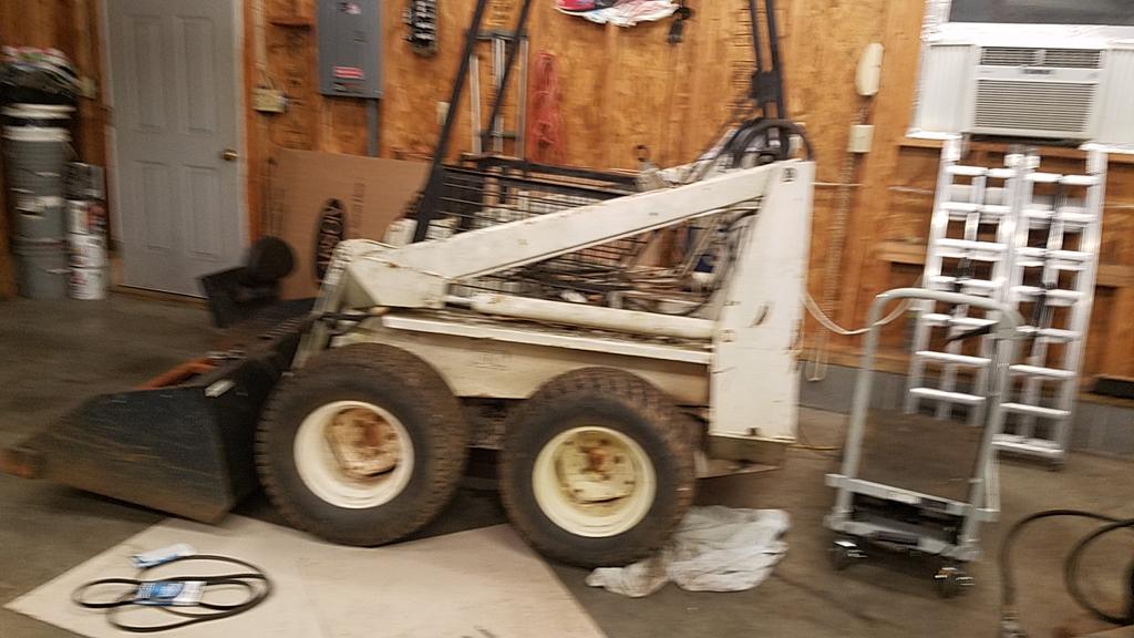

oldredrider 2,554 #3 Posted October 4, 2019 Just finished resurrecting a Bobcat mini skid steer. Quite a hefty piece of machinery. 500# weight limit in the bucket. This Bobcat weighs 1900#. Might give some of you a perspective. 1 Share this post Link to post Share on other sites

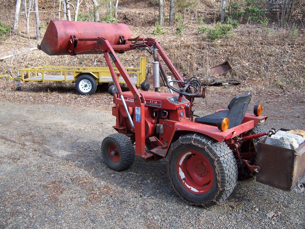

JoeM 10,317 #4 Posted October 4, 2019 I have two FEL's on 520H frames. just under 400 on one, 325 on the other and both have an additional 125 in the wheel weights. Been running them a couple years.....no issues. Two things that will get you in trouble is working on a hill, and having the relief valve set to high. I like to stack concrete blocks in the bucket and set it to relieve at about 12 blocks. The back yard is a 17 percent slope and I have come down it with a load of rock in the bucket and had the rear wheel loose traction. When I am not sure, I will back down the hill and always ready to drag the bucket. 1 2 Share this post Link to post Share on other sites

953 nut 69,827 #9 Posted October 4, 2019 9 hours ago, ZXT said: FEL's can handle 600+ lbs., but I can't see the front spindles handling that in addition to the weight of the tractor. I think the bearings can handle it if in good shape and well greased, but I think other components would need to be beefed up. Counter weights at the rear of the tractor will reduce the weight applied to the front spindles, my home made weight box is probably no more than 250 pounds, but the steering effort is greatly reduced. 2 1 2 1 Share this post Link to post Share on other sites
