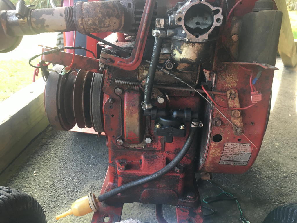

Update, SUCCESS!!  Thanks for the help guys....
I removed the hose from inlet side of the carb, and turned it over, it was squirting a little bit of fuel, but not nearly what I thought it should be.  While doing this, I realized I had changed the fuel lines and filter a few years ago EXCEPT for the little 4" piece that went from the outlet side of the pump to the inlet side of the carb.  Well, that short piece of hose was rock hard on the outside, and soft and gooey on the inside (I assume from the ethanol fuel it was not rated for??).  So, I cut of new piece of 1/4"  for that.  In the meantime I put my air compressor hose into the inlet side of the carb and blasted it with 30 psi of air to clean it all out.  I sprayed some carb cleaner in there and repeated.  I then removed the new fuel pump I had installed and made sure it was installed correctly (as somebody pointed out), and it seemed like it was fine, so I re-installed it.  Connected the fuel lines back up and turned it over, and it started almost immediately and ran for about 20 seconds which I assume was from the carb cleaner leftover AND the little bit of fuel still left in the fuel filter.  So I put the front end back on, connected the fuel tank back up and cranked it over for about 10 seconds and she started up and ran like a champ as usual.  Since I had it apart and my tools near it, I re-wired my winch (I have a 2000lb winch mounted on the ass end) which was not working due to a bad solenoid/switch.  Got that working too.  So she is ready for the snow, BRING IT ON!!!!    ;-)
Thanks again for the help!

ZXT
Here's a 10 second video of it running, and a pic of the front end off!
https://youtu.be/ul4OogEdg0A
A collapsed hose will definitely impede the fuel flow. I'm sure ethanol had at least some role in it.
Glad to hear that you're back up and going! And you're even still running the original breakerless ignition! Very cool. Is the push rod hole where the points would normally be drilled? Looks like it might be. You'd think there would be some sort of plate covering it.
