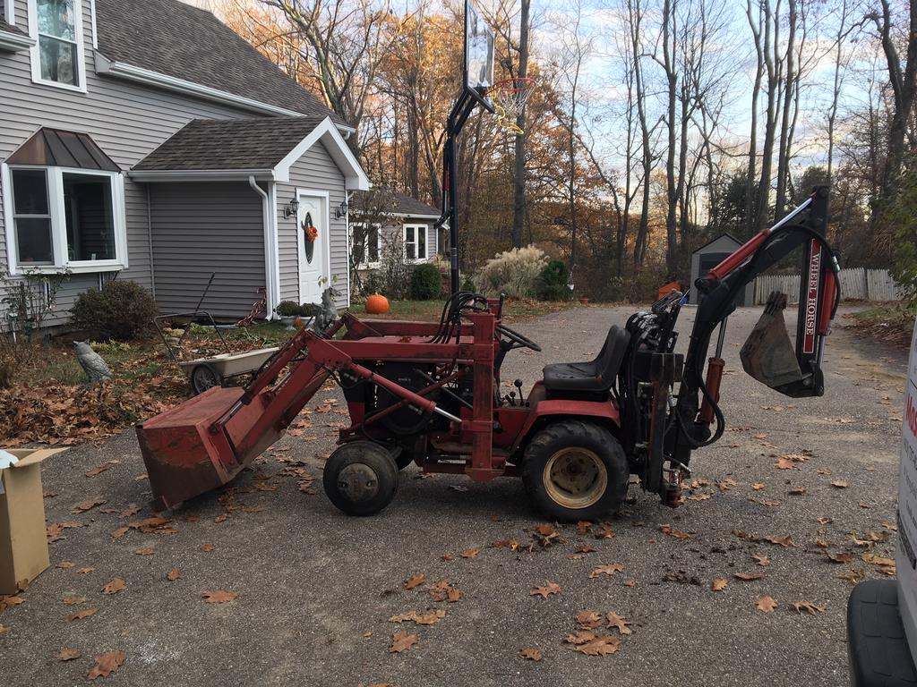

wallfish 20,020 #30 Posted October 3, 2019 (edited) 9 hours ago, FAST said: What blueprints with parts list would you guys recommend? I would love to not have to pay for them but I will if that’s what it takes. Trust me, spend the money on a set of good plans. It's money well spent on a proven design and not that much compared to the overall cost to build one. I used pfengineering.com for back hoe plans. His plans are pretty good but they're just that, plans. There's no step by step instructions with them but you can get plenty of help from him (Paul) or right here on RedSquare. If you are good with engineering your own stuff check out these free FEL plans. I have some free basic Back hoe plans somewhere too Edited October 3, 2019 by wallfish 1 2 2 Share this post Link to post Share on other sites
wallfish 20,020 #31 Posted October 3, 2019 This works good for no more shovels or wheel barrows. 3 2 1 1 Share this post Link to post Share on other sites

FAST 87 #37 Posted October 4, 2019 3 hours ago, wallfish said: This works good for no more shovels or wheel barrows. That’s exactly what I want my tractor to be like. Very nice. Thanks for posting the picture. 2 Share this post Link to post Share on other sites
