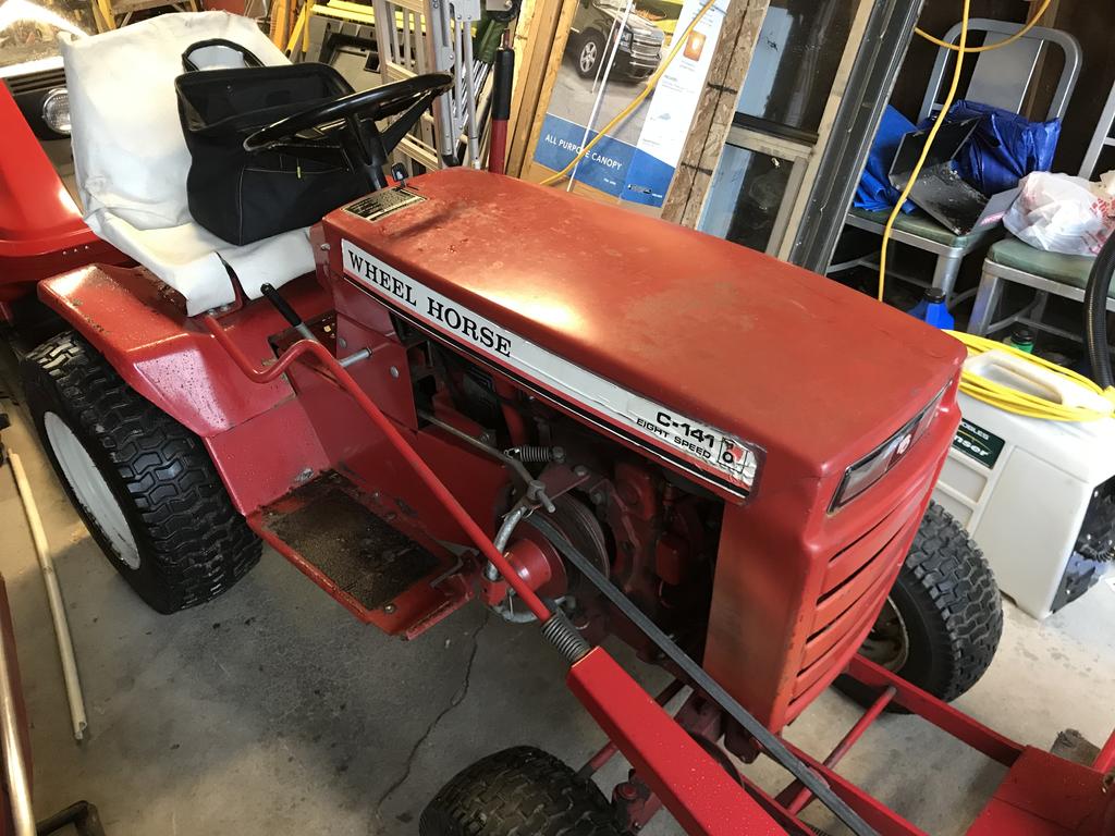

FAST 87 #1 Posted October 2, 2019 Wanting to know if this is a good tractor and what if anything I should be aware of as a weak link? It came with a snow thrower but I didn’t get the bar to raise and lower it, so I need to find one of those. I also really need a mower deck for it and perhaps a bagger. What should I be looking for that will fit this tractor? Thanks so much for any help you all are able to provide. 1 Share this post Link to post Share on other sites
857 horse 2,588 #2 Posted October 2, 2019 14 HORSE POWER AND AN 8 SPEED...YOU ARE SO FAR AHEAD OF THE GAME,,,ITS NOT EVEN FUNNY..!!!!! MY BIGGEST IS A 3 SPEED AND 8 HORSEPOWER..... NOTHING TO WORRY ABOUT HERE.. YOU SHOULD CHANGE THE OIL....CHANGE THE TRANS FLUID.....REPLACE THE WORN OUT SHIFTER BOOT....... AND RIDE.!!!!!! FIX WHAT IT NEEDS AS YOU GO..... AND WELCOME TO RED SQUARE........EVERY AND ANYTYHING YOU NEED OR WANT TO ASK FOR IS HERE IN THIS GROUP.... MIXED GROUP......ALL VERY GREAT PEOPLE...AND ALL FULL OF HELP.... OTHERS WILL BE ALONG TO SAY HI.... YOUR MACHINE IS NOW IN GOOD HANDS.....WLCOME ABOARD,,,, HOWARD 857HORSE IN VA 1 Share this post Link to post Share on other sites
The Tuul Crib 7,354 #3 Posted October 2, 2019 5 minutes ago, 857 horse said: 14 HORSE POWER AND AN 8 SPEED...YOU ARE SO FAR AHEAD OF THE GAME,,,ITS NOT EVEN FUNNY..!!!!! MY BIGGEST IS A 3 SPEED AND 8 HORSEPOWER..... NOTHING TO WORRY ABOUT HERE.. YOU SHOULD CHANGE THE OIL....CHANGE THE TRANS FLUID.....REPLACE THE WORN OUT SHIFTER BOOT....... AND RIDE.!!!!!! FIX WHAT IT NEEDS AS YOU GO..... AND WELCOME TO RED SQUARE........EVERY AND ANYTYHING YOU NEED OR WANT TO ASK FOR IS HERE IN THIS GROUP.... MIXED GROUP......ALL VERY GREAT PEOPLE...AND ALL FULL OF HELP.... OTHERS WILL BE ALONG TO SAY HI.... YOUR MACHINE IS NOW IN GOOD HANDS.....WLCOME ABOARD,,,, HOWARD 857HORSE IN VA 1 Share this post Link to post Share on other sites
FAST 87 #7 Posted October 2, 2019 (edited) This is the only photo I have atm. And thanks for the kind words. That helps relieve some worry. Edited October 2, 2019 by FAST Share this post Link to post Share on other sites
RandyLittrell 3,946 #8 Posted October 2, 2019 Looks nice! Welcome to the best forum on the net! Randy Share this post Link to post Share on other sites
The Tuul Crib 7,354 #9 Posted October 2, 2019 Wow nice lookin tractor! Share this post Link to post Share on other sites

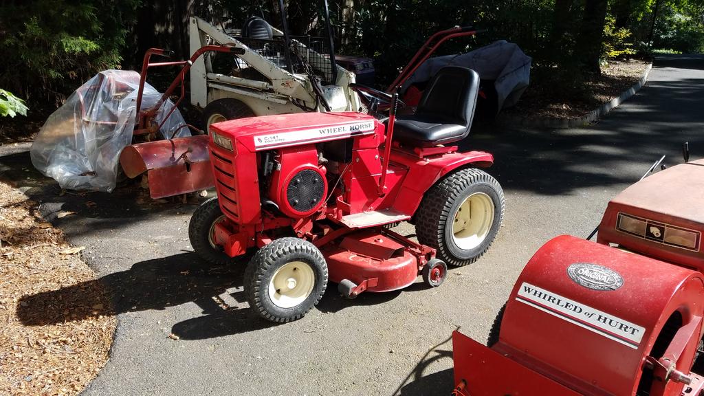

oldredrider 2,554 #11 Posted October 2, 2019 One of my junk yard dogs. Dang fine all season worker. If you want to use a bagger, you'll need to find a 42" or 48" side discharge mower deck. C-141 will swing either o e easily. 1 2 Share this post Link to post Share on other sites

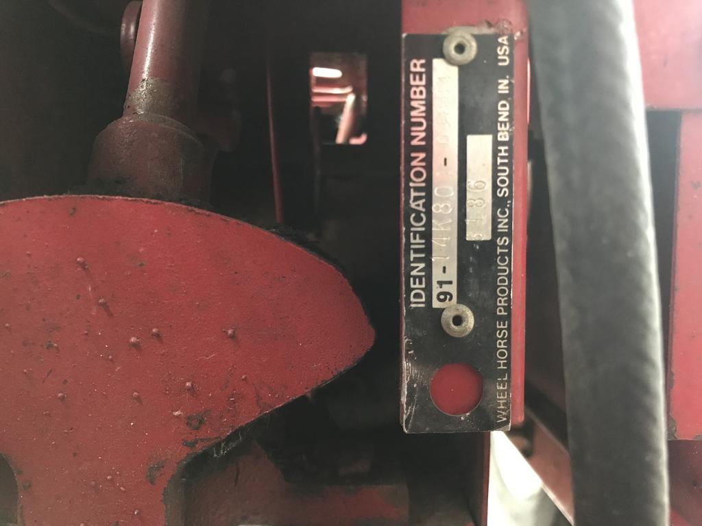

FAST 87 #23 Posted October 3, 2019 Also another question. How can I tell what year this thing is exactly? I know it’s either a 78 or 79 but I can’t find a place on the net to check the actual numbers to find a exact year. I would love to get a manual for it. I had a bronco 14 awhile back and had a manual for it and it was really helpful. Share this post Link to post Share on other sites
c-series don 12,656 #24 Posted October 3, 2019 If the number starts with an 8 it’s a 78, 9 it’s a 79. Share this post Link to post Share on other sites
FAST 87 #25 Posted October 3, 2019 31 minutes ago, c-series don said: If the number starts with an 8 it’s a 78, 9 it’s a 79. So is this a 78 or 79? Not sure what number I’m supposed to be looking at. Thanks so much. Share this post Link to post Share on other sites
