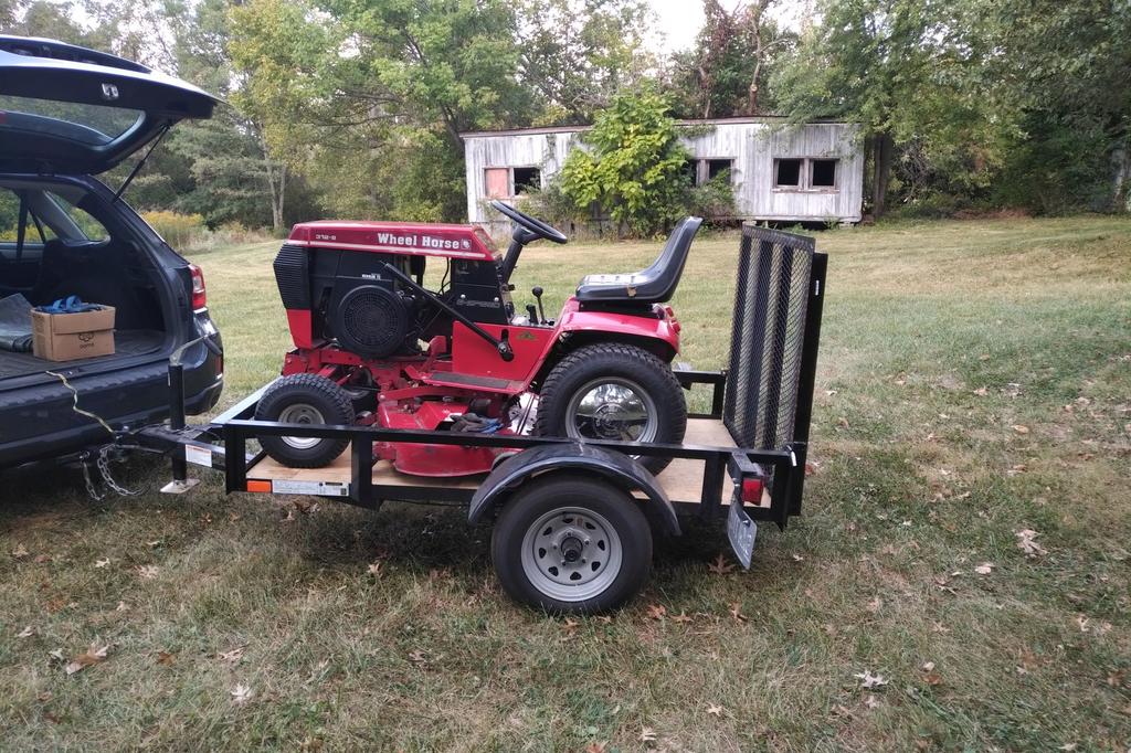

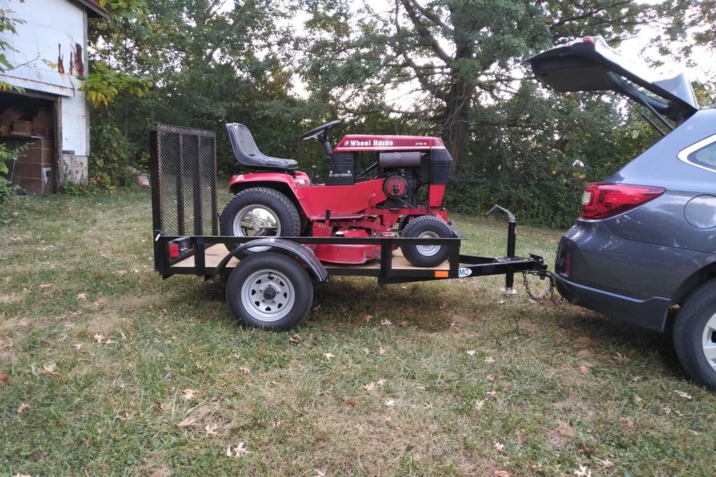

cjb398 29 #8 Posted October 1, 2019 BTW, here's the 312-8 I picked up today. Just a couple of quick pictures before unloading it. 5 4 Share this post Link to post Share on other sites

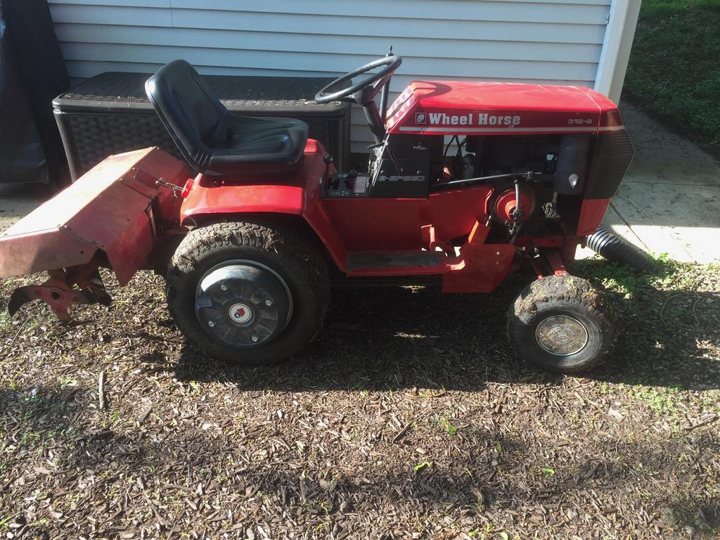

Andy N. 2,799 #11 Posted October 1, 2019 I have both a 312-8 and 520-H. Love them both, and have used my tiller with both. The manual trans and low gear on the 312-8 was much better for tilling. It didn't feel like the tiller was pushing me down the row as much as it did with hydro trans on the 520-H. Nice tractor BTW! 3 1 1 Share this post Link to post Share on other sites

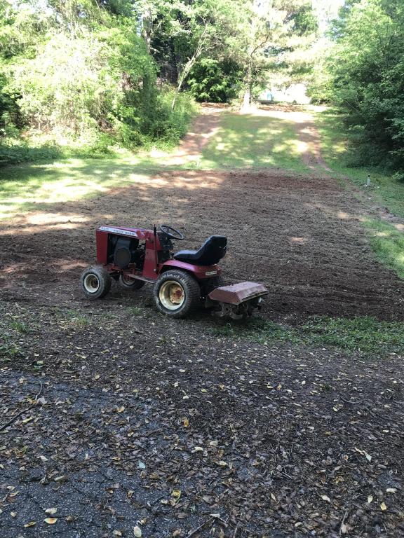

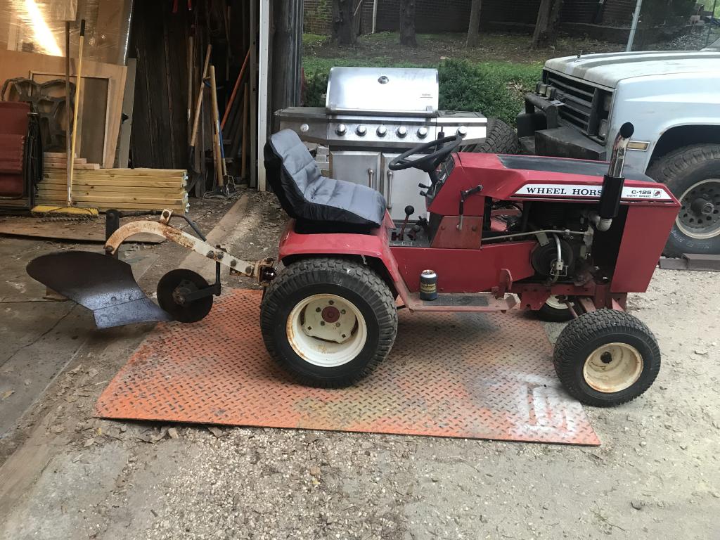

Southkraut 45 #14 Posted January 26, 2020 I plow and till with my C125. Works great. I seem to work up more ground each year. More fun to till than mow. 1 2 Share this post Link to post Share on other sites
