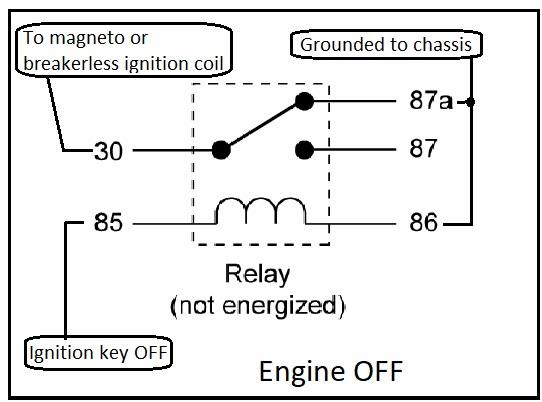

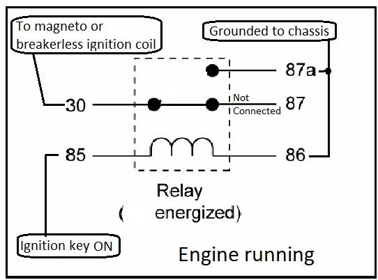

gwest_ca-(File Mod) 11,990 #5 Posted September 30, 2019 All is not lost if you do not have an M terminal on the switch. This terminal is grounded to the tractor chassis in the OFF key position. Alternately the switch will have am I (eye) terminal to send battery power to an ignition coil. You can use this circuit to control a relay that will open the ignition wire to allow the breakerless coil to operate in the RUN key position and ground the breakerless coil in the OFF position to shut it off. Wheel Horse did this for a few years when they used Briggs & Stratton engines with magneto ignition like you have and Kohler engines with battery ignition which required battery power to power the coil. They often referred to it as a "kill relay". The design standardized most of the wiring on the tractors at the time. What is required is a terminal on the ignition switch that is battery powered in the RUN and START key positions only if it is a switch with 3 key positions for OFF, RUN and START. Some tractor ignition switches have a 4th key position giving a RUN with ACCESSORIES option. It is the RUN position that will control a relay for the ignition. Given your location this may be an easier option for you. Garry Share this post Link to post Share on other sites

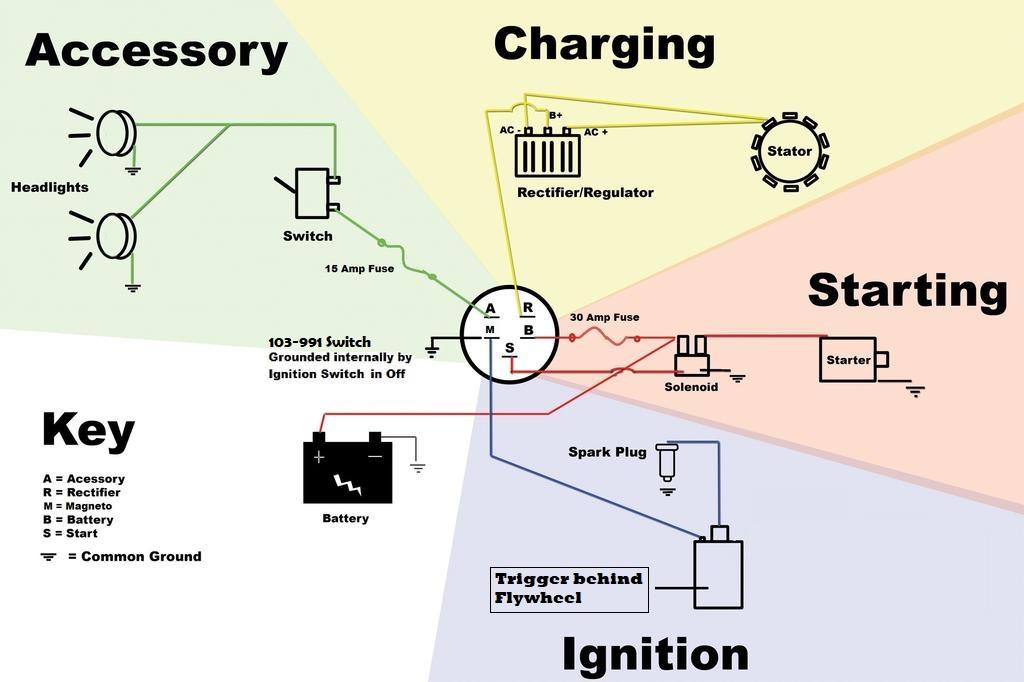

953 nut 63,986 #6 Posted September 30, 2019 Considering the alterations that have been made to your wiring I would suggest starting over with new wiring and a new switch. This drawing should be helpful. Share this post Link to post Share on other sites
gwest_ca-(File Mod) 11,990 #7 Posted September 30, 2019 Here is how an added relay would work. Garry Share this post Link to post Share on other sites
