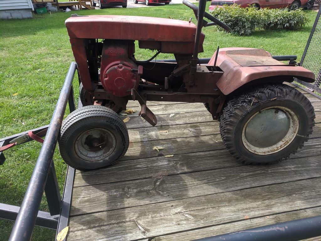

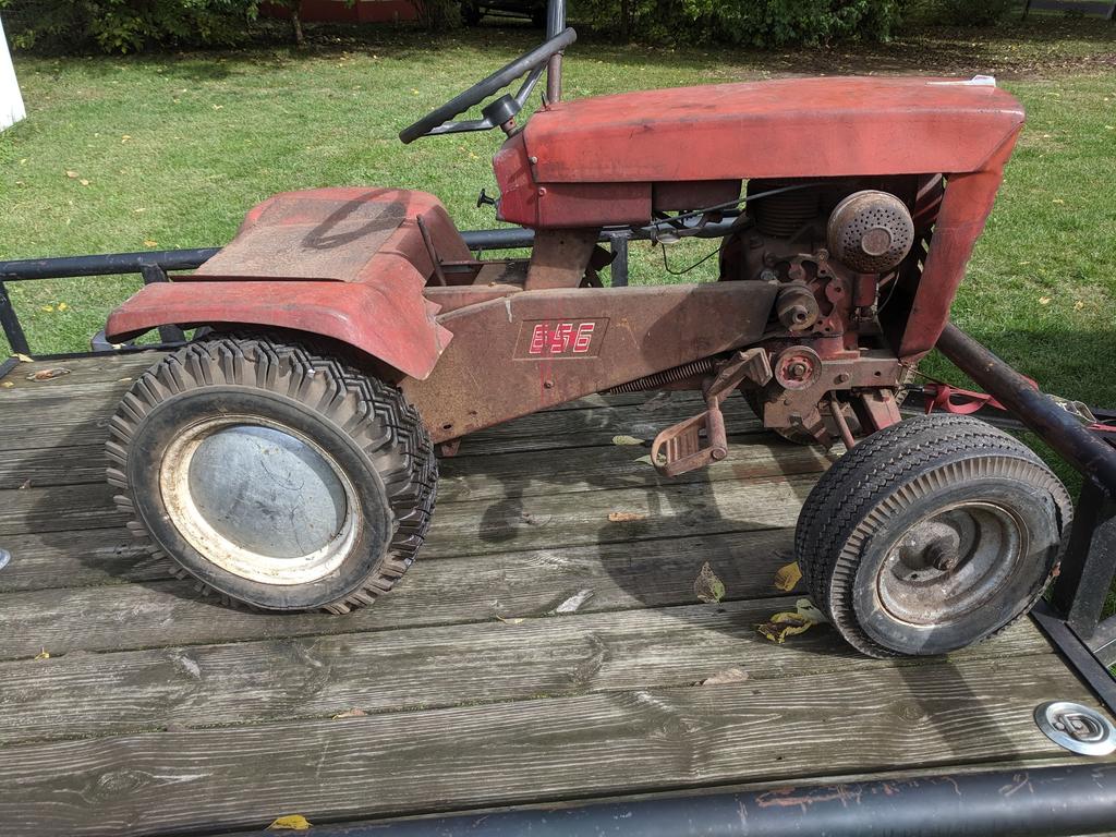

Howie 900 #1 Posted September 28, 2019 Picked up a 656 at a local auction today. Probably paid to much. 6 6 1 Share this post Link to post Share on other sites

Howie 900 #5 Posted September 28, 2019 (edited) Looks like this has had an engine transplant. Now has a K161 in it. Looks like it is a 1976 engine. Has the Wheel Horsem tires on it but are badly dry rotted. The metal seat pan has the back broken off. Tecumseh gas tank is mounted up in there. The original iginition switch is still there with at least part of the wiring still there. Part of it at least has been repainted at some point. It was just a few blocks from me and i have done some work on the lady's mowers in the past. didn't know she had a Horse around there also. Edited September 28, 2019 by Howie 1 Share this post Link to post Share on other sites

Howie 900 #9 Posted October 1, 2019 Looked at this tractor today. From the looks of the sparkplug this engine maynot be in very bad shape, no oil deposits on the plug. Carb pretty gummy, in the cleaner now. Don't know yedt if the fuel pump is going to work. Bottom of gas tank pretty rusty, trying to clean it. Pulled plug on transmission and water did not come out, at least from the side plug. Looked normal not milky. Have ordered a shifter boot, and will try to see how it is going to run. Share this post Link to post Share on other sites
Howie 900 #10 Posted October 9, 2019 Got this running last Saturday, seems to run pretty good. Soaked carb for a couple of days, float had a hole in it. Throttle shaft seems to be in good shape. was expecting to see more wear on it. Tramsmission is quiet, and will have to do something about tires. 2 Share this post Link to post Share on other sites
