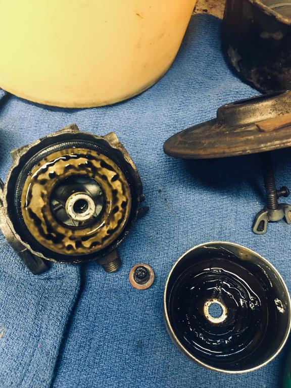

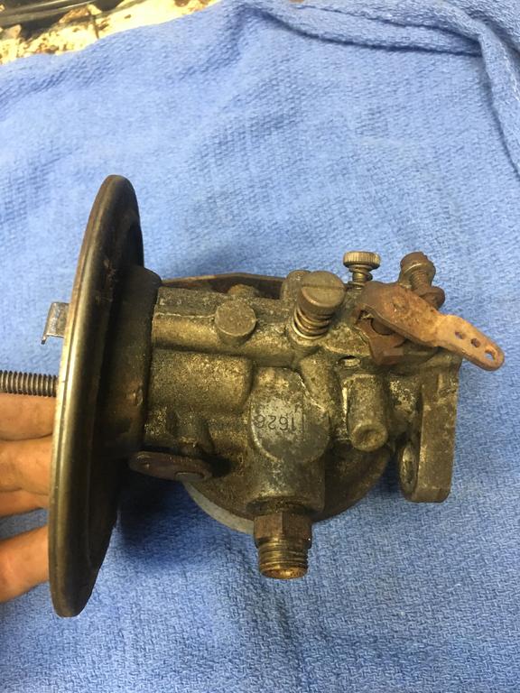

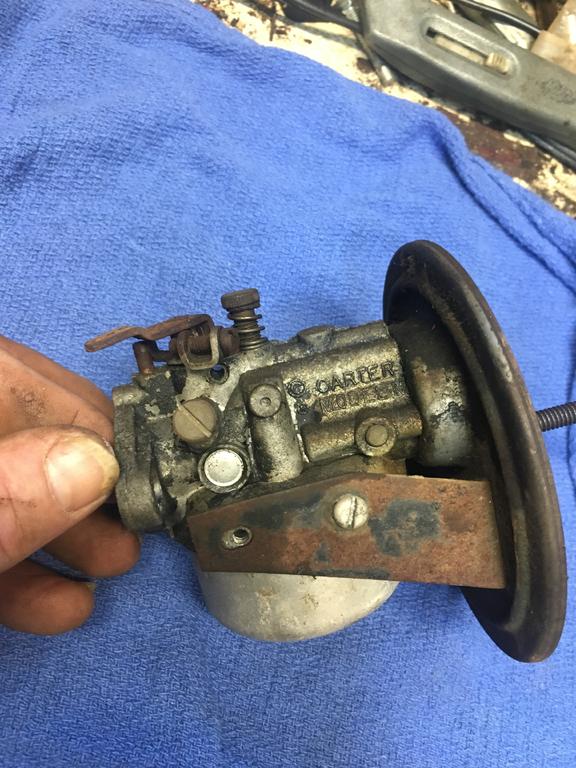

Burnerman 759 #1 Posted September 28, 2019 (edited) There was a Carter Model N carb on the pre-65 K181 that’s in our MF8E. I can’t find Carter listed in the Kohler carb reference book I have only Kohler and Walbro. Anyone have any ideas? I did a google search and found out it’s the original carb. I guess I’ll be cleaning it up nice. It’s a number 1626. Edited September 28, 2019 by Burnerman I used google Share this post Link to post Share on other sites

Burnerman 759 #3 Posted September 28, 2019 (edited) 24 minutes ago, stevasaurus said: Those carbs are a piece of cake to clean up and re-build. Re-build kits on E-Bay and cheap. You ain’t kidding!! Cleaned right up without a kit. It starts up instantly and runs great!!😇 I had to pull the steel line between the fuel pump and carb and swap in a new one. It’s got a very cool choke plate. I hope it stays together. 😲😁 Edited September 28, 2019 by Burnerman 2 1 Share this post Link to post Share on other sites
