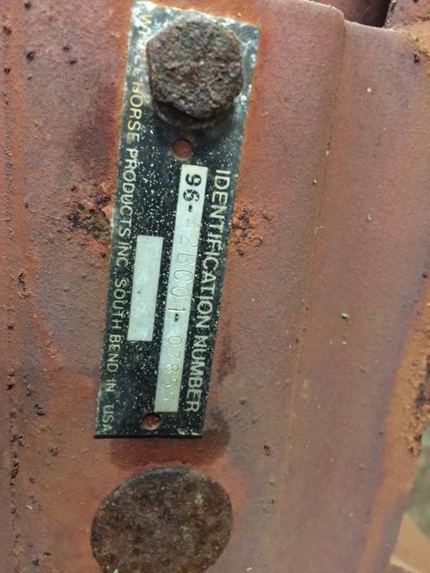

Too much red 65 #1 Posted September 26, 2019 I found a snow plow on craigslist but I'm not sure it'll fit so I figured I'd ask the guys in the know. The guy sent me a pic of the Id tag but it doesnt match anything on my 1964 implement sheet I downloaded off of here. I just want to make sure the model numbers didn't changed as the years went on and it is compatible I just don't know it. Share this post Link to post Share on other sites
gwest_ca-(File Mod) 12,455 #2 Posted September 26, 2019 It should fit. This 96-42BC01 is designed to fit long and short frame tractors by moving the rear crossbar ahead to fit your short-frame 854. Garry 1 Share this post Link to post Share on other sites
Too much red 65 #3 Posted September 27, 2019 Thats great news. Thank you sir. Share this post Link to post Share on other sites
