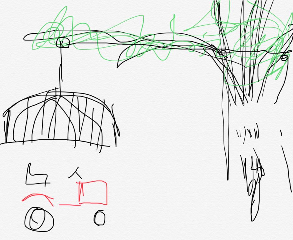

Stormin 9,988 #154 Posted January 26, 2020 How about something to lock the tractor in gear? Or a movement sensitive alarm. Or do a Mr Bean and take the steering wheel with you. 4 Share this post Link to post Share on other sites
peter lena 10,043 #156 Posted January 26, 2020 mickwhitt, did you ever lube the two ends of the governor shaft ? i noticed that on a engine swap , the governor shaft was a little sticky or hesitant to follow the throttle movement. , i disconnected all related linkage points and freed them up with lubrication and movement , there was like a rusty crud on every point. the full movement swing and regular lubrication has made for much better throttle response and visible governor shaft response. my experience, pete Share this post Link to post Share on other sites
Pullstart 71,175 #157 Posted January 27, 2020 Lock a cable through a rear wheel to the hitch? How long would you plan on being away from it, and how far away too? I imagine you need a resolution that is easy to store as well as operate? Could do a classic booby trap... 5 Share this post Link to post Share on other sites
Mickwhitt 5,259 #158 Posted February 2, 2020 I'm looking at some kind of padlock around the gear lever to.lock it in reverse. Got a few ideas and I will try them out before deciding which suits best for convenience. Like you say it needs to be portable and easy to fit or I wont bother one time and get burned. Mick 1 Share this post Link to post Share on other sites
Stormin 9,988 #159 Posted February 2, 2020 All you need there is a flat bar bolted to the front of the fender, with a hole in the end where the lever domes too. Padlock just big enough to go round lever and through hole. 1 Share this post Link to post Share on other sites
Mickwhitt 5,259 #160 Posted February 7, 2020 Had a think and found some stainless steel Yacht eyes which fitted a decent padlock. Looks good and locks the gear lever in reverse. Five minute job to fit. 5 1 Share this post Link to post Share on other sites

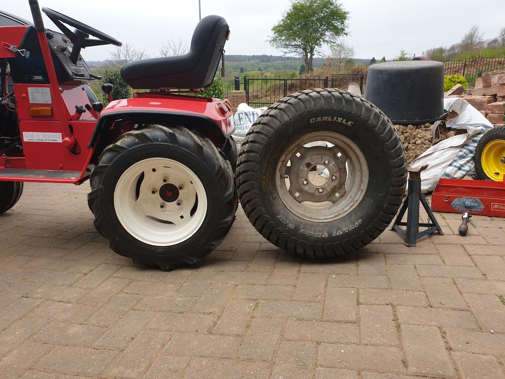

Mickwhitt 5,259 #166 Posted April 9, 2020 Bored with being on lockdown so I dug out a pair of wheels and tyres I bought ages ago but never used. They just fit but the sidewalls rub on the seat support bracket. Can I make spacers to move the wheel out a little, or does it need to seat on the wheel flange? If so i will have to turn and bore a round disc. Mick Share this post Link to post Share on other sites
ebinmaine 80,489 #167 Posted April 9, 2020 Not sure what your availability in Europe would be. We can use 5 x 4.5 bolt pattern spacers from something like an old Ford or Jeep. Very readily available. On the Cinnamon Horse I have a pair of wheels that came from an unknown garden tractor and the backspacing was wrong. I have three inch thick aluminum spacers on there to give me maximum width for stability. Been running them like that for three seasons I think? Share this post Link to post Share on other sites
Stormin 9,988 #168 Posted April 9, 2020 You could make up spacers, Mick. One side with a recess to fit the hub, t'other with a spigot to fit the wheel. Have you got bolts long enough to go through wheel and spacer? The other way of course is make the spacers thick enough to drill and tap for the wheel, with counter sunk holes for spacer to hub. Share this post Link to post Share on other sites
Mickwhitt 5,259 #169 Posted April 9, 2020 I meant to include a picture. There is enough bolt to fit spacers as I put bolts through from the rear of the hub and use Ford wheel nuts. I did think about putting a wheel nut on each stud backwards way round so the cone seat is outer most then putting the wheel on and another wheel nut. Might be a bit too long though. So individual spacers on each wheel bolt will be ok then? Mick 1 Share this post Link to post Share on other sites
ebinmaine 80,489 #170 Posted April 9, 2020 10 minutes ago, Mickwhitt said: individual spacers I use a roughly 6 inch round aluminum spacer. I like the idea of having a full circle of wheel to hub contact. 1 Share this post Link to post Share on other sites
Stormin 9,988 #171 Posted April 9, 2020 I'm in agreement with Eric. Those wheels are off one of the bigger Wheel Horses. Someone will know which ones. The offset in the rim is different to the ones on your C-125. That is why they catch. Also to fit those tyres it looks like you'll have to raise the fender quite a bit.. 1 Share this post Link to post Share on other sites
Mickwhitt 5,259 #172 Posted April 9, 2020 I understand, seen a version on ebay which I can look at to check the size. If they dont fit I can turn up a pair from alloy discs. Mick Share this post Link to post Share on other sites
Mickwhitt 5,259 #173 Posted April 9, 2020 I fitted the wheels on and other than catching the seat bracket they do fit under the fender. I will report back if I get them to work. Mick 1 Share this post Link to post Share on other sites
Mickwhitt 5,259 #174 Posted April 9, 2020 this is shown as 5 x 4.5 and 1 inch thick. Worth buying? 26 pounds for a pair. Mick 1 Share this post Link to post Share on other sites
Stormin 9,988 #175 Posted April 9, 2020 Look well made and price isn't bad I suppose. Only you can say they're worth buying. They would give you the clearance you need. 1 Share this post Link to post Share on other sites
