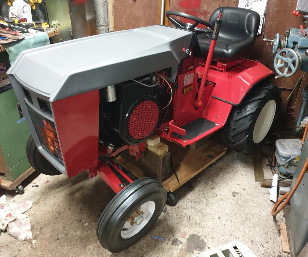

Mickwhitt 5,259 #103 Posted December 4, 2019 Again many thanks for all the messages of support, certainly appreciated. First day in the shop today and I'm moving towards finishing touches. Got the grip paper on the foot boards and fitted the side guards. Full set of decals on the way so I best paint the hood. Mick 2 Share this post Link to post Share on other sites

Mickwhitt 5,259 #113 Posted December 13, 2019 Finished painting the hood, just the decals to fit when its hardened off. 3 2 1 Share this post Link to post Share on other sites

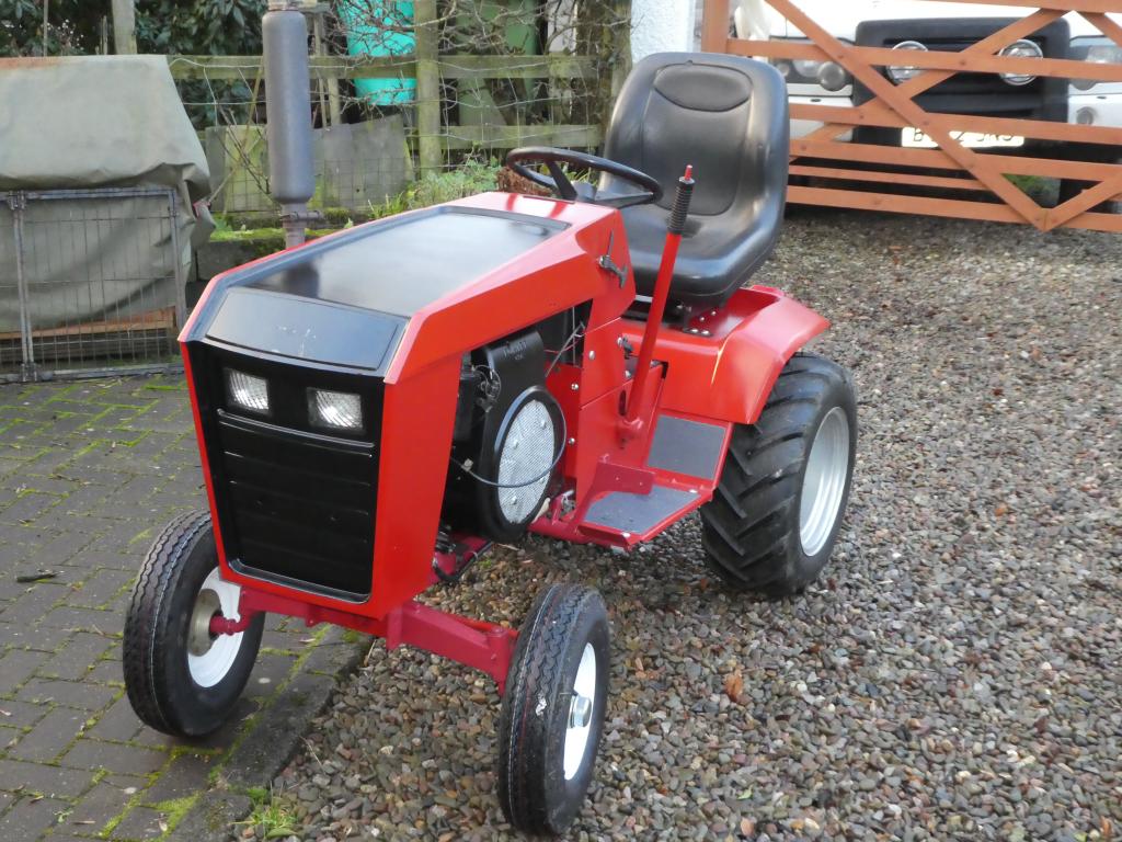

Mickwhitt 5,259 #114 Posted December 14, 2019 So she starts, she runs, but I cant get her to idle properly. Keep using the choke to keep her going, but if I lower the throttle too far she dies out. Need to play with carb settings I hope. I have not disturbed the governor so I hope that's ok. Did the decals this afternoon. 4 2 1 Share this post Link to post Share on other sites

Mickwhitt 5,259 #118 Posted December 15, 2019 Thanks for all the positive comments. I'm really proud i managed to make something of her. With all your help and advice of course. From the basic settings I managed to get her to idle quite smoothly. Warmed up she seems to run fine. I will wait for a decent day and wheel her out into the drive for a test run. Exhaust is pretty loud, i think it's just a cylinder with a very short baffle tube inside. I will make some enquiries about getting a new one made. Mick 1 1 Share this post Link to post Share on other sites
