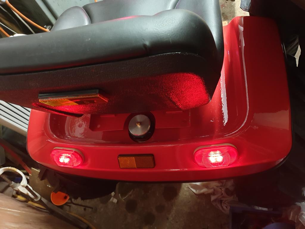

Mickwhitt 5,259 #82 Posted November 22, 2019 Well I managed to get some paint on the seat tray. I'm not 100% happy with it but needs must at this time of year. Now its painted I have assembled the seat and fitted the rear lights. 2 4 Share this post Link to post Share on other sites
ebinmaine 81,150 #83 Posted November 22, 2019 Looks great so far Mick. You can always wait till better weather next spring or summer and pop it off and repaint it one day. Share this post Link to post Share on other sites

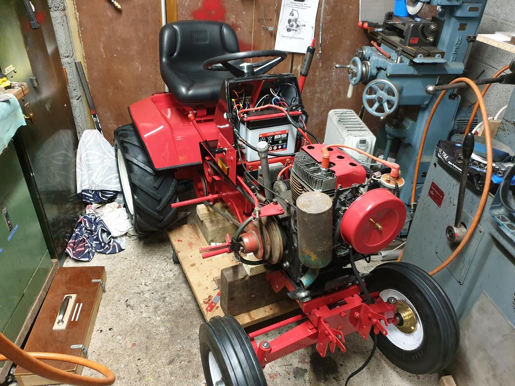

Mickwhitt 5,259 #84 Posted November 23, 2019 I think that will be the best bet, I sprayed the final coat indoors but it was not ideal. Just the hood to do now and the footboard. Then it's time to gas her up.and get the engine running. Not sure about that yet but I will try to get the carb set up before I try to fire her up. Any advice on first time starting after a rebuild? Mick 1 Share this post Link to post Share on other sites
Stormin 9,988 #85 Posted November 23, 2019 (edited) Fitting a primer bulb between tank and pump will get fuel through, without a lot of cranking. Or remove air filter and spray petrol into the carb, while turning the engine. You'll find carb settings in the manuals. Not sure off hand. Maybe 2 turns main and 1-1/4 idle. That skateboard non slip material is ideal for the footboards. Edited November 23, 2019 by Stormin 2 1 Share this post Link to post Share on other sites

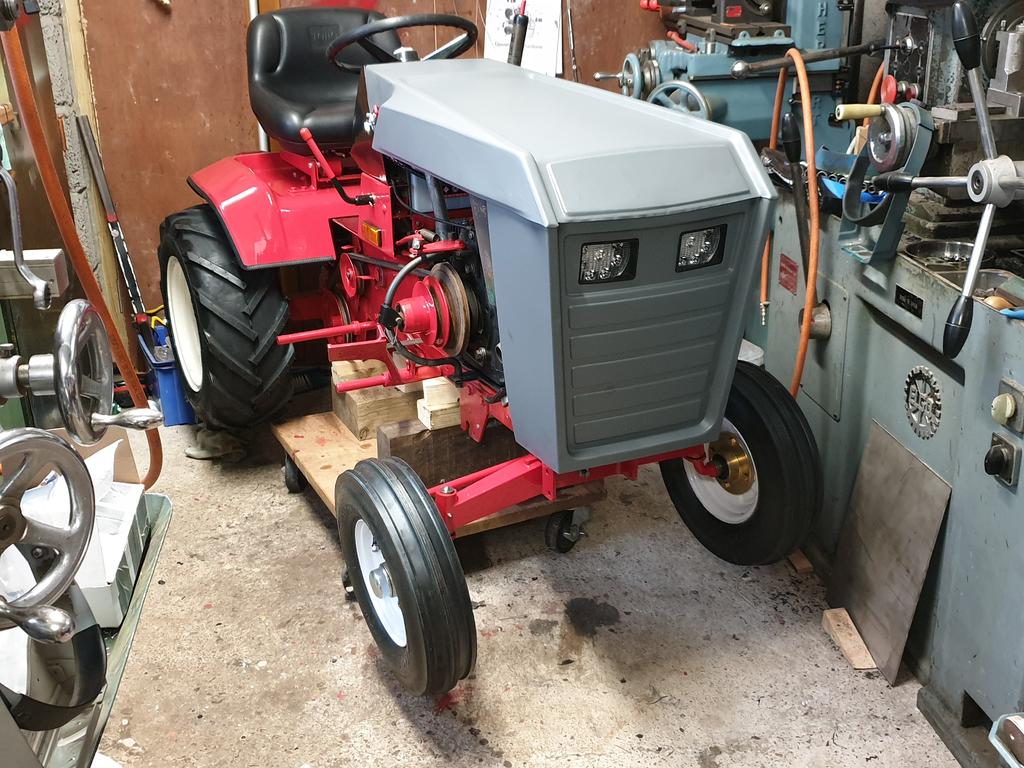

Mickwhitt 5,259 #86 Posted November 23, 2019 I have put a primer bulb in the fuel line so it wont be long before I bite the bullet and try to start her. Put the bonnet back on this morning just to get it out of the way. 2 2 Share this post Link to post Share on other sites
tom2p 2,396 #87 Posted November 23, 2019 looks great ! Share this post Link to post Share on other sites

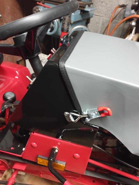

Stormin 9,988 #88 Posted November 23, 2019 3 hours ago, Mickwhitt said: Just noticed the trim round the fender edge. Nice touch! 1 1 Share this post Link to post Share on other sites
Mickwhitt 5,259 #89 Posted November 23, 2019 Norm, that's from ebay, good quality panel edging strip. Going to do the bonnet edges too. Thanks to all who say it looks good. I really wasnt sure I could rebuild it after 12 years in boxes. Wait till I'm driving down the street lol. Mick 2 Share this post Link to post Share on other sites
Mickwhitt 5,259 #90 Posted November 24, 2019 So, carb set to the initial settings as per the manual. Fuelled up, primed, choke on, press the starter....... Cranks over, float chamber fills..... She fires, she runs! Bit lumpy, bit of back firing but she runs. I can move on to finishing the details and making Fred looking good. I had a strip of edging strip left over and put it on the bonnet closure lip, looks neat and the bonnet closes beautifully. 2 5 Share this post Link to post Share on other sites
Stormin 9,988 #91 Posted November 24, 2019 I think that bonnet/hood, would look nice silver with a black grill. Share this post Link to post Share on other sites

Mickwhitt 5,259 #93 Posted November 25, 2019 Norm, I'm just painting the grille black, then I'll have a look at the rest of the bonnet. Danny, very kind of you to say my skills are good. I'm self taught other than a short six year stint as a diesel mechanic at my local authority. I'm very happy with my machine shop and love making parts for my various projects. I could not manage without my lathes and mills. More rain here so no outdoor work for now, ground is saturated and slow draining clay so will take a while to dry out. Mick Share this post Link to post Share on other sites
