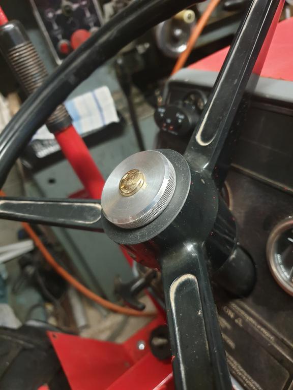

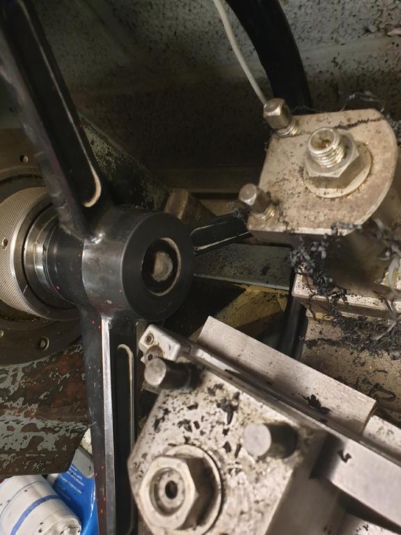

Mickwhitt 5,259 #60 Posted November 6, 2019 Bit of a Heath Robinson lathe job this afternoon. The steering wheel had been bashed about a fair bit so I decided to try and tidy it up. That meant it had to go in my capstan lathe as it's the only one with enough centre height. I cleaned up the rim and turned the centre boss flat. Tomorrow I will make a threaded cap to fit over the boss. 2 Share this post Link to post Share on other sites

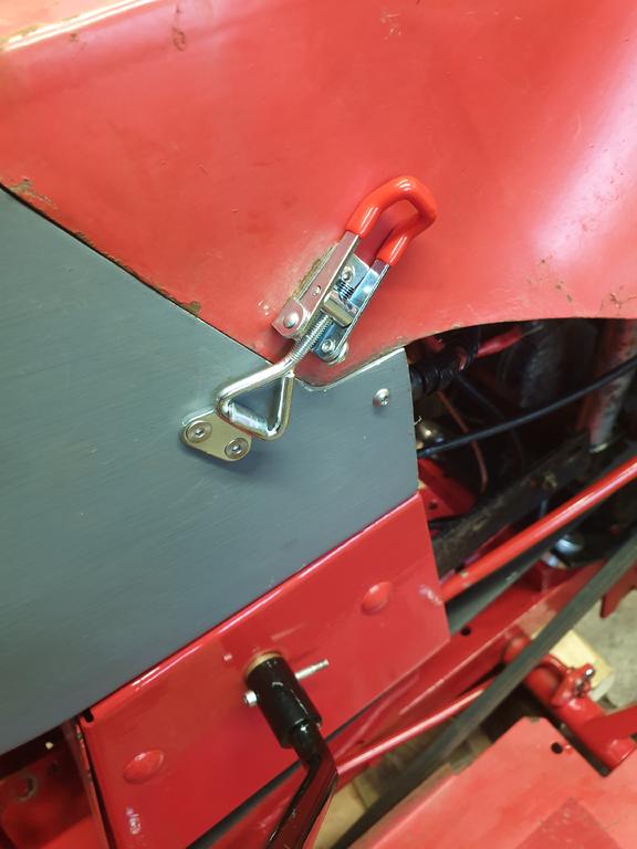

Mickwhitt 5,259 #61 Posted November 6, 2019 Also fitted new bonnet catches today and the new fuel lines. All in all a good day. 4 3 Share this post Link to post Share on other sites

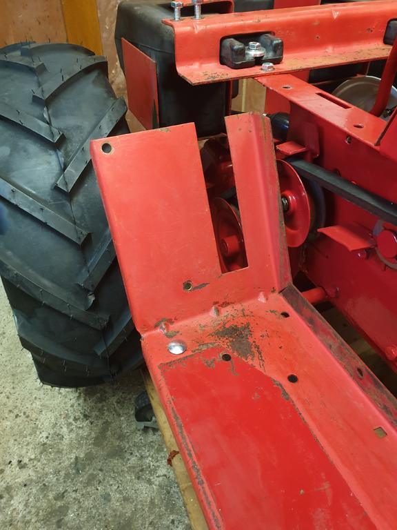

Mickwhitt 5,259 #62 Posted November 6, 2019 Just a question. There is a slot cut in the right hand side foot plate/wheel arch. Any thoughts on why it's there? The tractor came with no seat deck but a roll bar frame. Not sure if that was original. Share this post Link to post Share on other sites

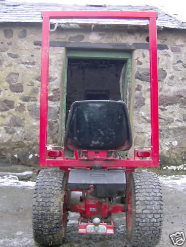

Mickwhitt 5,259 #63 Posted November 7, 2019 This is the Ebay photo of my WH in North Wales. You can see the odd arrangement at the back end. No seat tray or mudguards, roll bar fitted. It looks a home made set up but I'm no expert on WH machinery. The lights look right but are fitted in a metal frame to protect them, seat was original but damaged so I fitted a new Toro one. Share this post Link to post Share on other sites
Mickwhitt 5,259 #64 Posted November 7, 2019 Steering wheel centre boss done this morning. Looks neater than the bashed wheel centre. Will keep moisture out of the wheel shaft too so no seizing. 3 3 1 Share this post Link to post Share on other sites
Pullstart 71,520 #65 Posted November 7, 2019 17 hours ago, Mickwhitt said: Just a question. There is a slot cut in the right hand side foot plate/wheel arch. Any thoughts on why it's there? The tractor came with no seat deck but a roll bar frame. Not sure if that was original. Does that gap fit in line with either of the PTO bell’s grooves? I am not certain, but I think some of the tillers had a belt running through that area with another belt guard. Also, that ROPS bar is not factory at all. Share this post Link to post Share on other sites
Pullstart 71,520 #66 Posted November 7, 2019 10 minutes ago, Mickwhitt said: Steering wheel centre boss done this morning. Looks neater than the bashed wheel centre. Will keep moisture out of the wheel shaft too so no seizing. Such a nice piece! Share this post Link to post Share on other sites
Mickwhitt 5,259 #67 Posted November 7, 2019 I did wonder about a rear PTO belt, but the ones I have seen went under the foot plate. I will have a look at the alinement tomorrow. Been painting the seat tower etc this evening. Mick 1 Share this post Link to post Share on other sites
pfrederi 21,312 #68 Posted November 7, 2019 (edited) No cuts needed for a normal tiller installation... Mine is up in the storage shed. If the snow doesn't pile up tonite i will try to get a picture tomorrow. Edited November 7, 2019 by pfrederi Share this post Link to post Share on other sites

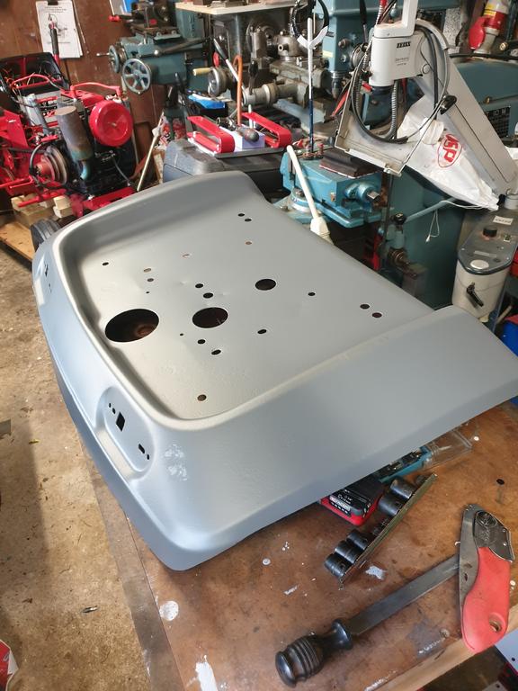

Mickwhitt 5,259 #69 Posted November 11, 2019 So, quite a busy weekend for me with running the home boarding business so not much done on the WH project. But, The seat tray is in for shot blasting and priming. The bonnet will go for the same tomorrow. Lots of bits and bobs primed ready for painting. Seat support and tank refitted. Shoukd all start coming together pretty quickly from now on. Then it will be setting up the engine which I'm hoping wont be too much of a PITA. Mick 1 Share this post Link to post Share on other sites

Mickwhitt 5,259 #73 Posted November 13, 2019 Got my seat deck back today, looks great in primer, just have to get some pain on it now, bonnet will be ready Friday. Not done much today as it was our community tidy up of an area of waste land opposite our home. I have formed a group to try and make the area a nicer place. Hopefully Fred will be a great help hauling tools and doing work. Mick 1 3 Share this post Link to post Share on other sites
