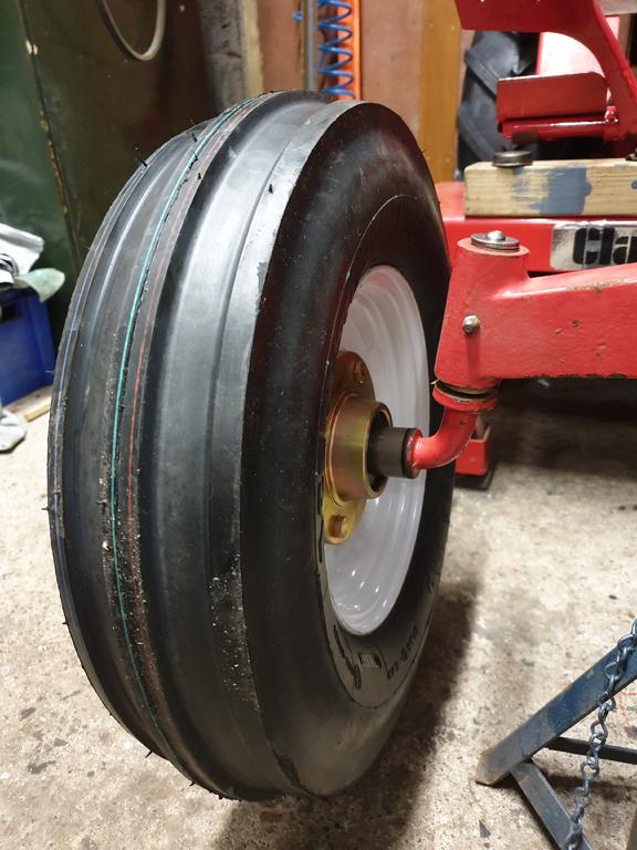

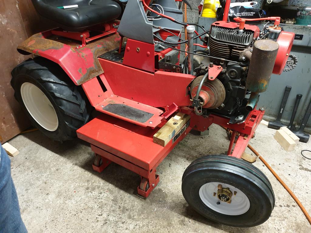

Mickwhitt 5,259 #26 Posted October 24, 2019 Got my new front wheels and tie rib tyres sorted today. Made a start on the stub axles and got one cut and bored to fit the cut off original axle. Another one to do tomorrow but should be easier now I know the method required. I think it's going to look pretty good on those new wheels and tyres. Oh I did a bit of work on the new seat, modifying the mounting as the bolt hole centres were all wrong for the seat support. Mick 8 Share this post Link to post Share on other sites

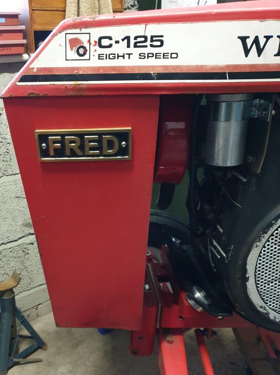

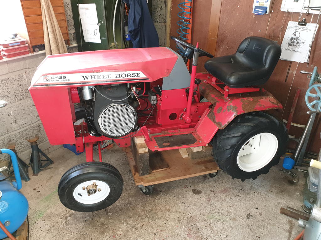

Mickwhitt 5,259 #31 Posted October 27, 2019 I named him Fred after my late father. Brass name plate custom made for me. 3 3 4 Share this post Link to post Share on other sites

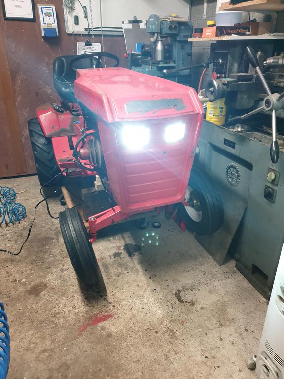

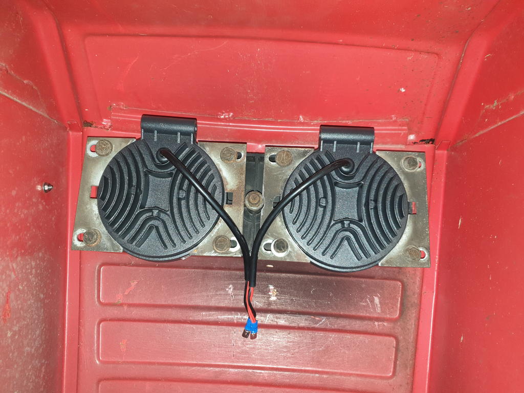

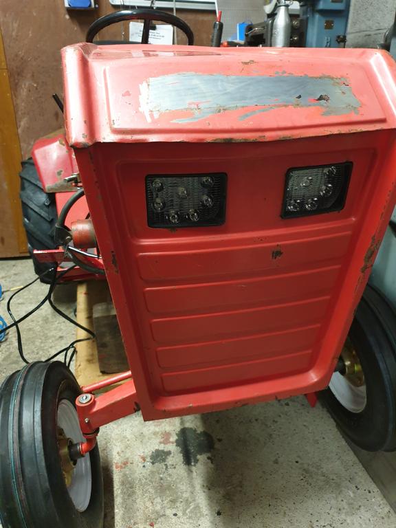

Mickwhitt 5,259 #32 Posted October 31, 2019 I found that both headlights were burned out so I ser about trying to source a replacement. Managed to find a set of LED lights the same size as the glass seaked beam units. Came with a wiring harness and solenoid and the control allows on and off as well as various flash patterns which is very cool. Took a few minutes to modify the lamp holder and they are well worth the effort. 3 5 Share this post Link to post Share on other sites
Mickwhitt 5,259 #33 Posted October 31, 2019 They are a round lamp but fit in the round bezel just right. They will be on a separate switch to the rear lamps, but that's not a problem. Mick Share this post Link to post Share on other sites

Mickwhitt 5,259 #36 Posted November 1, 2019 https://rover.ebay.com/rover/0/0/0?mpre=https%3A%2F%2Fwww.ebay.co.uk%2Fulk%2Fitm%2F383041794336 This is the link to ebay where I bought the lights. I just had to modify the clamp plates to take the slightly wider diameter lamp body. Mick 3 Share this post Link to post Share on other sites

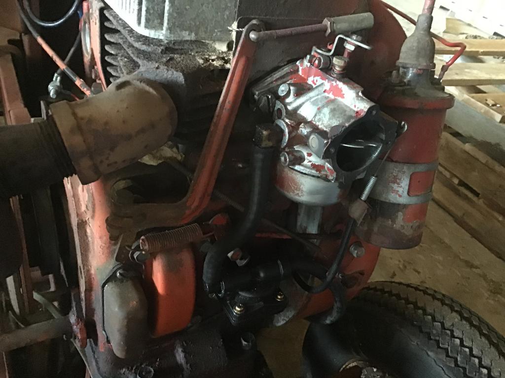

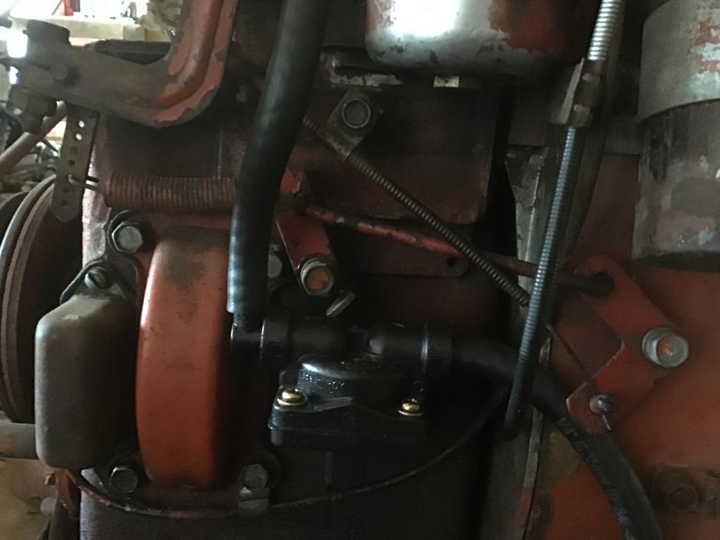

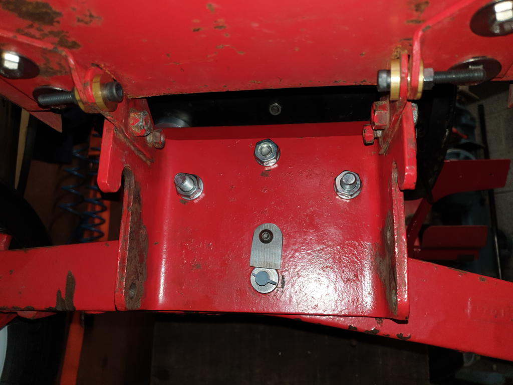

Mickwhitt 5,259 #37 Posted November 1, 2019 So the head lights are fitted and working. While I was messing with them I remembered the PTO pivot was badly worn. So off that came, bored out oversize and a new brass bush made for it. Now works really well. I cant figure out how the throttle cable fits at the engine end. I have a clamp for the outer cable but dont know where to fix the inner cable to. Long time since I took it off lol. I will hit the books a d find out I guess. Mick 1 Share this post Link to post Share on other sites
ebinmaine 81,150 #38 Posted November 1, 2019 49 minutes ago, Mickwhitt said: dont know where to fix the inner cable Picture gallery might help you out Share this post Link to post Share on other sites
Stormin 9,988 #39 Posted November 1, 2019 1 hour ago, Mickwhitt said: I cant figure out how the throttle cable fits at the engine end. I have a clamp for the outer cable but dont know where to fix the inner cable to. Been there and got the tee shirt. I'll try to remember to look at mine tomorrow and take a photo. 1 Share this post Link to post Share on other sites
Pullstart 71,520 #40 Posted November 1, 2019 @Mickwhitt here are pictures of the throttle setup on Rylee’s 10 horse. I hope it helps! 1 Share this post Link to post Share on other sites
Stormin 9,988 #41 Posted November 2, 2019 (edited) Bit different on the C-125, Kevin. Cable runs on the opposite side. Not the best of photo's I'm afraid. But you can just make out how things go. Edited November 2, 2019 by Stormin 1 Share this post Link to post Share on other sites

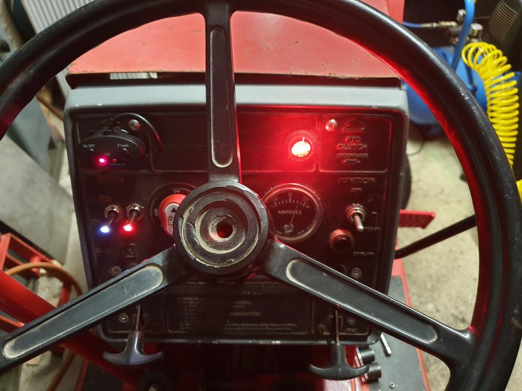

Mickwhitt 5,259 #45 Posted November 2, 2019 I managed to fathom the throttle cable fixing out. It runs nice and smoothly. Did a little more electrical work today, new switches for headlight isolator and tail lights. Illuminated toggle switches, look very nice. Also fitted an LED light to the starter button feed so I can tell when ignition is on. 3 Share this post Link to post Share on other sites
Stormin 9,988 #46 Posted November 2, 2019 You going to wear a flying helmet when driving? No ignition key switch? Share this post Link to post Share on other sites
Mickwhitt 5,259 #47 Posted November 2, 2019 No, no key switch. Just a toggle switch and starter button. So I put an isolator switch in the circuit with a removable key so I can imobilise her when necessary. Looks a bit flashy I admit but i like it that way. I'm on the lookout for a suitable helmet Mick 1 Share this post Link to post Share on other sites

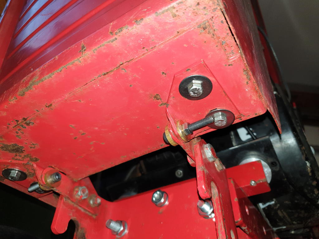

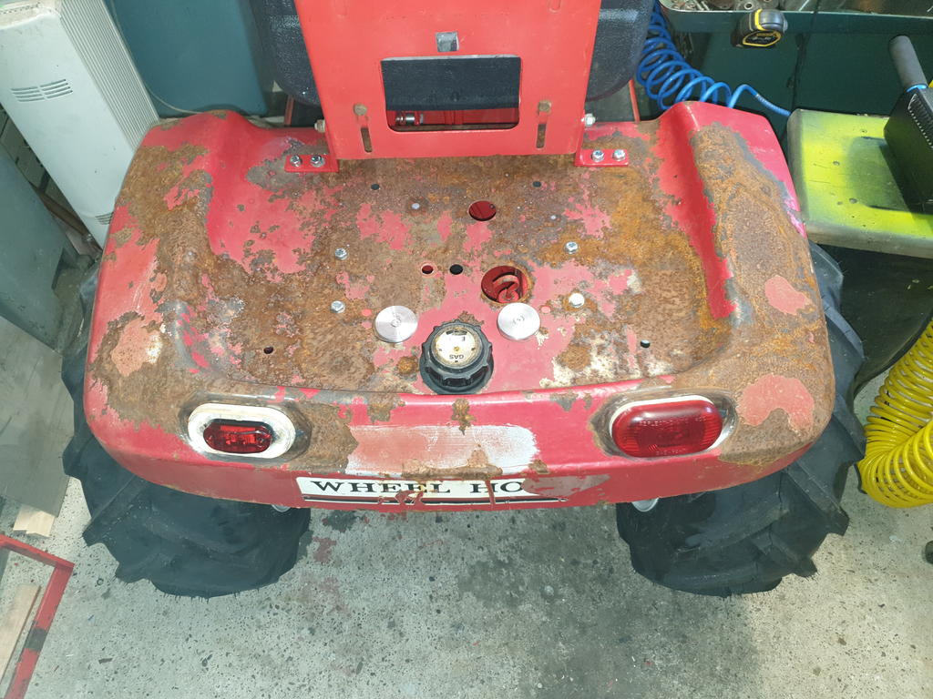

Mickwhitt 5,259 #48 Posted November 4, 2019 Did a little bit more over the weekend. The throttle cable was a pain, looks like the inner was too short so I made a brass sliding sleeve to allow me to extend it enough to route the outer cable properly. Looks to be working ok but I wont know till I fuel and fire her up. Made a pair of aluminium bump stops for the seat, I want keen on the seat buffers just sitting down onto the sheet metal of the seat tray so these will strengthen it. Also modified the rear light units, the insides were corroded so I removed the bulb holder and fitted a small led lamp unit inside. Looks quite good with the original lens over it. 1 1 Share this post Link to post Share on other sites

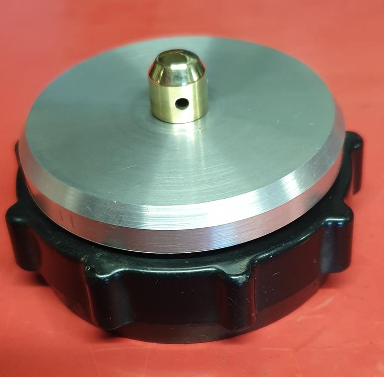

Mickwhitt 5,259 #50 Posted November 5, 2019 The fuel cap was broken and rusty. No gauge parts left at all, just the cap and dial. So I machined up the face and made an aluminium disc to bond over the top. I made a little ide entry breather unit out of brass to allow air to enter the tank but not water. Quite happy with the result. 3 1 2 Share this post Link to post Share on other sites
