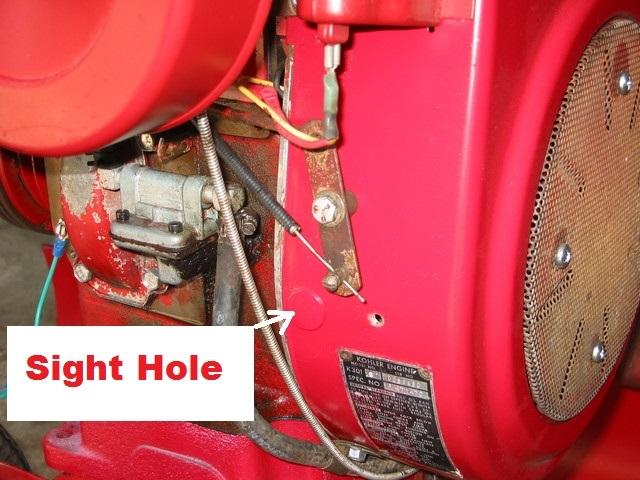

953 nut 67,489 #23 Posted October 4, 2019 To find TDC on a Kohler you can observe the timing marks on the flywheel or look at the crankshaft key-way. When the key-way is at the top the piston is at the top. 1 Share this post Link to post Share on other sites
