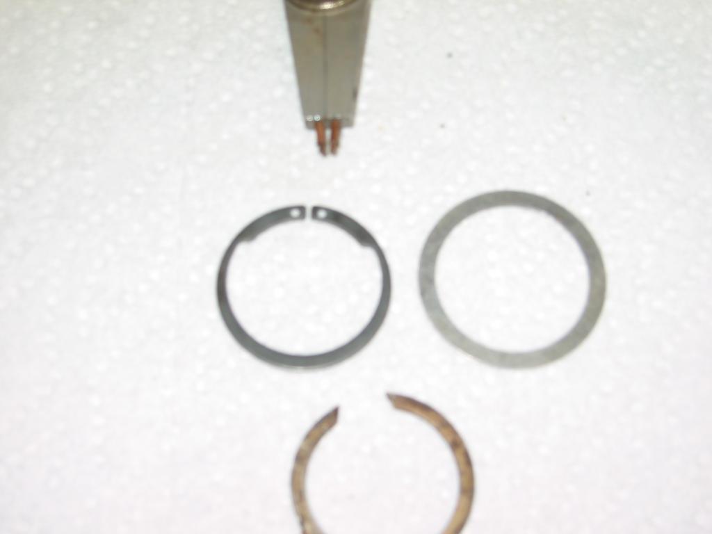

Treepep 1,148 #39 Posted December 18, 2019 I found the bearing part number 60062RSJ. I assembled and in the process of trying to get the rear snap ring in several times and not block the slot for the key-way I ruined it. Is there an aftermarket ring that uses regular snap ring pliers? Or any idea where I could source a replacement and appropriate pliers available? Any answers would be greatly appreciated. Thanks Share this post Link to post Share on other sites
Treepep 1,148 #40 Posted December 23, 2019 Rough dimensions. Green store has one the same diameter but less than half the thickness. Pretty sure that is not a great idea. I need a new one and I guess I need to find the external lock pliers as well online? I do not have a micrometer nor am I sure I bent it back enough for good measurements but I need a new one to finish my P.T.O. repair. Thanks Share this post Link to post Share on other sites
pfrederi 20,933 #42 Posted December 23, 2019 This is an alternative to the eaton ring. it is thinner but if you add a shim should be a snug fit. Some bearings used in older PTOs may require a couple shims. Does your bearing come up flush to the inside of the snap ring groove? Share this post Link to post Share on other sites
Treepep 1,148 #43 Posted December 23, 2019 Yes the bearing comes up flush to the "bottom" of the snap ring channel. Thank you, I am trying to get that fixed so I can figure out how to get the mower going. Is that setup available somewhere? Many thanks Share this post Link to post Share on other sites

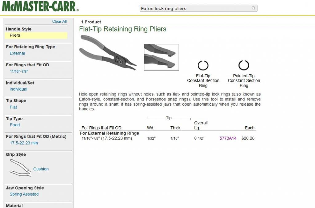

pfrederi 20,933 #44 Posted December 23, 2019 2 minutes ago, Treepep said: Yes the bearing comes up flush to the "bottom" of the snap ring channel. Thank you, I am trying to get that fixed so I can figure out how to get the mower going. Is that setup available somewhere? Many thanks Do you have snap ring pliers like in picture or can you borrow some I will send you the inverted external snap ring and a shim. That should make for a snug fit. Just PM me your mailing address. Share this post Link to post Share on other sites
Treepep 1,148 #45 Posted December 23, 2019 I believe I have every other type of snap ring pliers just not the Eaton type. Thank you Share this post Link to post Share on other sites
pfrederi 20,933 #46 Posted December 23, 2019 9 minutes ago, Treepep said: I believe I have every other type of snap ring pliers just not the Eaton type. Thank you PM your address i will mail them tomorrow. Share this post Link to post Share on other sites

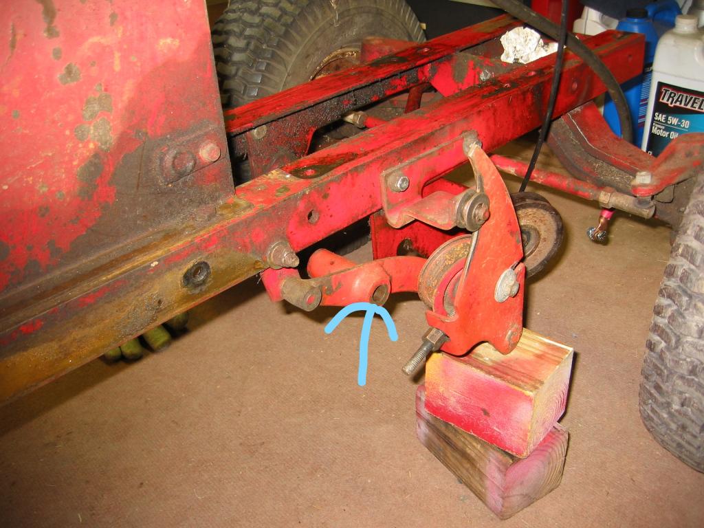

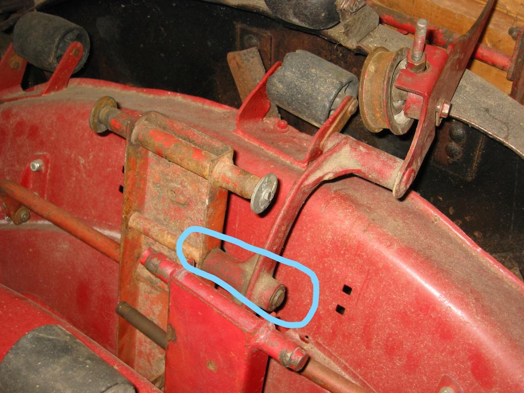

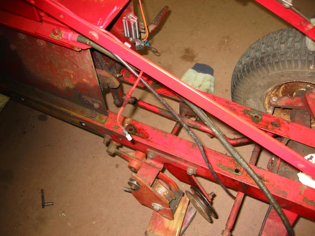

Treepep 1,148 #47 Posted January 8, 2020 I picked these two today and now I am more confused. The one is basically the same as that I have. The other??? Obviously a tensioner but I cant see how it would have mounted. Any thoughts? Or does anyone have any closer pictures of the original setup/pto deck belt route? Many thanks Share this post Link to post Share on other sites
Pullstart 70,885 #48 Posted January 8, 2020 1 hour ago, Treepep said: I picked these two today and now I am more confused. The one is basically the same as that I have. The other??? Obviously a tensioner but I cant see how it would have mounted. Any thoughts? Or does anyone have any closer pictures of the original setup/pto deck belt route? Many thanks These are on Rylee’s “Filly” 1076. Click on the link, there’s a picture in there you might be able to use. Share this post Link to post Share on other sites
pfrederi 20,933 #49 Posted January 8, 2020 Ok it is 21 degrees 20mph wind blowing the snow around This isn't mower deck season.. I have not mounted it on the GT14 but pictures here should help. The pivot (blue arrow) slides on the stub shaft of the deck, blue circle, 1 Share this post Link to post Share on other sites
Treepep 1,148 #50 Posted January 8, 2020 Thanks again pfrederi. I wondered what that silly little pulley was for. It may work if I find a gt deck. .I don't know if all years interchange? It wont work with this 1976 deck without some fabricating I am not qualified for. Share this post Link to post Share on other sites
