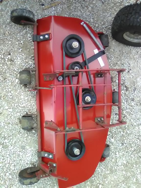

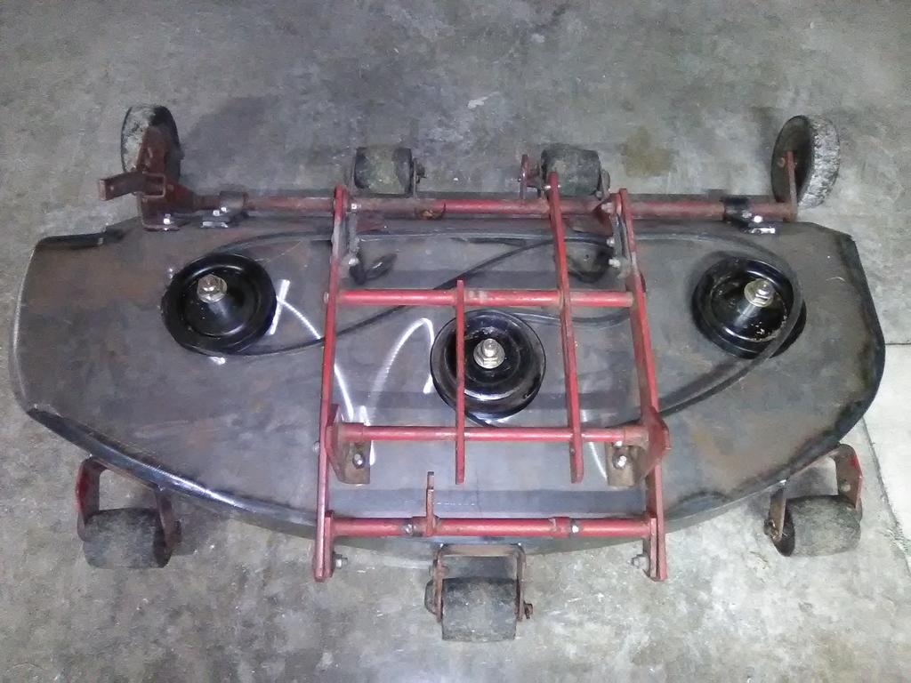

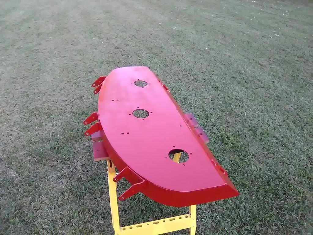

654jim 61 #1 Posted September 25, 2019 Finished the deck build I "mentioned" in another thread! Thought I'd wrap it up here. To recap, I had a friend cnc plasma cut, and weld up a shell. I replaced my original spindles with aftermarket , replacements for CubCadet 1045-1046 deck. Had to fab up the center DRIVE pulley, and modify the Tensioner design. Cut 1/2 acre of grass today,, Looks to be a success!!! 6 10 1 1 Share this post Link to post Share on other sites

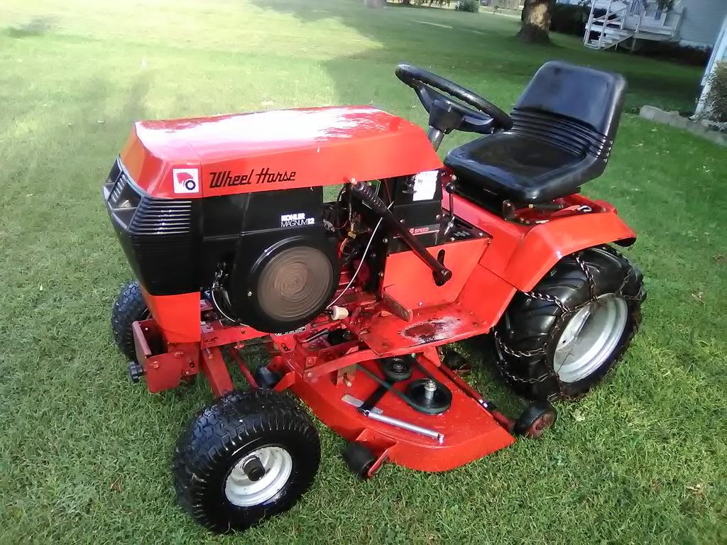

654jim 61 #2 Posted September 25, 2019 1990 312-8, with 607 hrs. Any guesses to the "HRS" left in the ole girl??? 8 7 Share this post Link to post Share on other sites

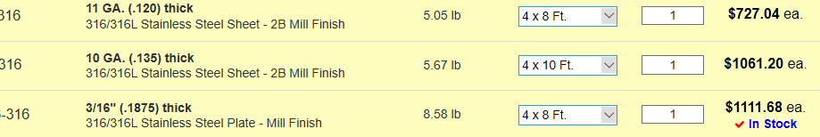

daveoman1966 3,884 #7 Posted September 25, 2019 The deck shell.... Would SS been that much more expensive to use than cold roll? SS would, or course, last FOREVER and never rust out. In 1992 or so, I cut out a cardboard template to make a SS liner for my 48" deck and it shown no sign of degrading. The original outer steel shell has also held up well since the acidic grass cutting never get at the steel to rust / corrode it. 1 Share this post Link to post Share on other sites

peter lena 10,013 #9 Posted September 25, 2019 654jim , terrific work on that Jim ! i was glad to see the integration of ideas , past and future in your make up , i have found that a regular oil spray down on the underside ,not only feeds the metal , but kills off the grunge. the other thing i have done on my decks is to add an idler pulley on the long unsupported back side of the deck belt, in your 4 th picture you can clearly see the area. picture a idler pulley line ,directly under the drive line pulley lightly pushing up toward the drive pulley , that has really smoothed out my belt drive. pulley is pushing belt up from the lower outside edge. stay after the lever height linkage , regularly lubricate it , for smooth and easy lift. i like your work , wish you were closer , to swap ideas and improvements , pete Share this post Link to post Share on other sites

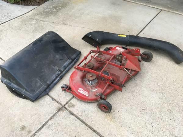

WHX?? 57,761 #13 Posted September 25, 2019 Just the opposite here fellas. Decent used ones come up all the time on CL. Well I shouldn't say decent cause I don't ever go look at them. I have so many decks I can't even remember which tractor they came off from! They go cheap because they only work on a horse and the tractor probably was sold or scrapped without it. Here's the 38 for 50 clams. Probably does need some TLC tho. 1 Share this post Link to post Share on other sites

654jim 61 #17 Posted September 27, 2019 On 9/24/2019 at 10:13 PM, daveoman1966 said: The deck shell.... Would SS been that much more expensive to use than cold roll? SS would, or course, last FOREVER and never rust out. In 1992 or so, I cut out a cardboard template to make a SS liner for my 48" deck and it shown no sign of degrading. The original outer steel shell has also held up well since the acidic grass cutting never get at the steel to rust / corrode it. cold rolled steel is $5 sq.ft. Stainless is around $20, plus my friend says increase welding costs. Share this post Link to post Share on other sites
654jim 61 #18 Posted September 27, 2019 7 hours ago, mrc said: awesome work 654jim! the spindles you bought seem very inexpensive. i know squat about cubs. newer cub stuff or older cub stuff? how come so cheap? as our decks age we will have to resort to this type of ingenuity. thanks for posting. mike in mass. They are 'china' replacements, not OEM CubCadet!! Time will tell!!!! Share this post Link to post Share on other sites
daveoman1966 3,884 #19 Posted September 27, 2019 3 hours ago, 654jim said: cold rolled steel is $5 sq.ft. Stainless is around $20, plus my friend says increase welding costs. Reeeaaallly.....Stainless Steel is $20 per square foot????? Share this post Link to post Share on other sites
654jim 61 #20 Posted September 28, 2019 'NET search says so! Share this post Link to post Share on other sites
daveoman1966 3,884 #21 Posted September 28, 2019 (edited) 1 hour ago, 654jim said: 'NET search says so! Jeeeesus .... r u kidding me. Edited September 28, 2019 by daveoman1966 1 Share this post Link to post Share on other sites

654jim 61 #24 Posted September 29, 2019 its 10Ga.. .135" cold rolled steel. Feels pretty substantial Maybe go to 8ga top if your building a 48"..with 10 ga sides.. Friend says he's swamped at the shop... not really interested in "mass producing" anything! I think he likes to challenge of one-offs....something new everyday! Share this post Link to post Share on other sites
