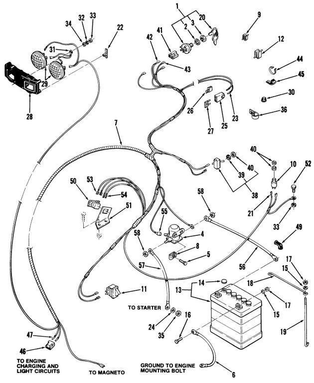

MAWHguy2019 23 #1 Posted September 24, 2019 Hi guys, Was running the B-85 (which was running great) and turned it off to empty the bagger. Once I jumped back on and tried to start, I could not even get it to click over. Nothing. Yes, I had plenty of gas. Changed the battery and spark plug. The fuse looks suspect so I will be changing that tomorrow. If it is not that, any suggestions? Share this post Link to post Share on other sites
rjg854 13,156 #2 Posted September 24, 2019 Any safety switches? Share this post Link to post Share on other sites
gwest_ca-(File Mod) 12,323 #3 Posted September 24, 2019 1/2 of the pto switch and the clutch pedal switch control the starter. Garry 1 Share this post Link to post Share on other sites
MAWHguy2019 23 #4 Posted September 24, 2019 No safety switches that I can see. Was thinking it could be the pedal switch. It was strange. Was running like a top before I shut it off. No issues with shutdown that I could tell. Will replace the fuse and keep you all posted. Share this post Link to post Share on other sites
gwest_ca-(File Mod) 12,323 #6 Posted September 25, 2019 50 is the pto switch 11 is the clutch pedal switch Garry Share this post Link to post Share on other sites
