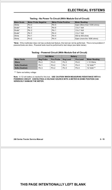

Ks265H 1 #1 Posted September 24, 2019 Hello Folks! I have been reading through this site for quite some time and it has been an enormous help. Thank you to all! I have a 265h (mod# 72050) year 2000, with a Kohler CV15s engine. I can not get it to crank when turning the key. I have gone through all safety switches, wires and grounds. The original NMIR switch (“no mow in reverse”) was not testing properly whether energized or not, so I ordered a new one. I popped it in and STILL NOTHING. I tested the new module with my multimeter and I feel I am not getting the proper readings. So they may have sent me a faulty module. So I guess my first question would be if this brand new module is broken, would this cause my engine not to crank over? When I turn the key, I do get clicking in both of the relays. With the testing of the new NMIR switch, my battery alone is reading 12.48 volts. I use this same battery to energize the switch and the meter shows only 11.00 volts going through it. The 260 Series Service Manuel says voltage should be the same as battery. Below I included screenshots of the electric portion of the service manual. Any help would be greatly appreciated!! Share this post Link to post Share on other sites

Ks265H 1 #7 Posted September 24, 2019 On my multimeter the 12 V mark is next to the continuity alarm. At first I had it set to measuring continuity instead of voltage. Noticed that separately testing the green and orange wires, both will sound off the continuity alarm. I am definitely not an electrician or a mechanic by trade either. I’ve been doing a lot of poking around trying to figure out what I am dealing with here. Voltage of orange wire is .011 and voltage of green wire shows exactly the same 0.011. I do have extra relays on hand and they all test out that they are working properly. I put a new relay in there just for the heck of it. I get the same readings. How should I test the grounding of the relay? And for your help and input! Share this post Link to post Share on other sites
