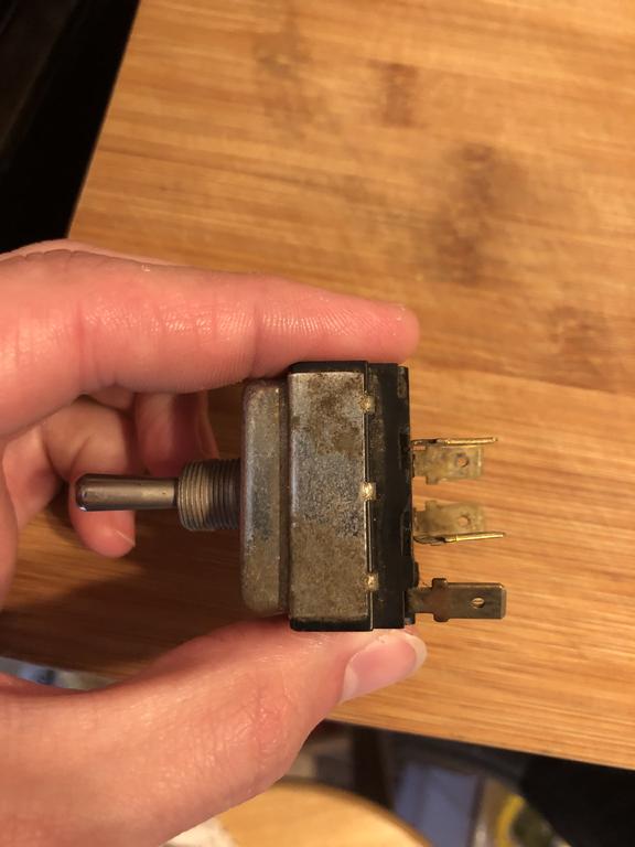

Skmastaz 0 #3 Posted September 23, 2019 This is the PTO switch. Share this post Link to post Share on other sites

WHX?? 58,225 #5 Posted September 23, 2019 (edited) Wow that is a morph guy. Did find a manual with wiring diagram if that helps. I had though it might be similar to my 246H but not even close. Almost looks like a triple pole switch throw switch but not quite. Did you try to read through the contacts with an ohmmeter? BTW Edit here IPL shows it as a 113178 PTO switch. A quick google shows it on fleabay,.... hope your sitting down when you see the price. https://www.ebay.com/itm/TORO-WHEEL-HORSE-PTO-SWITCH-PART-78-3030-OEM-NEW-200-SERIES-TRACTORS/202768978479?epid=1137144425&hash=item2f35f9122f:g:I6QAAOSwD5Bc8RaG I would be damn certain that's the problem before pulling the trigger on that one. A-Z tractors may have a good used one, wouldn't hurt to call him. Parts tree may have them as well. The IPL is here as well if you need it. I am guessing a more common 3 pole single throw switch would work after looking at the wiring diagram. Double check the 15 amp fuse running the clutch as well as it's fuse holder. Check the plug connections to the switch. Electric clutches are known to power hungry and bad connections can melt wiring. It appears you do not have the kill relays but two other tractor functions go thru that switch. Edited September 23, 2019 by WHX24 Share this post Link to post Share on other sites

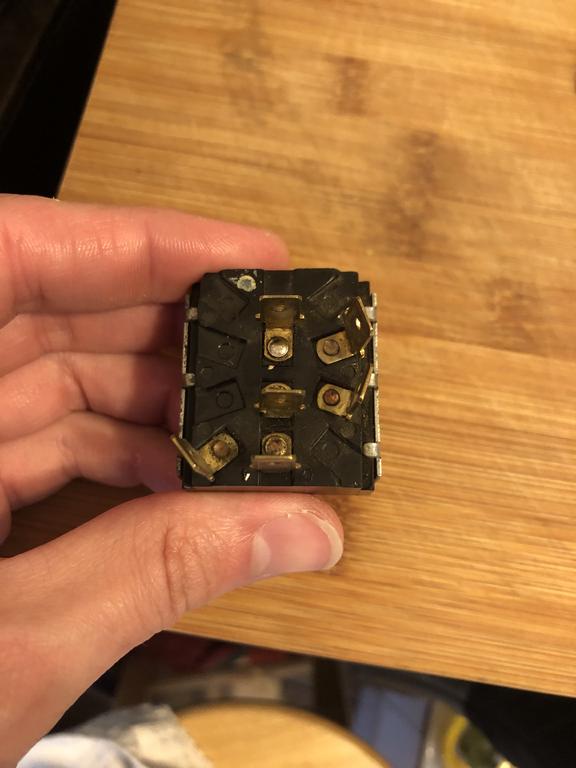

gwest_ca-(File Mod) 12,489 #7 Posted September 23, 2019 Share this post Link to post Share on other sites
gwest_ca-(File Mod) 12,489 #8 Posted September 23, 2019 There are 6 terminals. Are there also 6 wires? Garry Share this post Link to post Share on other sites

gwest_ca-(File Mod) 12,489 #10 Posted September 24, 2019 If we can believe the wiring diagram the pto switch controls 3 circuits. 2 circuits are NO (Normally open) 1 circuit is NC (Normally closed) Normally is when the switch is in the OFF position. The status of each circuit in the ON position will change. Should be easy to determine the condition of the switch. Found many pto switches available at a Stens dealer but can not link you to them. Go here https://www.bantasaw.com/ Do a search using pto switch The ones at the top of the list are toggle like this one but no indication of how they function.. Many are push/pull and show how they function. Seems they are universal. Garry Share this post Link to post Share on other sites
