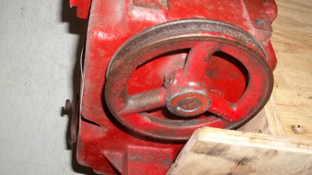

953 nut 63,633 #6 Posted September 23, 2019 9 hours ago, Chris G said: The original one is gone and I want to replace the cheap aftermarket one. If you don't use a cast iron or cast steel pulley the cheap ones won't hold up. I can get you the measurements and a photo this afternoon. 1 Share this post Link to post Share on other sites
gwest_ca-(File Mod) 11,932 #7 Posted September 23, 2019 2707 pulley used on 953, 1054 and 1054A transmissions, ST-376, 6-1211 and 6-9111 snowthrowers Garry 1 Share this post Link to post Share on other sites
953 nut 63,633 #8 Posted September 23, 2019 The pulley is 6" OD and has a 3/4" hole. 1 Share this post Link to post Share on other sites
