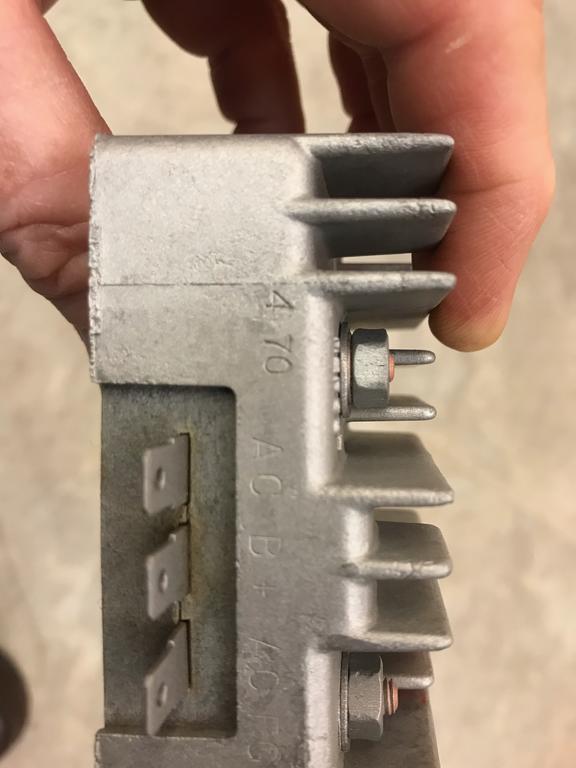

McGrew 461 #9 Posted September 22, 2019 Okay... Garry, Than answers the question of which regulator I have. Mine is the 10 amp variety, and I believe the regulator is original to the tractor. My Dad bought this tractor new in 1971, and I don’t think the regulator was ever changed. But... Always a “but”, right? My brother put a 14 HP HH140 in this tractor about 24 years ago. If the new engine had the 20 amp stator, I’m guessing we might have fried the regulator? But keep in mind, this thing worked for the last 24 years.... Maybe I have the correct 10 amp stator... I need to do more research. Danny Share this post Link to post Share on other sites

McGrew 461 #11 Posted September 22, 2019 Okay guys, thanks for all the suggestions. I went through the diagnostics on the service manual Garry supplied. I only get a little over 5 VDC on the DC output of the regulator. All connections are good. I get 24VAC from the stator. The service manual says this is good. Soooo,,, the regulator is bad. I just ordered one from Ebay. It should be here Friday. It replaces the Tecumseh 610749, so I have my fingers crossed it fits... Thanks again! Danny 1 Share this post Link to post Share on other sites

McGrew 461 #13 Posted September 25, 2019 Nobody has any thoughts or ideas? Do I smell bad? Did I make you guys mad? I hope not! On a sorta related subject, do you think I should send a complaint letter to the manufacturer of the voltage regulator? It is stamped REPCO, and has a date of 4-70 on it. It only lasted 49 years! Tractor is a 1971, so I am guessing it is the original. Danny Share this post Link to post Share on other sites
