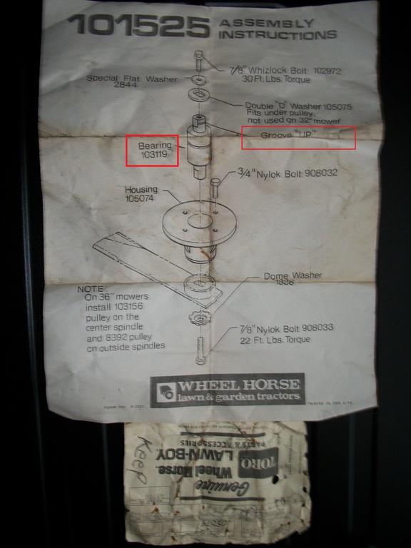

daveoman1966 3,884 #2 Posted September 20, 2019 You don't. When they go bad, buy replacement bearings # 103119 for about $25 each on Ebay...or sometimes $60 for a set of three. Just press out the old bearing and press a new one in its place. 3 1 Share this post Link to post Share on other sites

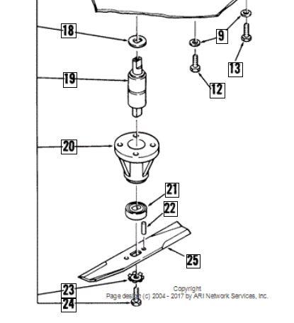

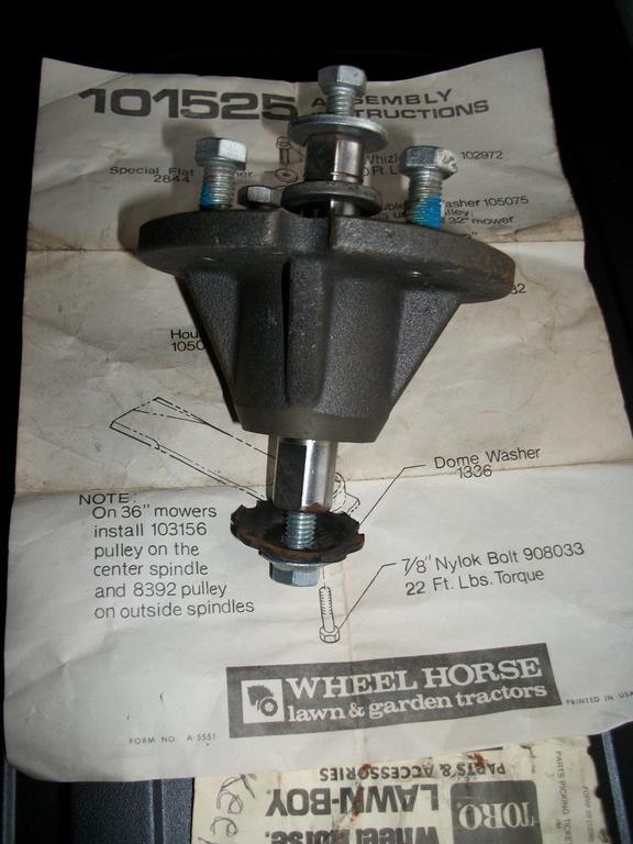

Rich16 44 #3 Posted September 29, 2019 Does anyone know where you can get 48" blades for these? Also some spindle replacement help. I just got a ?mid 70's? 48" deck that seems to be a 'Double D' style while picking up some original wheel weights and he was cleaning out the shed. It surprisingly looked like it'd fit my newer 416-8 and 520H (he said it would) though I was a bit skeptical - but no more! Works great and fits perfectly. There are several replacement spindle bearings on eBay/Amazon for these and I downloaded the guide but wow - they are confusing and all look similar. Many of the newer complete replacement spindles are easily available (gotten three) - anyone know where you can get these complete? I'm not sure exactly what I have except it's a 48" - it has the solid cover over the top of pulleys but otherwise looks similar to the later ones and again fits just fine. Share this post Link to post Share on other sites
