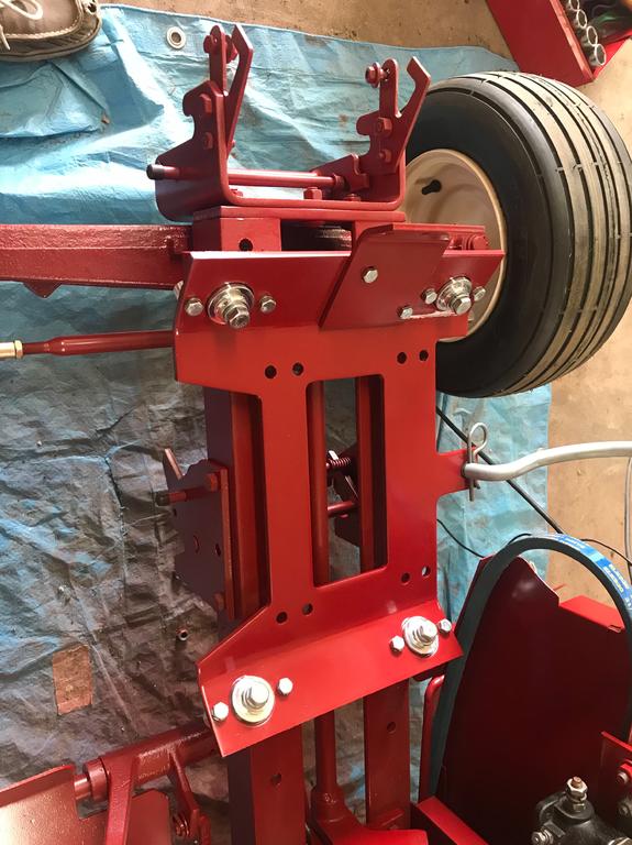

redone 45 #10 Posted May 24, 2022 Guys. I am asking about the stops on those front mount brackets to keep the hood from falling forward to the ground. from what i see in these photos, mine looks the same. so what aim i missing? I have two 105. the same. thanks for your help. nice work on the shaker plate Share this post Link to post Share on other sites
