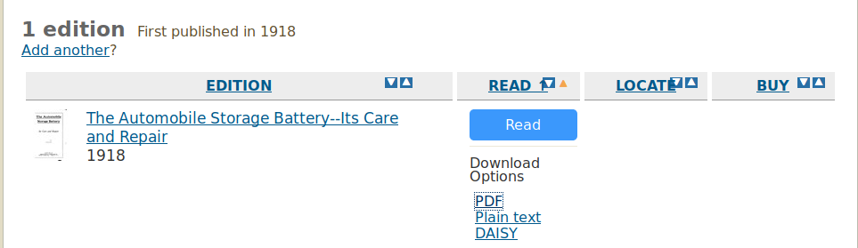

bc.gold 3,406 #2 Posted September 18, 2019 Here's a very old book for EB https://openlibrary.org/works/OL19567465W/The_Automobile_Storage_Battery--Its_Care_and_Repair Share this post Link to post Share on other sites

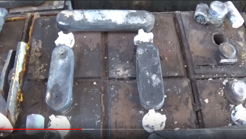

bc.gold 3,406 #3 Posted September 18, 2019 Eb the lead buss bars are drilled through only above the cell post, drill the thickness of the buss bar no deeper. Once the errant cell has been repaired or replaced you'll reuse the buss. by burning it back onto the post. 1 Share this post Link to post Share on other sites
bc.gold 3,406 #4 Posted September 18, 2019 2 hours ago, bcgold said: Here's a very old book for EB https://openlibrary.org/works/OL19567465W/The_Automobile_Storage_Battery--Its_Care_and_Repair I downloaded the book from openlibrary and have been reading it, very informative. Best of all its written in plain old English. Share this post Link to post Share on other sites
