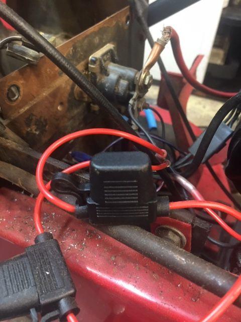

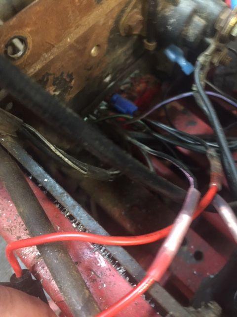

Lagersolut 793 #29 Posted September 29, 2019 Thanks for all the great ideas - haven't had much time to work on this tractor but I did get the new head gasket on . Got the engine running and it shut off, turned the key nothing not even the starter. .....ended up chasing wires with the multi meter . Found the problem at the 15 and 5 amp fuse holders and inline connectors - 35 years of dirt and corrosion - was already planning on replacing, had new holders ....wasn't expecting it to throw me into a wire chasing party . ....went with these sealed holders and shrink tube sealed connectors few other connections upgraded . Also new points , plug , condenser plug wire cleaned carb on the engine . Ran like a champ after wiring work . 3 2 Share this post Link to post Share on other sites

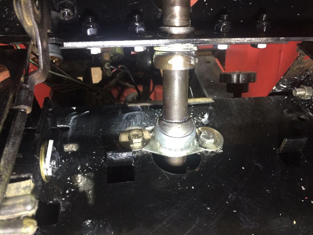

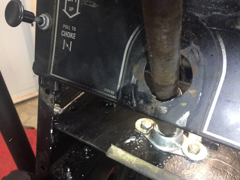

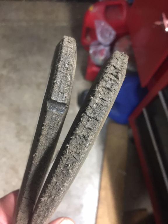

Lagersolut 793 #31 Posted October 9, 2019 Finally got the steering shaft back where in belongs, dash reinforced and a flange bearing installed so the top of the dash/hood stand isn't taking all the stress. I was originally going to weld and reinforce the crack but in the end it would have burned the dash decals and just made more work . Used a piece of 2" x 1/8 " flat steel to reinforce the dash and new bushing. Previous owner of this tractor was using the steering wheel and PTO lever to get on and off , bottom of dash where steering shaft comes through was cracked all the way through and mushrooming. Drive belt was IMHO the original from new, I could flake the material off the cords like an ear of corn . New nylon bushings in the PTO lever everything is back to tight and right . 1 Share this post Link to post Share on other sites

peter lena 9,789 #35 Posted October 12, 2019 steering flange bearing,https://www.vxb.com/3-4-UCFL204-12-2-Bolts-Flanged-Housing-Mounted-p/Kit7334.htm?gclid=Cj0KCQjw84XtBRDWARIsAAU1aM2to4lRIIwz9xeBYEpk66PwxVCTOSxKFi19BR6g52eYEoFfm-6onZYaAgsVEALw_wcB , this the type of bearing you want, not the same shell type of mount that was there. there are also side bolt mounts to the lower dash that you can bolt an angle steel to ,as the basis for the flange bearing. instead of being one of the weakest support points , you can make it , one of the strongest. jmoo , pete 1 Share this post Link to post Share on other sites
