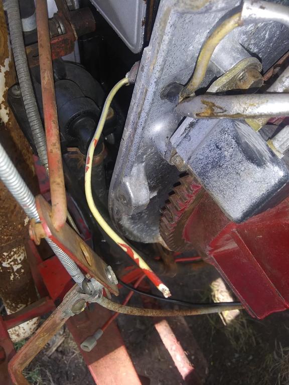

upstate yank 219 #1 Posted September 17, 2019 well guys i am back for another issue i have;it seems i have removed the shroud so many times i should know but there is a wire that runs off the unit to the fly wheel that came off and i really do not know where it ties in to ;so any help sure would be appreciated ;again thanks everyone boy it is tough getting old and forget full Share this post Link to post Share on other sites
pfrederi 21,183 #2 Posted September 17, 2019 Goes to teh A terminal on the trigger. The manual has a good picture of the wireing. 1 1 Share this post Link to post Share on other sites
upstate yank 219 #3 Posted September 17, 2019 1 hour ago, pfrederi said: Goes to teh A terminal on the trigger. The manual has a good picture of the wireing. thanks but there is already a wire there for the trigger ;i need to down load the manual Share this post Link to post Share on other sites
pfrederi 21,183 #4 Posted September 17, 2019 There should be 2 wires that come out from behind the engine end plate One is for the head lights one for the ignition trigger Do not mix them up. The wire on the I terminal of the trigger goes to the coil and has another wire piggy backed on it, that is the kill wire that goes to the ignition switch 1 Share this post Link to post Share on other sites
upstate yank 219 #5 Posted September 17, 2019 29 minutes ago, pfrederi said: There should be 2 wires that come out from behind the engine end plate One is for the head lights one for the ignition trigger Do not mix them up. The wire on the I terminal of the trigger goes to the coil and has another wire piggy backed on it, that is the kill wire that goes to the ignition switch thanks so much and now i do recall the one wire is piggy backed in to the connector that goes to the trigger just as you mentioned ;yep the headlight wire is red which i followed ;the one in the picture is white which goes to the unit on the fly wheel' again getting old and forget full doesn't help the old brain is just loosing it hehehe thanks again now to figure out why the lighter;headlight switch and clutch switch doesn't work as they did yesterday but that right now isn't a big issue ;it is getting this engine to run ;no spark off the plug but current to the trigger wire ' i had a member send me a trigger plus i am going to try the one that came with it now that i have this figured out plus current to the connector at the end where it plugs in to the trigger ; Share this post Link to post Share on other sites
