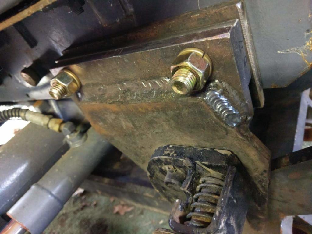

WVHillbilly520H 10,379 #81 Posted September 19, 2019 20 minutes ago, 953 nut said: You did very well. Grab a stack of scrap metal pieces and start burning rods sticking them together. Welding is an art and the only way you become better is practice! Yep just like these... 3 Share this post Link to post Share on other sites

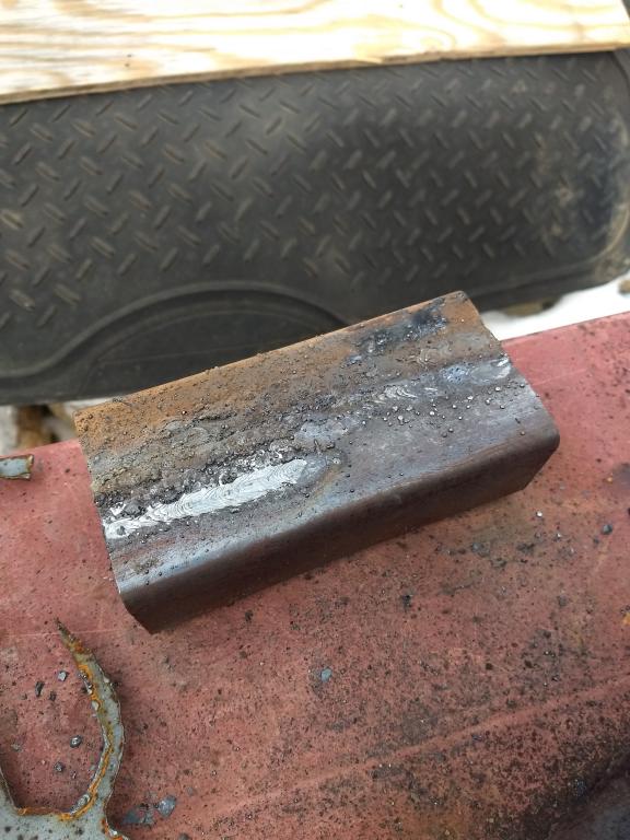

bc.gold 3,406 #84 Posted September 19, 2019 On this weld I would have beveled the inside for my first pass. Share this post Link to post Share on other sites

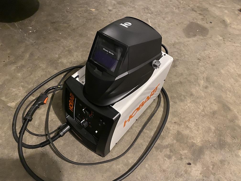

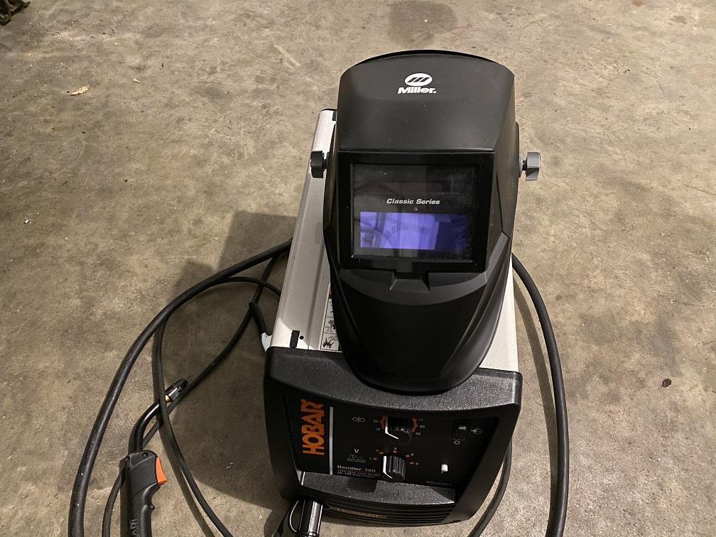

CCW 1,516 #97 Posted December 1, 2019 This has been a great thread. Have done both stick and mig and was considering a Lincoln stick welder. Reading has convinced me I need a flux core with the ability to covert to gas if I want to. Most of my welding will be outside where only 120 is available and wind can be a factor. Hence the flux core. Right now I am looking at a Hobart 140 flux core/mig with auto dimming Miller helmet for $450. Bit more research to do. 1 Share this post Link to post Share on other sites
CCW 1,516 #98 Posted December 7, 2019 Made the purchase. Hobart 140HD MIG / Fluxcore. 1 Share this post Link to post Share on other sites

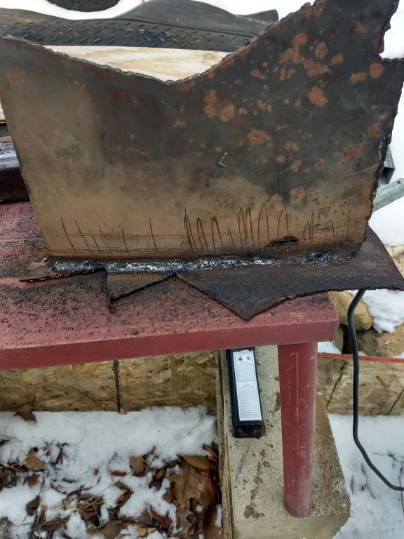

ebinmaine 80,131 #99 Posted December 8, 2019 On 11/9/2019 at 9:26 AM, MrOiluj52 said: Hey EB you weld anything yet? FINALLY.... Got to spend a few minutes cookin rods. Note... I didn't write welding... No worries.... Messed around with a couple different types. 6011 5/32 6013 1/16 Welder itself seems to do well. I'll figure it out as I go... Share this post Link to post Share on other sites
wallfish 20,404 #100 Posted December 8, 2019 Woo Hoo, there's no limits now. Practice Practice Practice Get yourself a slag hammer to knock it off if you don't have one. COVER YOUR EYES as that crap is brutal on the eyeballs since it's sharp! And hot if you chip it off quick enough. Pay attention to the puddle as you move the stick. Sometimes easy to loose if you try to go too fast. Be sure to grind the edges or faces of the metal you are welding as clean metal is much easier to get a good bead with good penetration. A bead may look good from the surface but without the penetration it will be weak. Wait until you try vertical and or overhead welding, that takes some patience. https://www.ebay.com/itm/392269613976 1 Share this post Link to post Share on other sites
