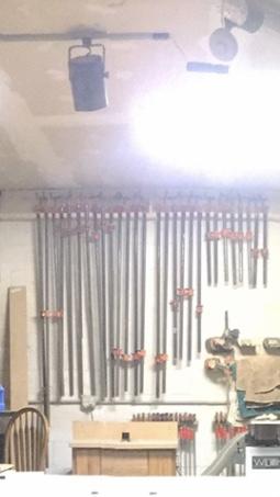

pfrederi 21,305 #23 Posted September 16, 2019 Norm Abrams says a woodworker can never have too many clamps. For those of us who work on tractors big and small you can never have enough Bearing, flange, gear, etc pullers... Get the set above now and start your collection. 1 Share this post Link to post Share on other sites

The Tuul Crib 7,354 #25 Posted September 17, 2019 16 hours ago, pfrederi said: Norm Abrams says a woodworker can never have too many clamps. For those of us who work on tractors big and small you can never have enough Bearing, flange, gear, etc pullers... Get the set above now and start your collection. Norm speaks the truth I still don't have enough ! 1 1 Share this post Link to post Share on other sites
