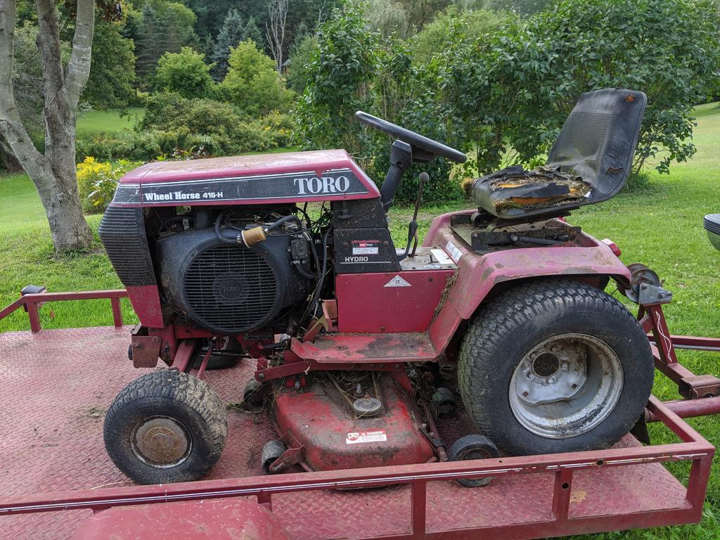

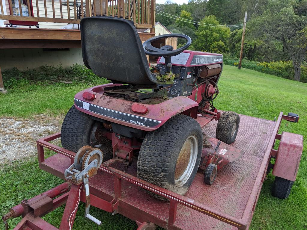

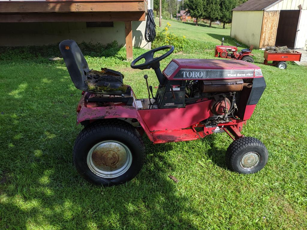

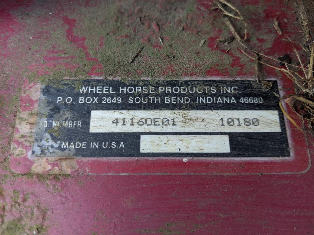

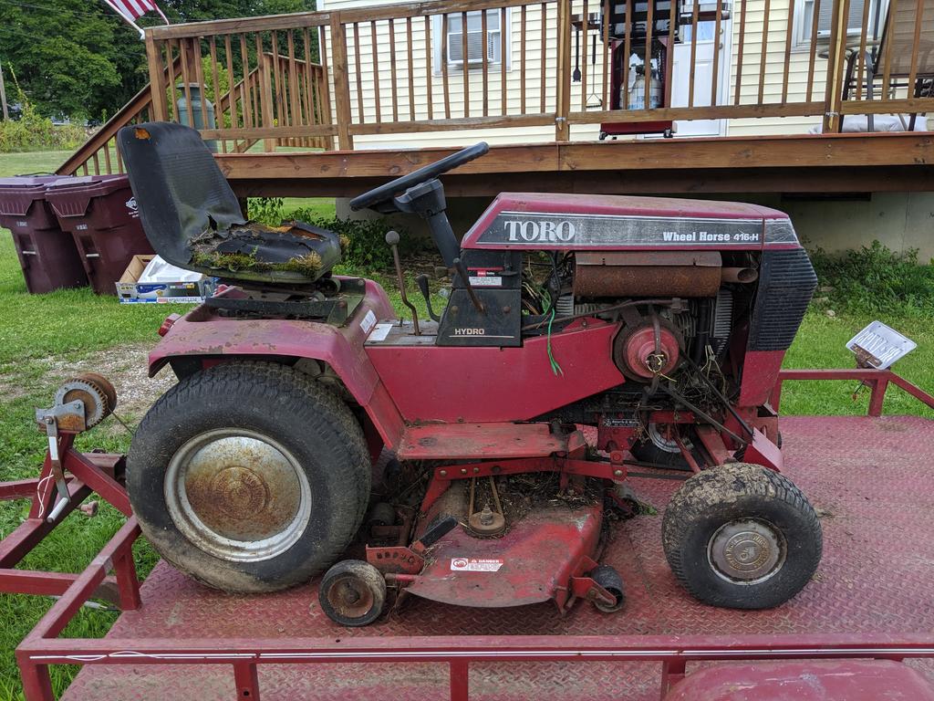

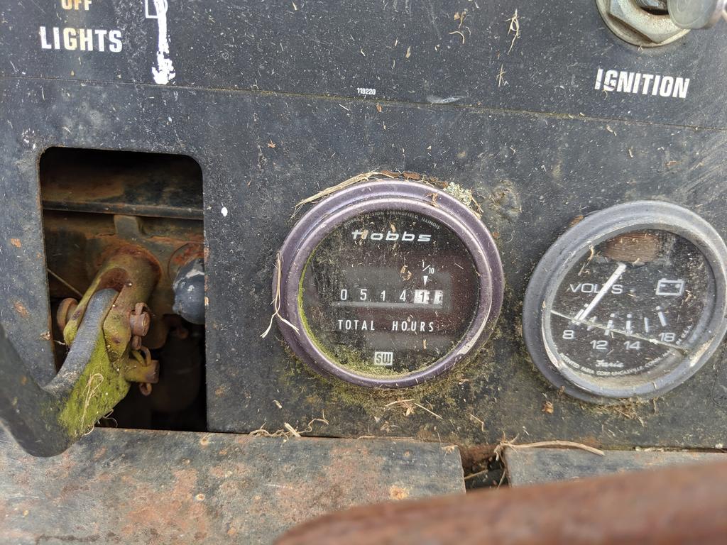

WildmanC120 613 #1 Posted September 15, 2019 Just saved this from someones yard where it has sat for the last 5 years or so I was told. I guess when it would get damp it would intermittent lose spark then one day lost spark all together. As you can see it was pretty disgusting but 30 minutes with the pressure washer and she cleaned up OK. That seat is a lost cause so I didnt even bother. It's going right in the trash. As you can see the engine is very clean and doesn't appear to be jammed full of grass so I'm hoping that its just a diagnose the spark issue, clean carb and run some new fuel line and we end up with a nice runner. Oil actually looks pretty decent too. Hoping the hour meter works and that 514 is correct. Anyone know what year this one is? 14 4 1 Share this post Link to post Share on other sites

stevasaurus 23,617 #3 Posted September 15, 2019 Looks like it is a 1990 416H Automatic. Nice find. 1 Share this post Link to post Share on other sites

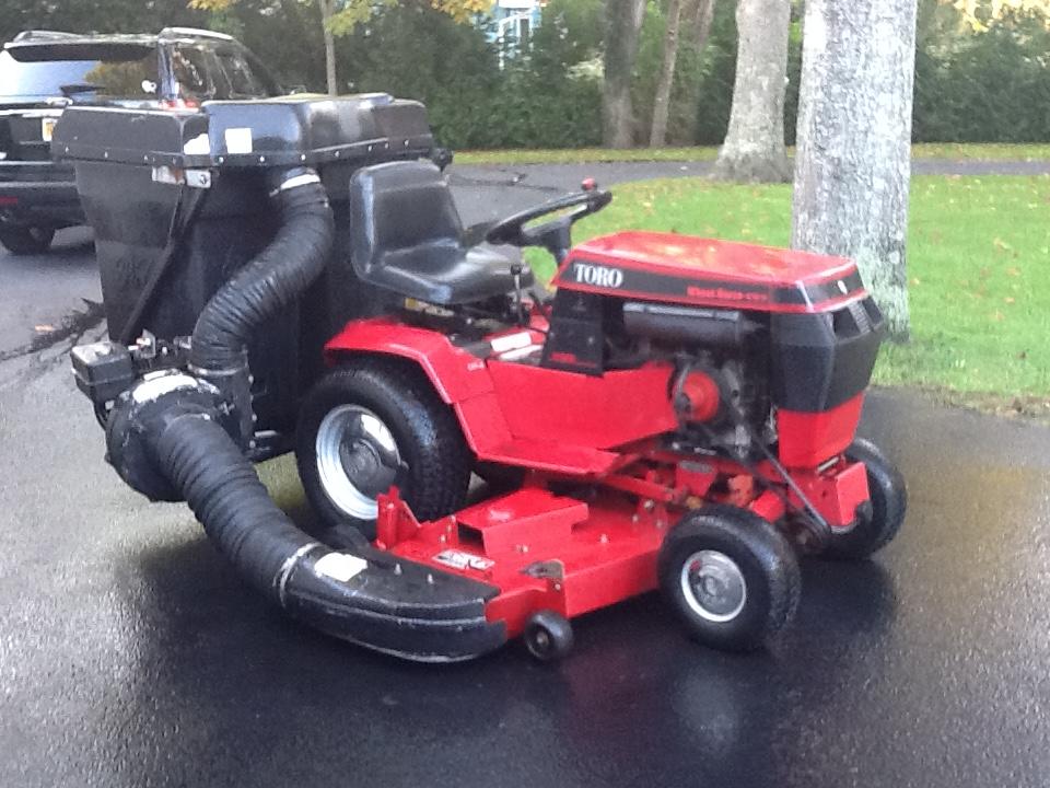

AMC RULES 37,254 #4 Posted September 15, 2019 Here you go... 1 1 Share this post Link to post Share on other sites
WildmanC120 613 #5 Posted September 15, 2019 4 minutes ago, stevasaurus said: Looks like it is a 1990 416H Automatic. Nice find. Nice. Thanks 1 Share this post Link to post Share on other sites

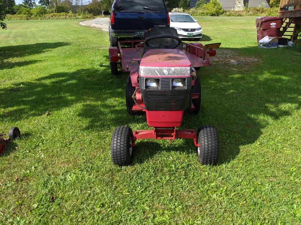

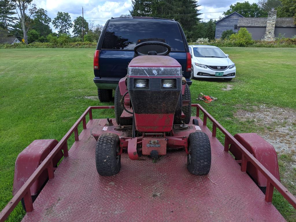

WildmanC120 613 #7 Posted September 15, 2019 Well...I put a battery in it and it had spark. So I got froggy and popped the top off the carb and cleaned it on the tractor, hooked up an aux tank and wouldn't you know...she runs like brand new. I'm so stoked right now!!!! Even drives too. 416-h running and driving 3 9 Share this post Link to post Share on other sites
