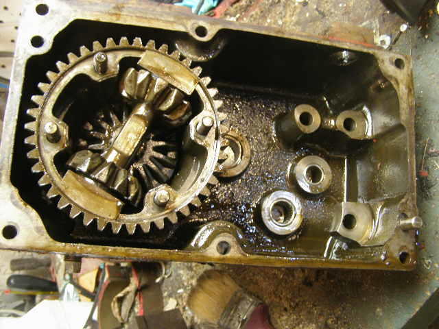

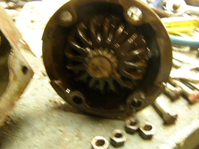

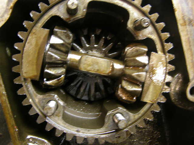

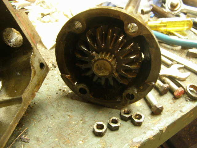

KROB 1 #1 Posted September 15, 2019 (edited) My 1054 suddenly stopped pulling my small trailer. Checked all the obvious keys and shaft movement and determined the problem to be internal. Jacked the rear end and ran the tractor in gear. Tractor wheels turned but could be stopped by gently pushing on the tire. Pulled the tranny and opened it up. The inside components all look brand new with very little evidence of wear. Found the differential to be the issue. Held one axle and turned the other freely. Opened the 4 nuts on the differential expecting to see the issue. All gears look perfect. No idea why there is no connection between the two axles. Anyone with any ideas? Edited September 15, 2019 by KROB typos Share this post Link to post Share on other sites
953 nut 64,281 #2 Posted September 15, 2019 4 hours ago, KROB said: Found the differential to be the issue. Held one axle and turned the other freely. You were able to turn one axle without the other axle or the differential bull gear turning, is that right? Do you have a broken axle? In your pictures the Left axle is not out of the transmission, has it been inspected? 4 hours ago, KROB said: Jacked the rear end and ran the tractor in gear. Tractor wheels turned but could be stopped by gently pushing on the tire. Reading this statement my first thought was that the input pulley that drives the transmission may have lost a key and was spinning on the shaft though that is uncommon. When you stopped one wheel did the one on the other side continue turning? Was it the same on both sides? 1 Share this post Link to post Share on other sites
stevasaurus 23,620 #3 Posted September 15, 2019 I'm looking at your pictures and I do not see anything wrong. Depending on how you explained some of the things you tried, that is exactly what is supposed to happen. The differential gears look brand new. Maybe bolt that differential back together...if you then turn one axle, the other should turn in the opposite direction. If you are just holding the differential in your hands...not in the trans case...turning one of the axles will turn the other one in the opposite direction, and you will not be able to hold one from turning. If this is true, your differential is fine. If the differential is in the trans case and you are turning the trans from the input shaft, then you can hold one of the axles and the other will turn. This is what a differential does. I'm thinking Richard is correct about the input shaft key...if both of the wheel hub keys were OK. Don't forget...you have a key on the engine drive pulley also. BTW...welcome to Red Square. 1 Share this post Link to post Share on other sites

stevasaurus 23,620 #8 Posted September 17, 2019 It seems like you are saying...when holding a bolted together differential and turning one of the axles, the other one does not turn. ?? That can only mean, if the axles are not broke, the gears are not meshing inside the differential. Down load the OM IPL in the first manual...and the pages in the big manual. You should have thrust washers on the back side of the axle gears. With the differential open, try turning the one axle and see if the teeth mesh with the pinions...the axle gear must turn those gears or we need to find out why. Pay attention to what the manual says about the long and short axles and the long and short end plates and having the bolts or bolt holes facing in a certain direction...and which axle goes into the shallow side of the transmission case. In this manual, look at page 22 for directions and pages 25 & 26 for picture and parts list. 1 Share this post Link to post Share on other sites

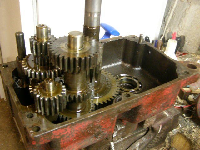

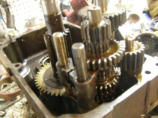

19richie66 17,819 #10 Posted September 21, 2019 Bearing maybe out of place, keyway not lining up, gear not meshing or sitting on shaft correctly. Too small of a hammer 1 Share this post Link to post Share on other sites
stevasaurus 23,620 #11 Posted September 21, 2019 Do not hit it with a hammer. Lift the 1/2 case back off and make sure all shafts are all of the way down and standing straight. Most times it just takes a little wiggling of the case to get it to fall the rest of the way. Just wiggle and twist gently. When you do get it back together, test in all gears by turning the input shaft counter clock-wise. One axle will turn for sure, but you may see both axles turn just because it wants to. Share this post Link to post Share on other sites
19richie66 17,819 #12 Posted September 21, 2019 Just kiddin’ Steve 1 Share this post Link to post Share on other sites
953 nut 64,281 #13 Posted September 21, 2019 5 hours ago, KROB said: Case stops about 1/2 inch from meeting. Any idea what may be out of place? Could be the alignment pins are not quite lined up. give a little wiggle and turn the input or brake shaft as you do it. 1 Share this post Link to post Share on other sites
