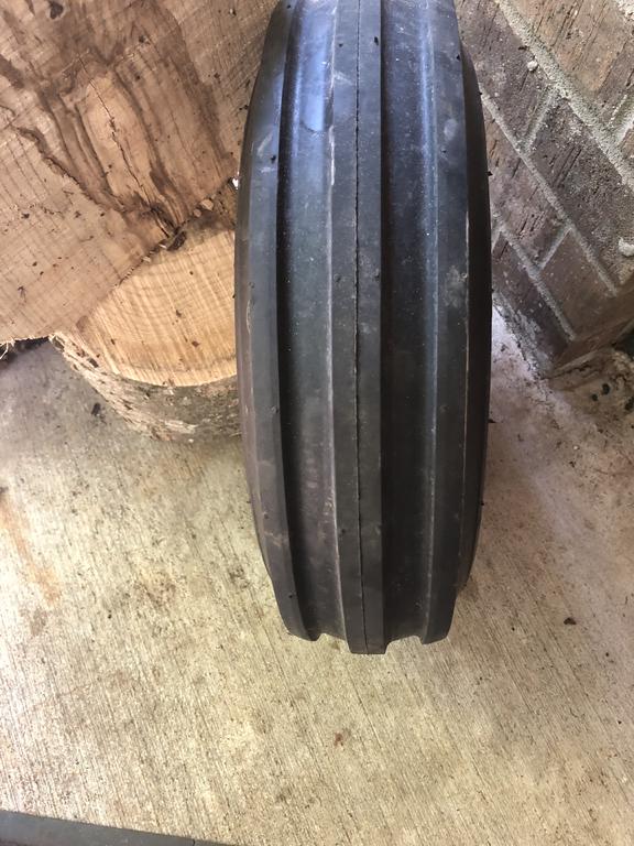

"Manic-Mechanic" 1,486 #7 Posted September 15, 2019 7 hours ago, RandyLittrell said: If you save that pic and blow it up, you can see its not a picture of 4.80-8 tires. They 12 or 15's, I couldn't tell. 4.80-8's will fit what you want with tubes I'm pretty sure. Randy I grabbed the picture on the e bay ad without even looking closer, good eye! Here is a more appropriate representation: 1 Share this post Link to post Share on other sites
RandyLittrell 3,946 #8 Posted September 15, 2019 1 minute ago, oldman said: I grabbed the picture on the e bay ad without even looking closer, good eye! Here is a more appropriate representation: I have bought quite a few pairs of them and thought they looked way too skinny. With tubes, I think you could spread them out on 6" wide rims. I think WH wide rims are narrower than 6" Randy 1 Share this post Link to post Share on other sites

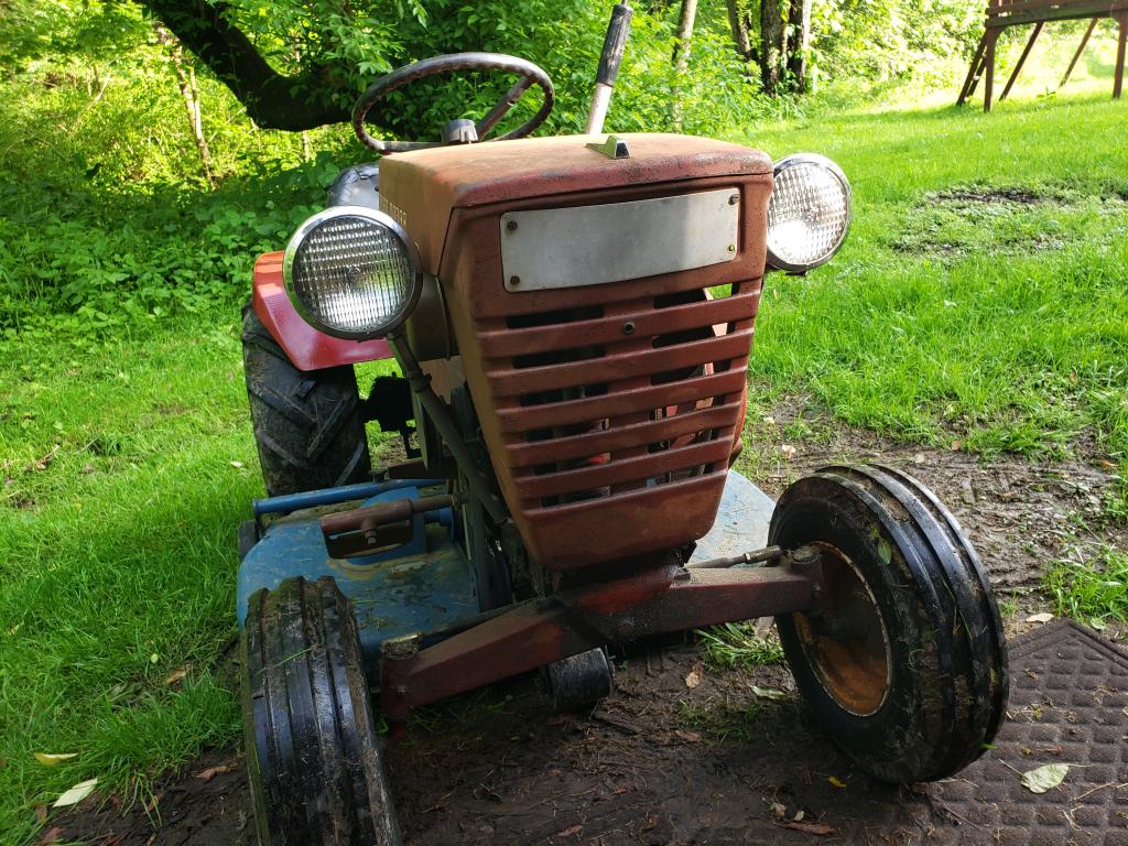

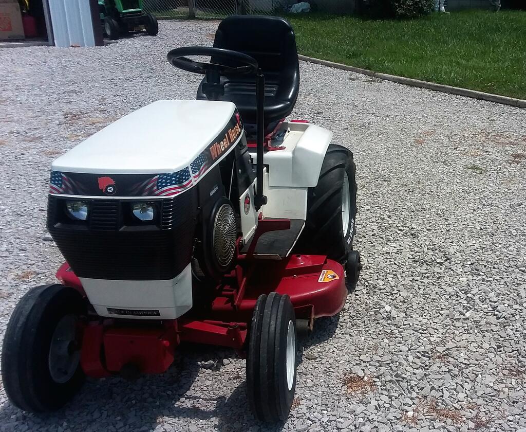

The Tuul Crib 7,354 #9 Posted September 15, 2019 Here's my set on the front of my 1067. There's a 4" x 8" rims with tubes. These don't have any bulge to them . 1 1 Share this post Link to post Share on other sites

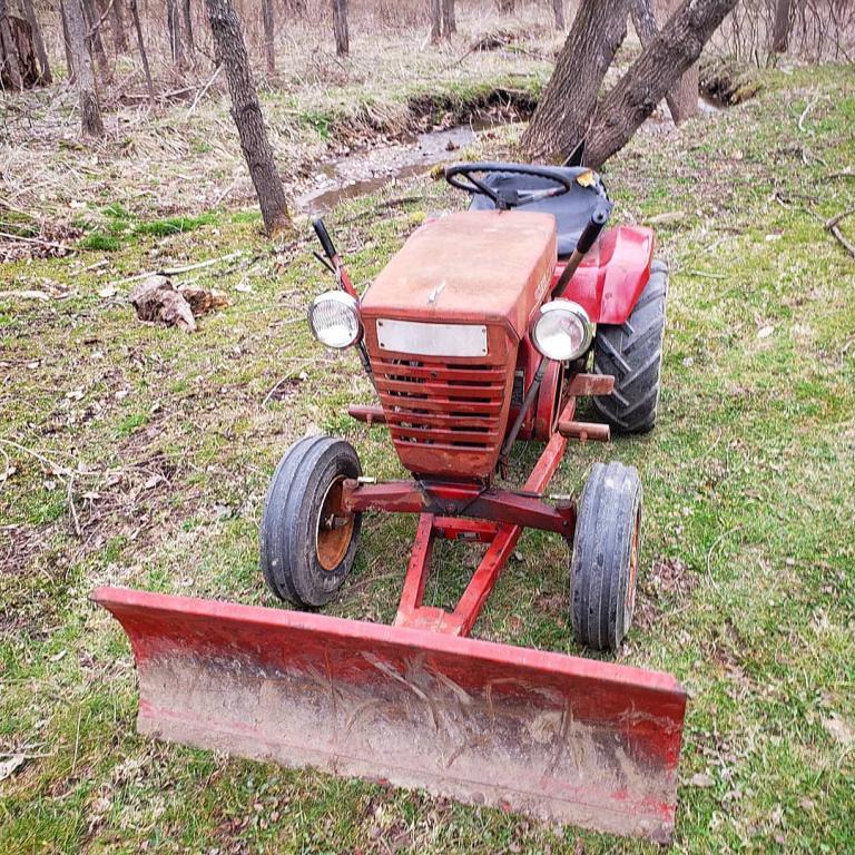

Gordyhogg 150 #12 Posted December 16, 2019 (edited) Heres my deestone tri ribs on my commando 8 i love em and they look great, perform great, and the price was unbeatable. They are also 4.00 x 8 Edited December 16, 2019 by Gordyhogg 4 Share this post Link to post Share on other sites

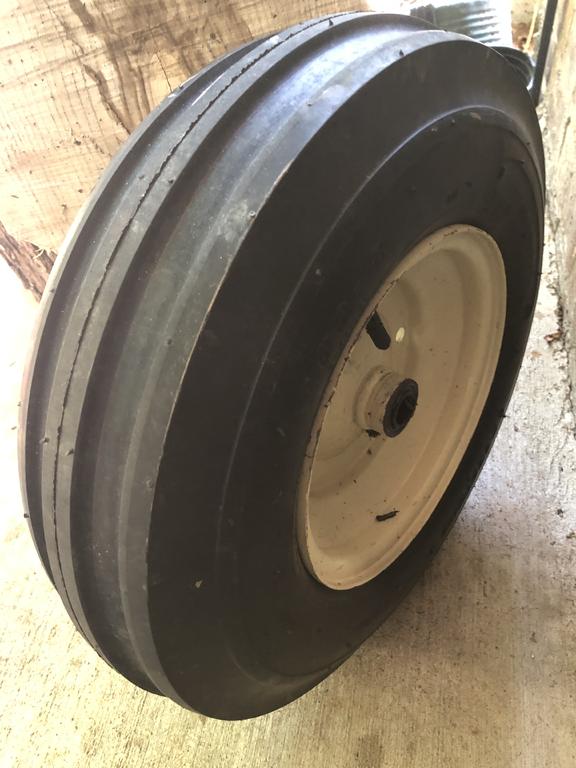

123Go 6 #13 Posted March 30 (edited) Well' better late than never I'm told..lol I hope this helps someone in the future. My 414-8 fronts are Deestone Easy Steer Tri-Ribs (4x8). Wheel Horse GT rims I think?? Sorry I bought my rims off EBay yrs ago. If you look for narrow rims you might watch out for wheels with the steel center caps (tapered bearings). I have two sets, they're 8" rims & like 3 1/4" & 3 1/2" width bead to bead. Other members here might know other narrow sizes & tractors they came on, idk? Most front rims are 4" to 5" wide though. I prefer the WH rims with tapered bearing like older Cars/Trucks, Campers, Boat trailers etc.. The center axle hole size can be changed out via bearing size if one chooses, so it could fit 3/4, 1/2 axle dia if needed? Smoother rolling wheels & their center hole dont wear out & wobble like a non bearing wheel with age, just the bearing will so its a cheap fix. Tapered bearings are tougher than a reg ball bearing setup, its built for highway speed, higher heat & pothole abuse. Just saying. If you find them grab them. Fyi- Deestone Easy Steers high center rib raises your tire up on the harder surfaces so a tractor turns one handed. But in mud/soft dirt the ribs sink in so the tire grips instead of sliding across the top of the soil. My Rears are Carlisle Super Lug 23x9.50x12 or so I think? Not near it to see, never been off so idk actual Rim Width? I traced the letters with a white Paint marker so don't go searching for white letter Super Lugs. lol I put bolts though the back side of my hubs & use (chrome) Lug nuts on front side. Much easier to install my wheels, its like fitting car rims on the rear now. Hope this helps, sorry long! Edited March 30 by 123Go 4 1 Share this post Link to post Share on other sites
