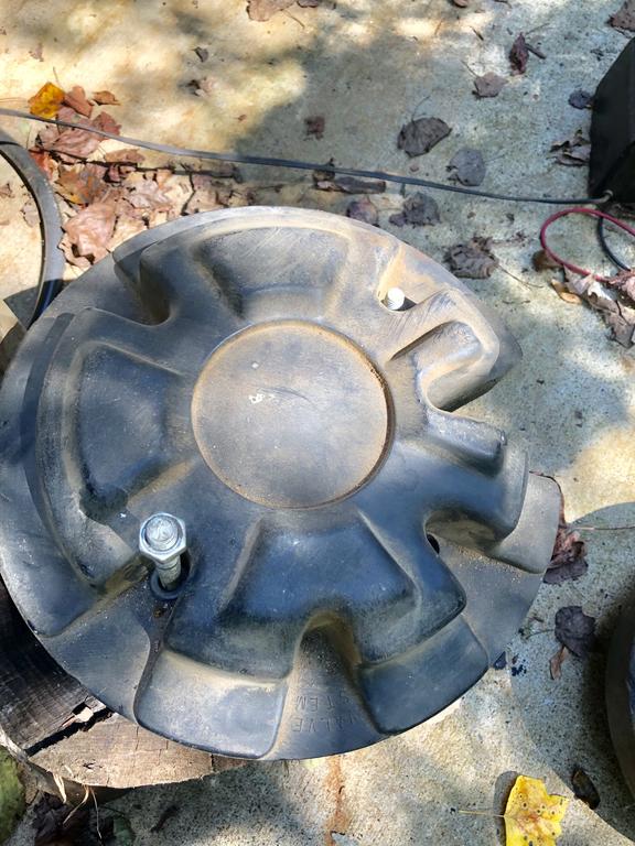

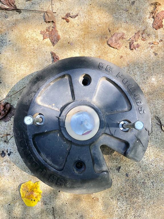

The Tuul Crib 7,332 #1 Posted September 14, 2019 Just pick these up this morning and I was wondering if anybody has ever seen these anywhere else before? They will fit the 12 inch wheels but not sure what branded they would put them on .They weigh 55 each. Paid. 50 for em 1 Share this post Link to post Share on other sites
AMC RULES 36,945 #2 Posted September 14, 2019 (edited) Pretty sure Terry has some center decals on his site that would make 'em specific. Edited September 14, 2019 by AMC RULES 1 Share this post Link to post Share on other sites
The Tuul Crib 7,332 #3 Posted September 14, 2019 2 minutes ago, AMC RULES said: Pretty sure Terry has some center decals on his site that would make 'em specific. Yeah that's kind of what I was thinking paint em black and put on some new decals! Share this post Link to post Share on other sites
formariz 11,849 #4 Posted September 14, 2019 I have identical ones branded Craftsman. Share this post Link to post Share on other sites
The Tuul Crib 7,332 #5 Posted September 14, 2019 1 hour ago, formariz said: I have identical ones branded Craftsman. Havent found a crapsman name anywhere None the same they'll work ! Share this post Link to post Share on other sites

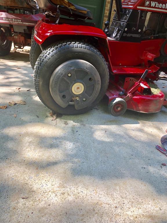

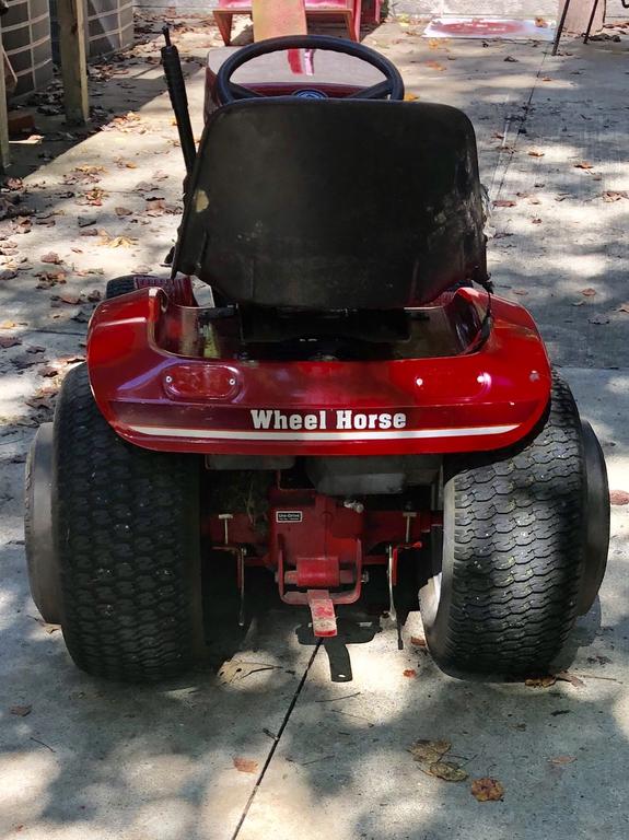

The Tuul Crib 7,332 #6 Posted September 14, 2019 Just got done putting them on fit like a charm! Sure does make it ride a whole lot smoother ! 1 Share this post Link to post Share on other sites

formariz 11,849 #8 Posted September 15, 2019 I have a few sets of those weights. I have front ones also. The one thing to watch out for is if casing is ruptured and water goes inside. In Winter it will freeze and eventually crack plastic outer shell from expansion. Its very easy to damage them due to the fact that they stick out so much. Look for any way that water can go in and seal that area with silicone. 1 Share this post Link to post Share on other sites
