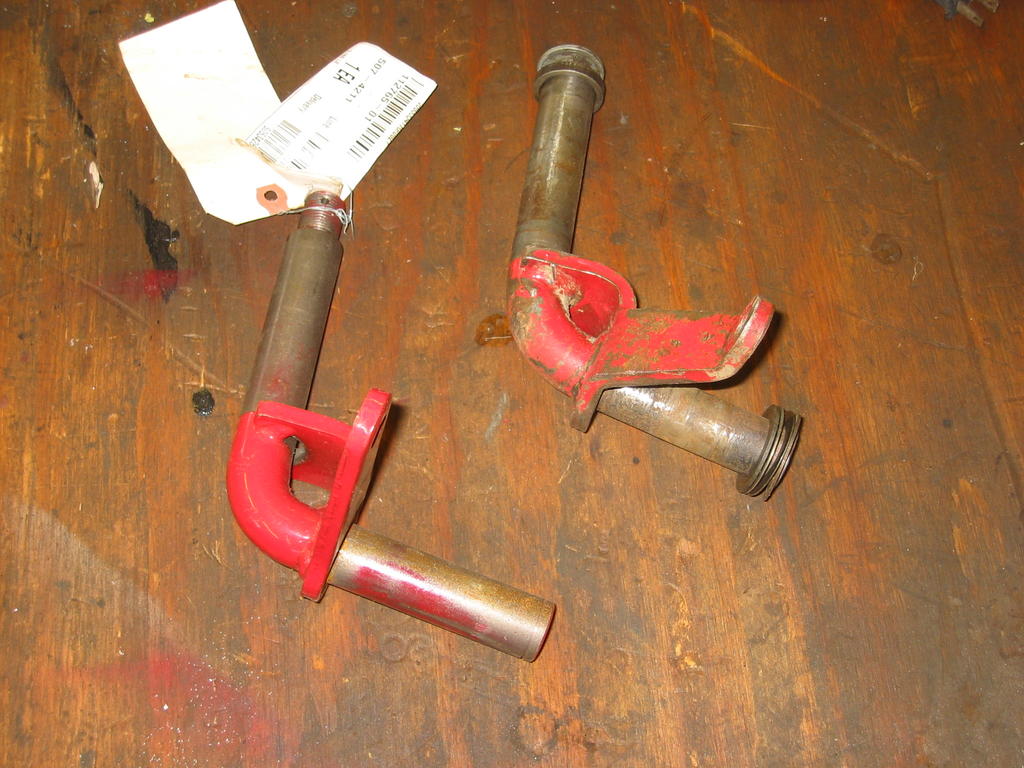

HOOCHIECOO 0 #1 Posted September 14, 2019 (edited) HEY ALL, NEW TO THE FORUMS BUT I OWN 3 D200'S. I AM LOOKING INTO OVERHAULING MY FRONT END AND WANTED TO KNOW IF THE 1" SPINDLES OUT OF A 520H WOULD FIT INTO THE D SERIES 1" BORE AXLES? I WOULD LIKE A DROP IN ALTERNATIVE FOR TRAILER HUB CONVERSION. THE 520 SPINDLES USE A CASTLE NUT AND COTTER PIN ON THE SPINDLE WHICH WOULD BE IDEAL. IF THEY WONT WORK I CAN JUST WELD ON TRAILER AXLE SPINDLES, BUT WANTED TO RESEARCH MY OPTIONS. THANKS IN ADVANCE FOR ANY HELP. Edited September 14, 2019 by HOOCHIECOO Share this post Link to post Share on other sites

pfrederi 20,688 #3 Posted September 14, 2019 (edited) Spindles for 520 and D series are very different not interchangeable 520 on the left D right Several threads on here about putting trailer hubs on the D's spindles. Edited September 14, 2019 by pfrederi Share this post Link to post Share on other sites
