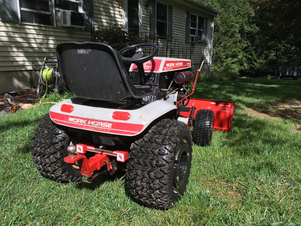

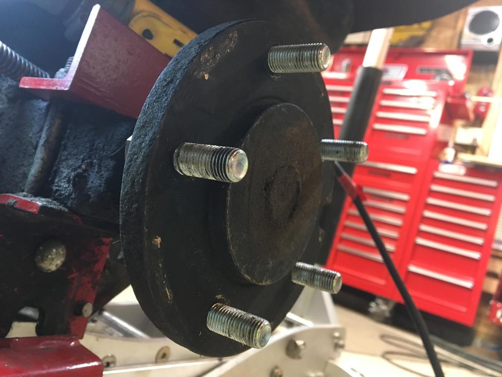

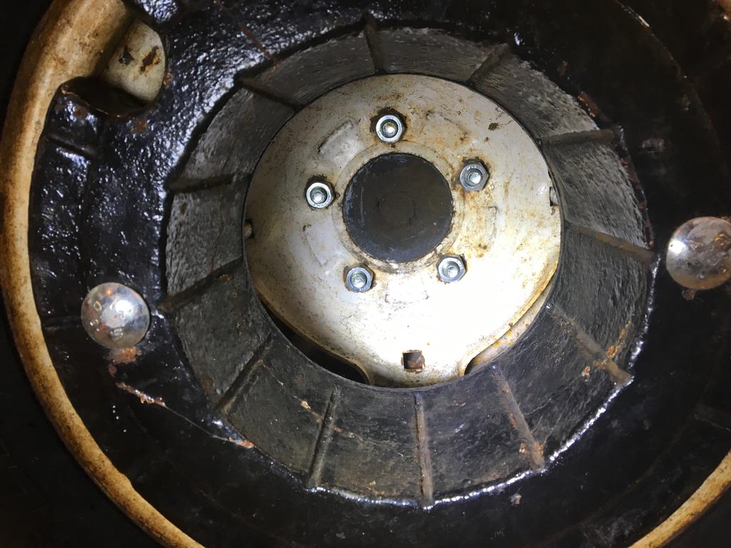

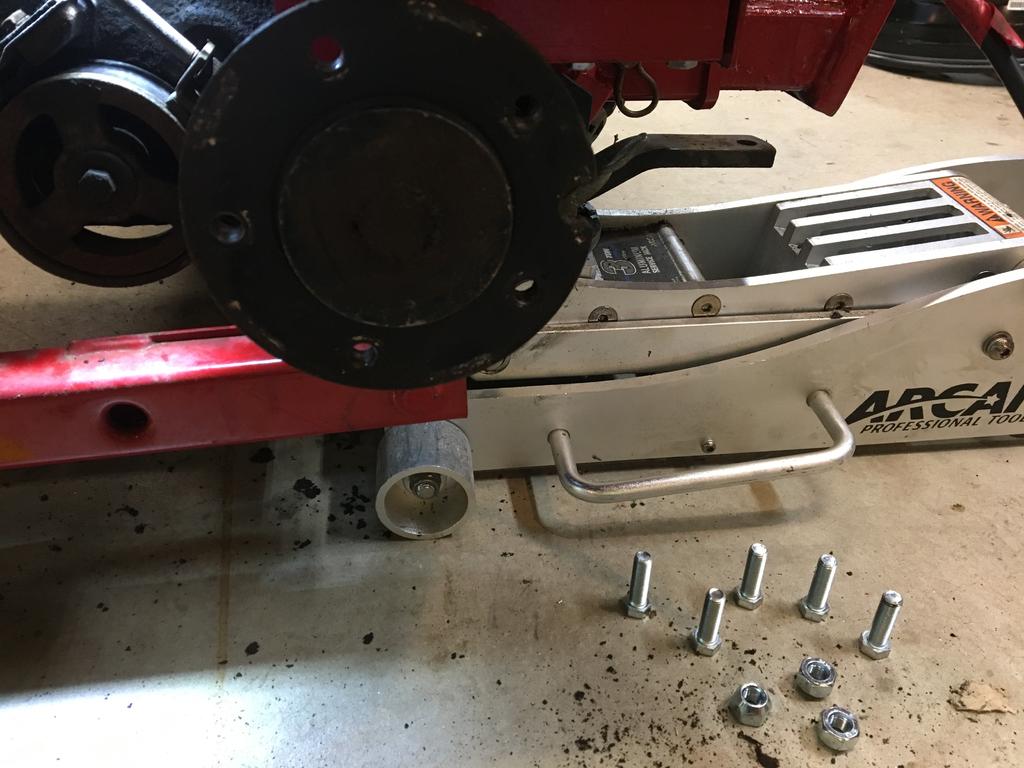

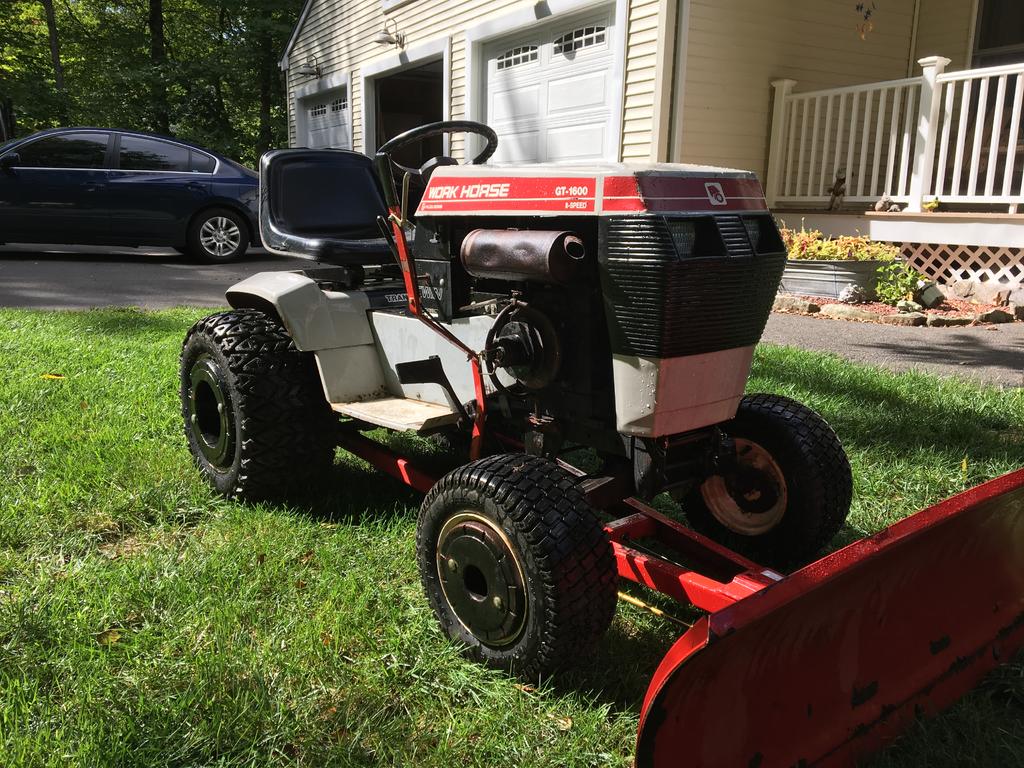

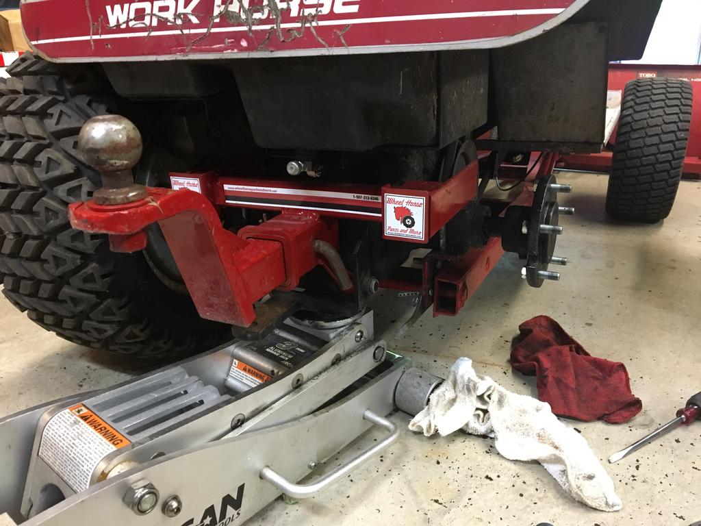

Sparky-(Admin) 24,892 #1 Posted September 13, 2019 With my Gt1600 in the garage getting new brakes it seemed like the perfect time to install the stud kit I bought off Bob @rmaynard a couple years back. Checked the hub set screws while I was in there. This is a dedicated plow machine so it gets worked hard. I decided to leave my inner and outer weights on (call me lazy), it’s still a chore to get em mounted but for sure it’s easier than using the old style lug bolts. She just needs an oil change and she’ll be ready for winter. Definitely not a “pretty tractor” but it’s so dang dependable, she earned a bath with soap and all 12 4 2 Share this post Link to post Share on other sites

ebinmaine 78,033 #3 Posted September 13, 2019 9 minutes ago, Sparky said: decided to leave my inner and outer weights on (call me lazy), I've told many people over the years... There's a fine line between laziness and efficiency. And I ride right on that line..... I think wheel studs on these may very well be the Best Modification anybody can do to a Wheelhorse. 4 1 1 Share this post Link to post Share on other sites

Sparky-(Admin) 24,892 #6 Posted September 13, 2019 53 minutes ago, ebinmaine said: There's a fine line between laziness and efficiency. And I ride right on that line..... I considered removing the weights, but instead of using separate bolts for the inside and outside weights I just used real long bolts and bolted em all on as one. It’s a real pain to get it all lined up and bolted together. These rears haven’t been off in a few years so it’s not often I find myself having to do this. I did set up my sons new WH with inside weights held on with their own bolts. 4 Share this post Link to post Share on other sites
squonk 45,935 #7 Posted September 13, 2019 An easy way to R & R wheels with weights or weighted wheels or both: Go to HF and get one of those dollies to move cars with. Jack up the tractor enough to get the dollie under the tire. Unbolt the wheel and roll it out and visey versey to re-install. 8 1 Share this post Link to post Share on other sites
Sparky-(Admin) 24,892 #8 Posted September 13, 2019 Just now, squonk said: An easy way to R & R wheels with weights or weighted wheels or both: Go to HF and get one of those dollies to move cars with. Jack up the tractor enough to get the dollie under the tire. Unbolt the wheel and roll it out and visey versey to re-install. That’s a real good idea! 2 Share this post Link to post Share on other sites
