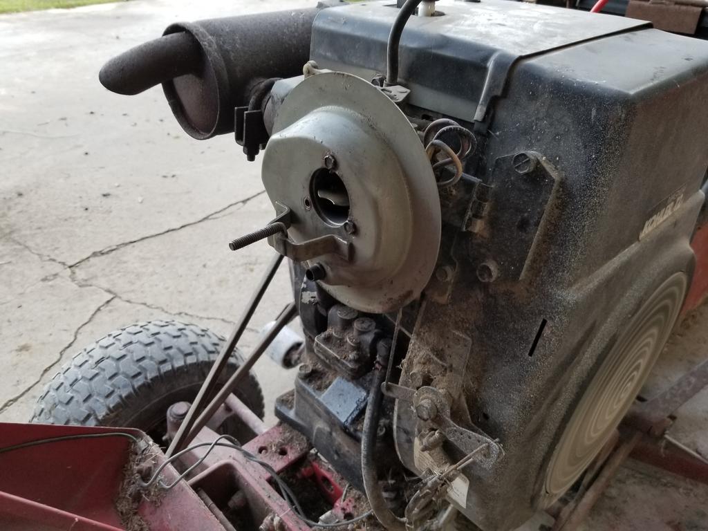

Larry B 6 #10 Posted September 12, 2019 This is what I'm working with. 1 Share this post Link to post Share on other sites
gwest_ca-(File Mod) 12,489 #11 Posted September 12, 2019 Your spec number uses all the parts with orange circles around the item numbers. You are missing one #8 screw also. Garry 1 Share this post Link to post Share on other sites
Larry B 6 #12 Posted September 12, 2019 Garry, Would it be the set with the big plastic cover, 3rd set down on the diagram down? Share this post Link to post Share on other sites
gwest_ca-(File Mod) 12,489 #13 Posted September 12, 2019 I would say so. That is what is on mine. Garry 1 Share this post Link to post Share on other sites

oliver2-44 11,758 #15 Posted September 12, 2019 The 312-8 is a great all around tractor, it can do it all. I restored one for my son a few years ago. Give that horse a good bath top to bottom and maintenance service. A few tips: When you drain the transmission oil lift/jack up the front of the tractor several inches so the oil drains over the hump in the bottom off the transmission. If the old oil is nasty brown or milky grey (water) you might fill the tranny with diesel, drive it around a little shifting through each gear, that drain & refill with 90w gear lube. while the front of the tractor is lifted up and the weight is off the front axle, grease the center pivit pin and other front end grease fittings. PS...Your teasing us with just that engine shot. 3 Share this post Link to post Share on other sites
