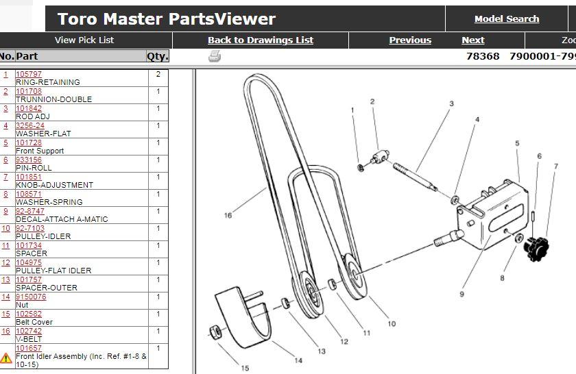

Where do you guys think I could find a deck belt (106") and tensioner pulley for my 46" deck off my 416-8?

The 416-8 would have either a 42 or 48" mower deck  (no 46" deck made)'...  (look at model # on deck).
IFor the MULE DRIVE belt # 102742 (94-2501) is the correct. (#16) for EITHER a 42 or 48" deck .
You can find the idler pulleys # 10 and 12 on Ebay for $45 bux or so.

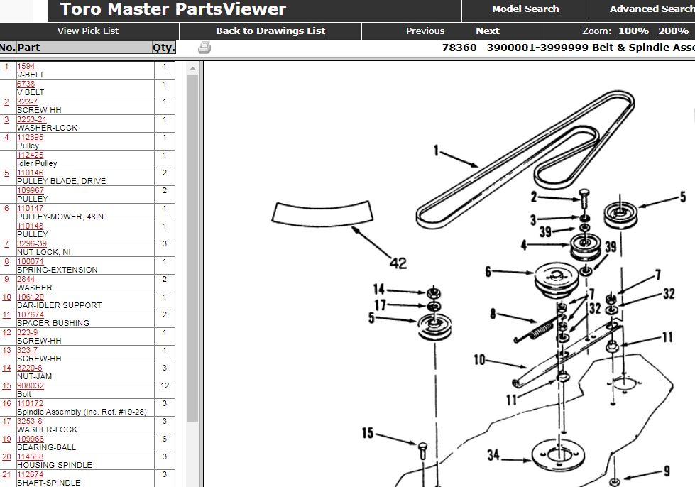

Second pic is of the DECK BELT...and tension hardware, part # list provided.
