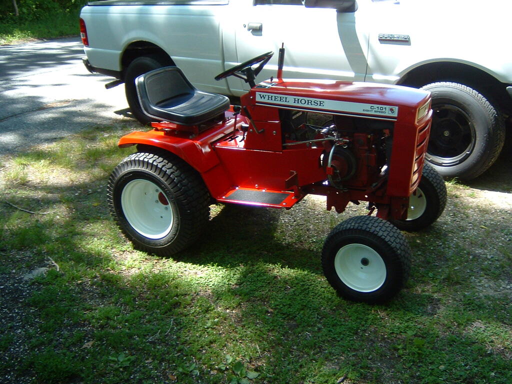

Dennis C. 142 #26 Posted September 28, 2019 Finally had a chance to wash and clean the C-101. I installed a new seat yesterday. Really doesn't need much. Choke and Throttle knobs are missing, brake pad needs replacing and the dip stick was cut short by the previous owner for some unknown reason. Not sure what I will do for paint. I used Rustoleum Farm and Implement spray paint on my last Horse. Went on nice and looked good but really needs to cure for a few weeks, even maybe a couple of months to be really hard. I sold the tractor before I had a chance to use it so I don't know how the paint would hold up to occasional use and UV exposure. Any suggestions? 2 2 Share this post Link to post Share on other sites

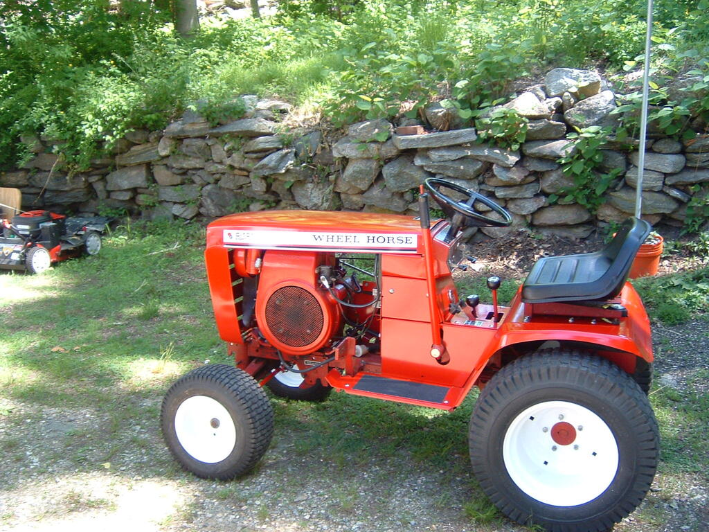

Dennis C. 142 #44 Posted June 3, 2020 Finally finished repainting. I started this winter. On to my Panzer next. 2 4 Share this post Link to post Share on other sites
tunahead72 2,662 #45 Posted June 3, 2020 Nice job Dennis! I'm curious about something... You mentioned you were going to replace the dipstick, was that for the engine oil or the transmission, and did you get that resolved? The reason I'm asking is that you want to make sure you have the correct one, in both places. Your engine, with the shaker plate, is only supposed to take 1-1/2 quarts of oil when you change it, you don't want to overfill. Share this post Link to post Share on other sites
Dennis C. 142 #46 Posted June 3, 2020 The engine dip stick is correct. I changed all the fluids just before I took the picture. I needed a new transmission dip stick as the previous owner cut it down to 6" in length. Not sure why he did that. A to Z Tractors fixed me up with the correct dip stick. Thanks for the compliment. Tractor sold in 2.5 hours on FB Marketplace. 1 1 Share this post Link to post Share on other sites
