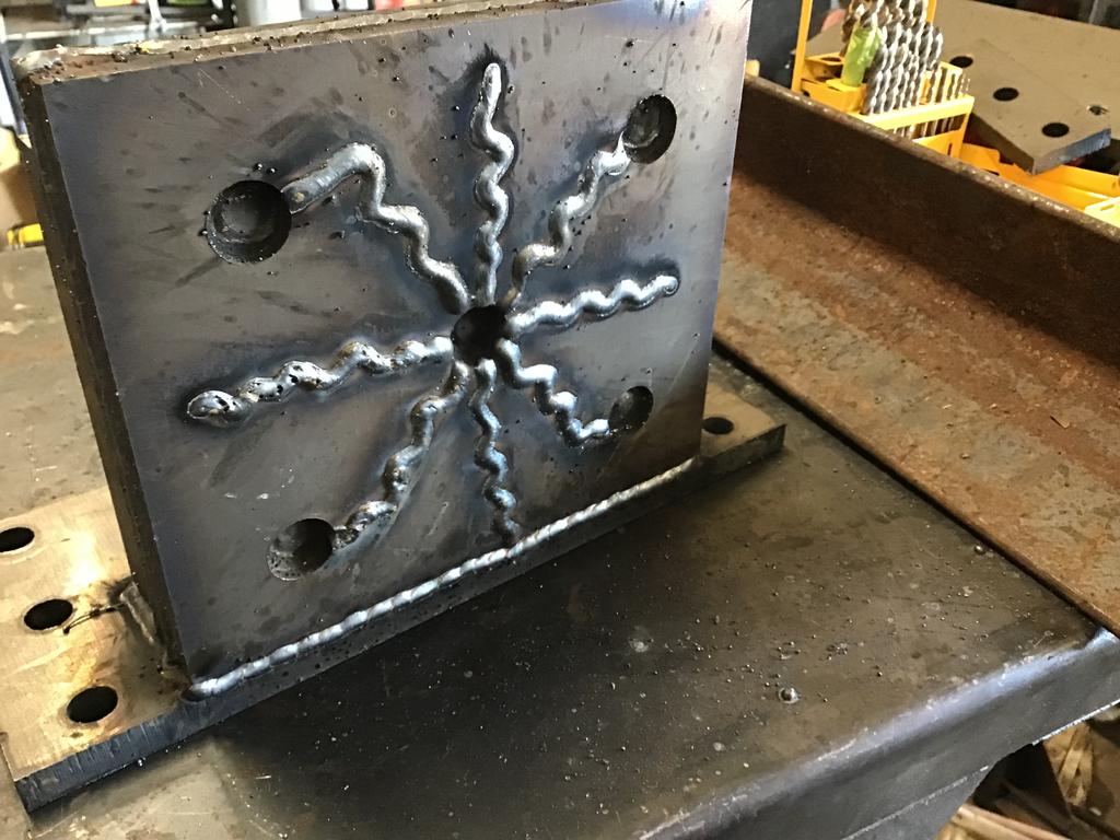

Pullstart 71,459 #26 Posted October 6, 2019 Welding is finished. That aughtta push a piece of wood! Share this post Link to post Share on other sites

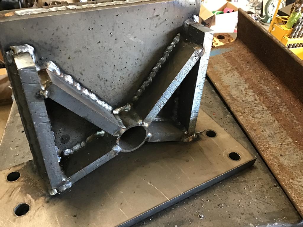

Pullstart 71,459 #27 Posted October 6, 2019 I’ll end up building a shield for the proximity switch.... but it functions! Now I’ll grab a big ole piece of oak and see if it’ll grunt through! 1 Share this post Link to post Share on other sites

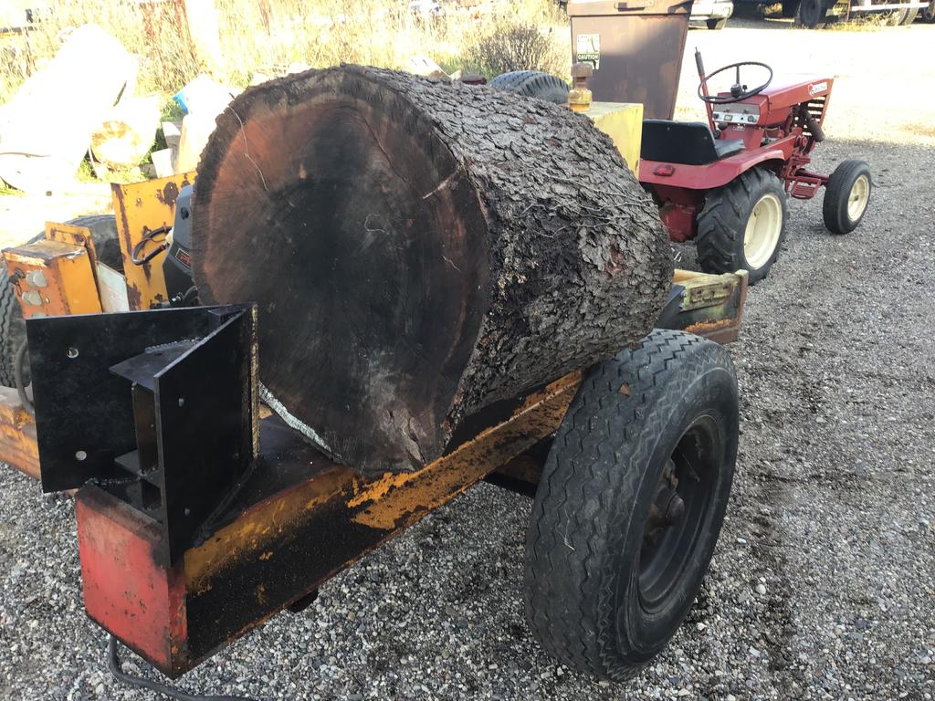

Pullstart 71,459 #28 Posted October 6, 2019 This was a narly piece of cherry and it made it through! Woo hoo! 1 Share this post Link to post Share on other sites
Tractorhead 9,218 #29 Posted October 7, 2019 I never doubt you made it. 👍 cool work Buddy. but for that picture i would suggest left and right set an improvement build as a triangle, to expand the forces a bit more to a bigger area, what was definitively given by the Metalplates. Ain’t doubt your weldings itself will last, but to split in Winter this sizes, when its frozen and temp. reaches the -10degC and deeper will be stressed the material much more, so a bit more safety i would suggesting. The free space give you the place for, even you have enough gap to the cylinder Share this post Link to post Share on other sites
Pullstart 71,459 #30 Posted October 7, 2019 In all honesty, I didn’t build to my plans. The back of the X brace was supposed to be the back of the slide plate too. For some reason I forgot about that until I finished welding it. I planned to have a log sit on the slider to give it some rake at the splitting wedge, to hopefully pierce the wood a little at a time. I lost about 3” of travel on the hydraulics this way too. But, I’m using what I had available to me or already in the shop, and it’s working for now. If it breaks, I’m out time, electricity and welding supplies. 1 Share this post Link to post Share on other sites
Tractorhead 9,218 #31 Posted October 7, 2019 The xbrace give you an improoved stability, that‘s for sure. 👍 i just mentioned. There was a huge force, if your plate go on Block, whilst a bigger branch was in the woods you’re cutting. 😉 Share this post Link to post Share on other sites
