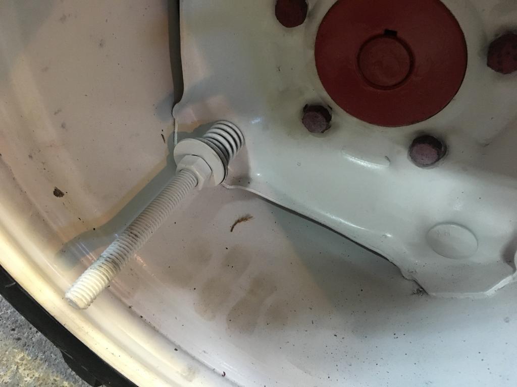

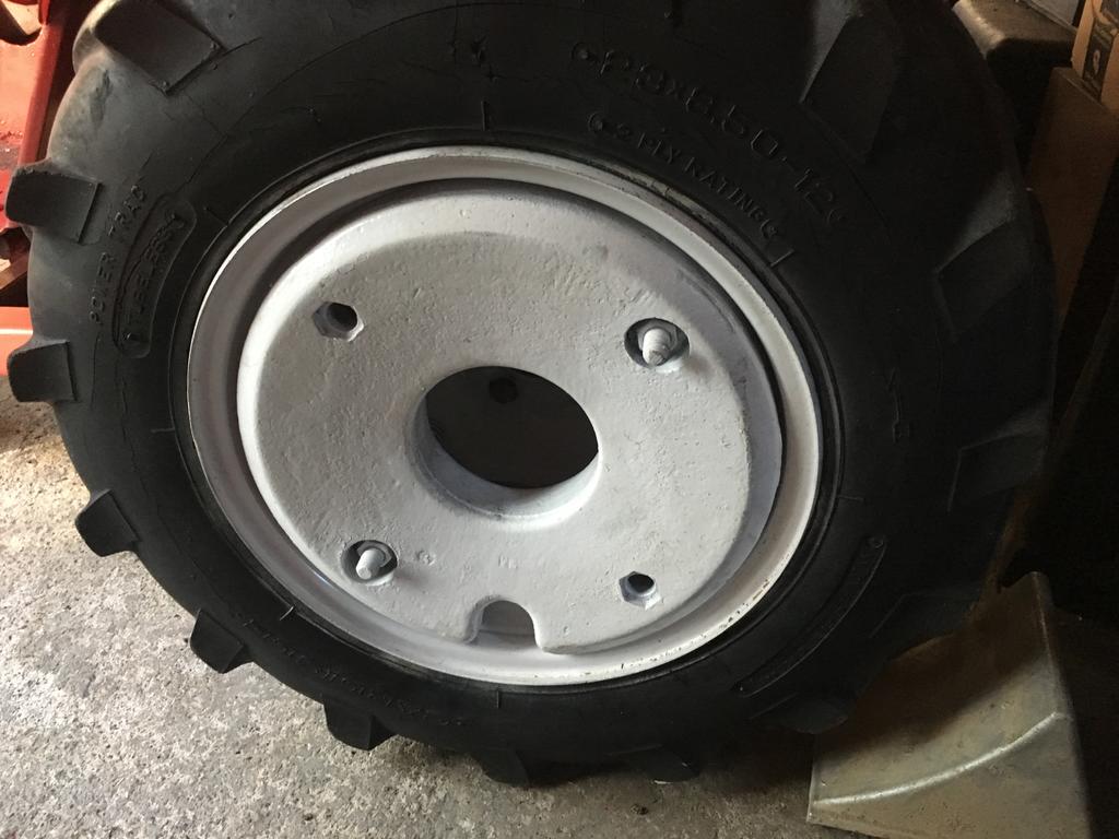

gwest_ca-(File Mod) 10,488 #13 Posted September 13, 2019 The wheels have a square hole that accepts a 1/2" carriage bolt to mount weights. I use lengths of 1/2" threaded rod in each square hole secured to the wheel with two nuts and a lock washer. After the wheel is back on the tractor slide the weight over the threaded rods and add flat washers and nuts. Garry Share this post Link to post Share on other sites
Burnerman 758 #14 Posted September 13, 2019 I did the same thing as Garry but I added some valve springs. It allows wiggle to make it easier to line up the bolts. I used long carriage bolts. 2 1 Share this post Link to post Share on other sites
