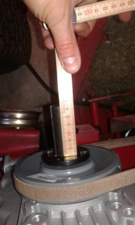

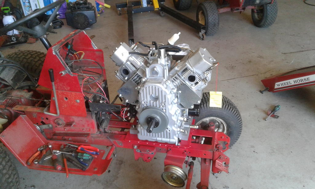

Vanl 4 #4 Posted September 9, 2019 I run a 4 inch Adjustable pully on a 16hp k series kohler . and a five inch Adjustable pully on a kohler 18hp vtwin ,with a adjustable slide motor mount . 1 Share this post Link to post Share on other sites

TonyToro 1,190 #8 Posted September 10, 2019 9 hours ago, Vanl said: I run a 4 inch Adjustable pully on a 16hp k series kohler . and a five inch Adjustable pully on a kohler 18hp vtwin ,with a adjustable slide motor mount . Yes That’s what I’m looking for! Please share where you get them. I need various sizes. Share this post Link to post Share on other sites

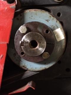

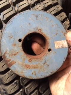

TonyToro 1,190 #10 Posted September 10, 2019 (edited) I was a little slow in replying but here is the pulley I saw. The brand is Maska. what sizes should I get? The guys suggested 4-0 4-1 4-4 4-5 4-6? But I don’t know what that means? Lol Edited September 10, 2019 by TonyToro Share this post Link to post Share on other sites

TonyToro 1,190 #12 Posted September 10, 2019 @Vanl I just reread your post and noticed you said adjustable motor mount. A guy in the club is a machinist and said he could make me a adjustable motor mount. This way I would only need one belt size for all the pulleys. Do you have a source for motor mounts? Share this post Link to post Share on other sites
TonyToro 1,190 #13 Posted September 10, 2019 1 minute ago, 953 nut said: Take a look at Grainger. https://www.grainger.com/search?searchBar=true&searchQuery=bushed+pulley Thank you! I just found them on grainier. I’m on page 110. Now I need to figure out this pitch and diameter. I’m guessing those numbers they gave me is equivalent to outside diameter of the pulley. 1 Share this post Link to post Share on other sites
Vanl 4 #14 Posted September 10, 2019 15 hours ago, TonyToro said: @Vanl I just reread your post and noticed you said adjustable motor mount. A guy in the club is a machinist and said he could make me a adjustable motor mount. This way I would only need one belt size for all the pulleys. Do you have a source for motor mounts? As with most pulling parts for wheel Horse . they are just home made . just piece of flat stock steel mounted motor solid and made slots in steel and bolted to the holes allready in the wheel horse frame . like you say you can use same belt just slide motor to make belt tension work > 1 Share this post Link to post Share on other sites
