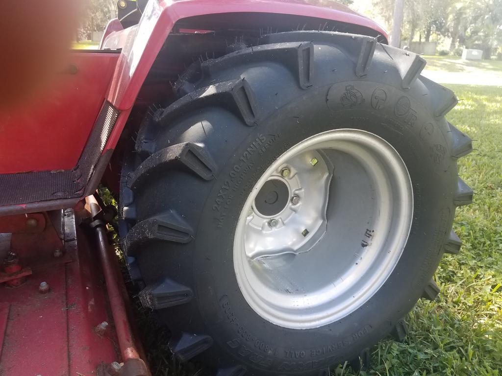

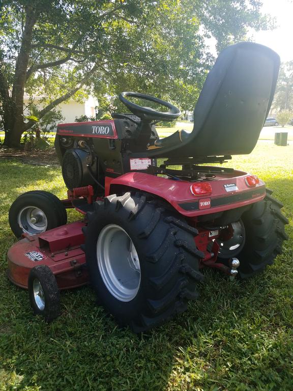

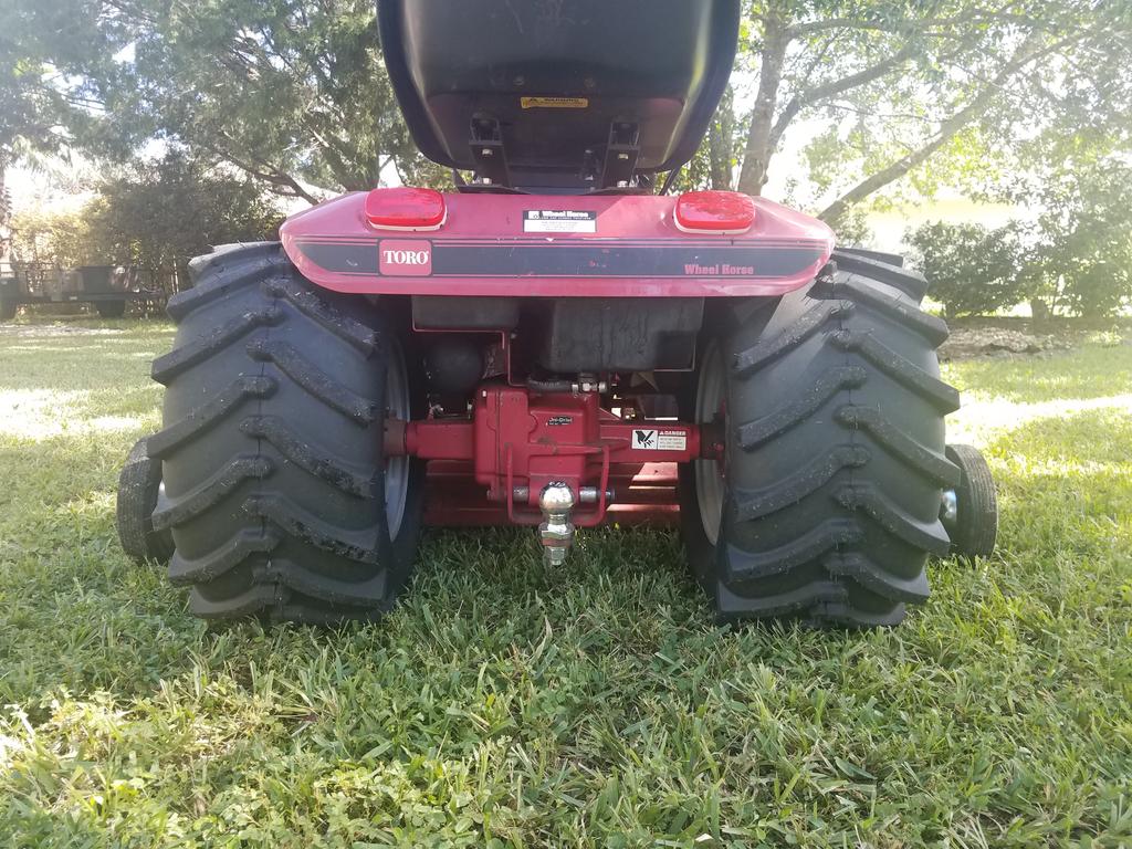

trailhopper 50 #6 Posted September 28, 2019 Just an update, I put the OTR Lawn Trac 24x12.00-12 rear tires on my 520H and they fit pretty good. they measure right at 23" diameter on the 8.5" 520h rims with 10psi in them. To be as accurate as possible, I use a level when I measure from the top of the tire to the garage floor. I also changed the front tires to the Vredestein V61 tire in the 170/60-8 (16x6.50-8) size. The V61's are right at 16" with 15psi on the factory 520H front rims. In an attempt to get the highest cut possible from the 60" deck, I also replaced the 8" deck wheels with some 10" deck wheels from Harbor Freight (https://www.harborfreight.com/10-inch-x-2-1-2-half-inch-solid-rubber-tire-35459.html). In the end I got what I was trying to achieve: a 4" cut from the 60" deck (measured at the chute with the blade perpendicular to the tractor frame). If not using the 60" deck, I would have used an 18x8.00 front tire. As it is, the front tires are about an inch away from the leading edge of the 60" deck. The 24" rear tires may rub the deck during extreme articulation of the deck, but for a relatively smooth yard it should't be a problem. If using a 48" deck, I'm certain the tires would rub on the height adjustment sector on the deck. Not perfect but I'm happy and out of ideas without fabricating. -Scott 6 4 Share this post Link to post Share on other sites
AMC RULES 37,260 #7 Posted September 28, 2019 ...and it looks pretty damn good too. 1 Share this post Link to post Share on other sites
RandyLittrell 3,946 #8 Posted September 28, 2019 Those 24x12-12 OTR's look damn good!! Randy 1 Share this post Link to post Share on other sites
The Tuul Crib 7,354 #9 Posted September 28, 2019 2 minutes ago, RandyLittrell said: Those 24x12-12 OTR's look damn good!! Randy Share this post Link to post Share on other sites
trailhopper 50 #10 Posted September 29, 2019 Thanks guys! I think so too. Share this post Link to post Share on other sites
DadsPuller 36 #11 Posted September 29, 2019 That looks awesome! Share this post Link to post Share on other sites
