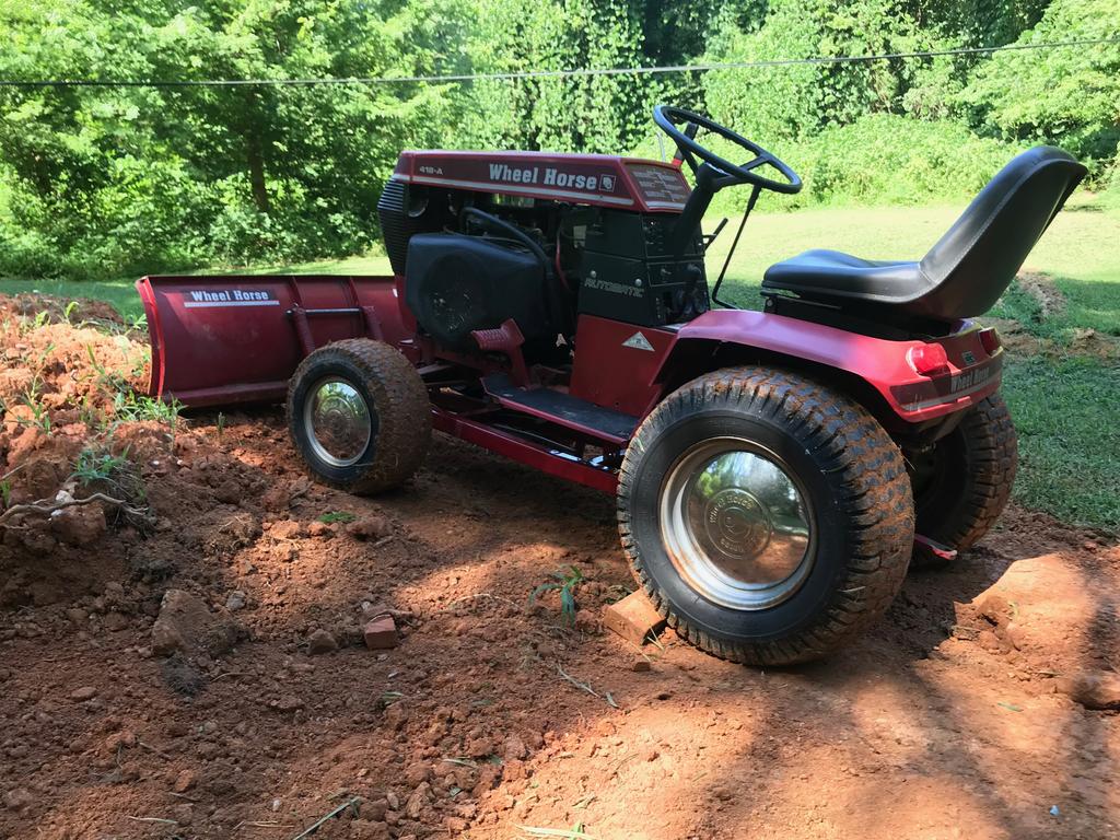

zeke37 24 #1 Posted September 7, 2019 Hello I have a 418 A that I purchased at the beginning of this mowing season that has just developed a problem with the starter not engaging, just a whirring sound. After a while it will engage and the motor will fire right up. Am I looking at a problem with the flywheel and if so how much of a job is that? Tractor has 810 hours on it Thanks Tim Share this post Link to post Share on other sites

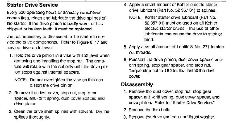

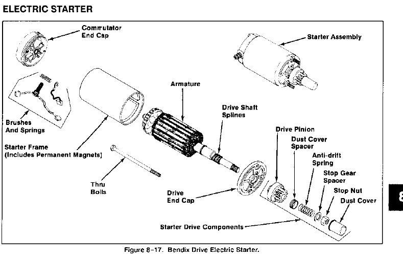

oliver2-44 11,401 #2 Posted September 7, 2019 (edited) It sounds like the starter bendix (gear part is not throwing out to engage the flywheel. These get gunked up and can just need cleaning. If you can slip the straw on a WD40 can (or your favorite spray penetrate) through the sheet metal at the top of the starter where it contact the flywheel. Hit the starter a couple of time and spray each time. If this (temporarily) helps the problem, you probable need to pull the starter, clean the upper shaft and gear, then lube with dry graphite. The starter shaft actually should not have any oily lube on it, but this little easy test will help you figure out whats going on. if you haven't already, this winter it might be time to pull the sheet metal and give the engine and top of the transmission a good cleaning. Edited September 7, 2019 by oliver2-44 2 Share this post Link to post Share on other sites
daveoman1966 3,882 #3 Posted September 7, 2019 The whirring sound is just the starter motor running by itself, not engaging the BENDIX...or a bad bendix spring preventing engaging the flywheel. More than likely, broken bendix spring or just all gummed up and dirty. Take the strter off and clean it up...matybe install new bushes while you're at it. The bendix will also need a good cleaning and spring replacement. Dont lube the bendix spring...that makes it a dust magnet. 1 Share this post Link to post Share on other sites

pfrederi 20,273 #6 Posted September 7, 2019 When you go to pull the starter be careful. in the KT and Magnum Twins the bolts that hold the starter on also hold it together. Make sure you hold the end caps in place. I use tape. 2 Share this post Link to post Share on other sites
