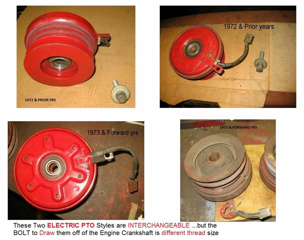

daveoman1966 3,883 #6 Posted September 6, 2019 Here is a pic of the two types of Electric PTO for use on horizontal shaft engines with either a 1" or 1 1/8" crankshaft. 1 1 Share this post Link to post Share on other sites

keitholdcar 17 #9 Posted September 7, 2019 Thanks for the answers,I am going to have to see if my friend raised the serial and model numbers on the 14 automatic tractor.I would like to find the year of it.I think it got narrowed down by the pictures of the clutches.Mine have the raised ribs on the outside,not that flat plate so that makes it 73 and up.I know my 12 automatic is a 73,it was bought new in 73,and has all the paperwork from the sale,and has always been here since new.My only pictures of it are polaroids,so I will try to get some pictures taken with a real camera.The 73 was bought new to maintain the lawn of an old farm,(the land I'm on)and has always been inside.It has had nothing but Shell Rotella 15-40 oil in it,and was always started at an idle,never with the throttle raced up.It has always idled before shutting off too.The tractor had a Hobbs hour meter put on when new,and just hit 2900 hours this summer.The engine has never been apart,and is starting to use a little oil now. 1 Share this post Link to post Share on other sites
